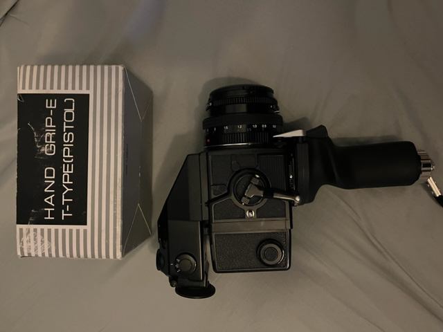

Genuine Bronica. Ignore the description of this ebay listing--this is actually the Bronica Hand Grip E for ETRS:
Mine had the original box and it says: Hand Grip-E T-Type (Pistol)
It fits the ETRSi perfectly, and doesn't fit the SQ-A or GS-1 I have. In the next few days I can dig it out a snap a picture mounted on the camera.
(the ones intended for the EC-TL have two triggers--one for the shutter and one for the stop-down/meter read.)
