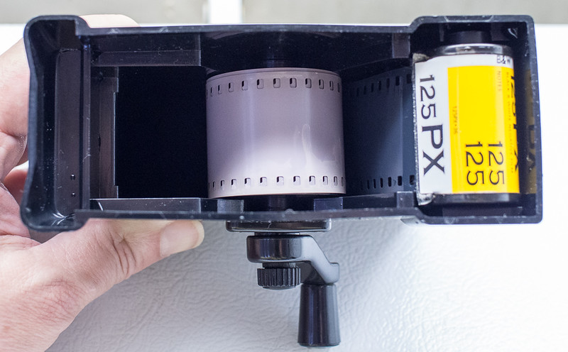

It works fine and is ridiculously simple. sit the film cassette in a compartment and attach the leader to the central axle. Put the lid on, pour in chemicals and turn the the handle. The film is drawn out of the cassette and wraps around the axle until it comes to a stop at the end of the film. Then turn the handle the other way and the film unwraps from the axle, and as you continue turning it then rewinds around the axle in the opposite direction. Just keep turning the handle one way till it stops, then turn the other way till it stops, and repeat till the time is up. Amazingly the film doesn't get scratched, and develops quite evenly. Here is a old trashed film showing how it winds onto the spool:

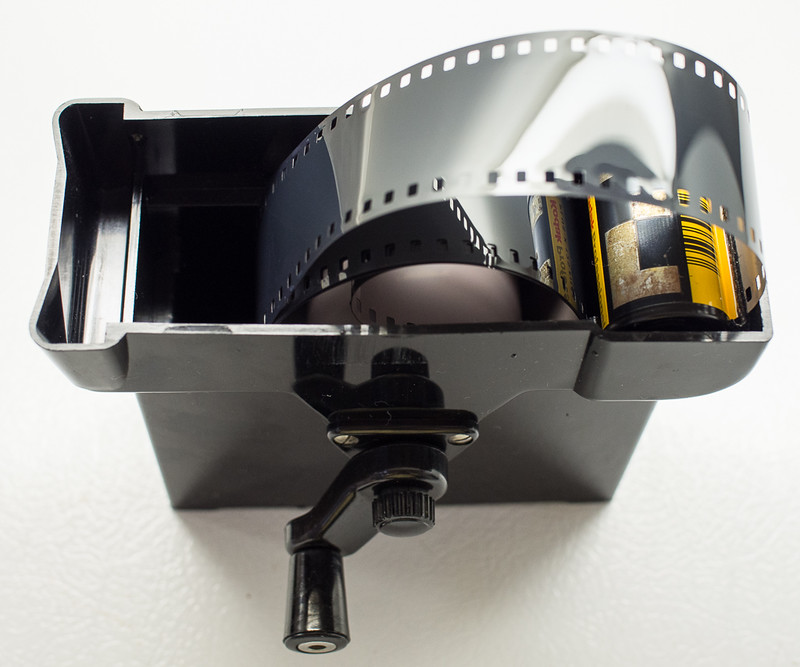

And how it unwraps with a change of rotational direction. Obviously in use the lid is on and the film is constrained as to how much it can open into loose coils:

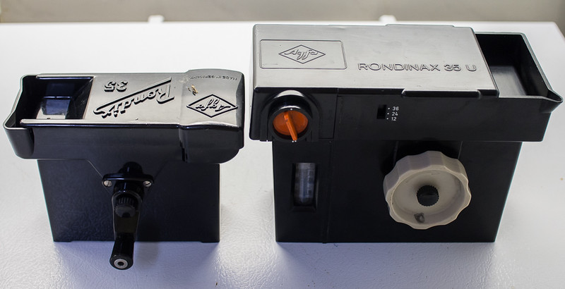

The lid lets you pour out one solution and then pour in the next just like a Rondinax. It's a much smaller tank though:
