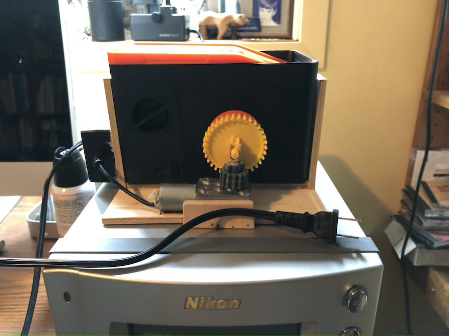

I've been using a 35u for years and haven't yet had any problems at all. Eventually I motorized it, and I'm now on my second motor as I wore out the plastic gears on the first from using it so much!
Ich bin sicher sowas oder sowas ähnliches wird es auch bald für die LabBox geben.
There already is:
I showed it to Ars Imago and the CEO replied "This is a very interesting project. I appreciate your work a lot. We are working on a motorised version too probably coming end of the year. We have some prototypes ready now and we are testing."
