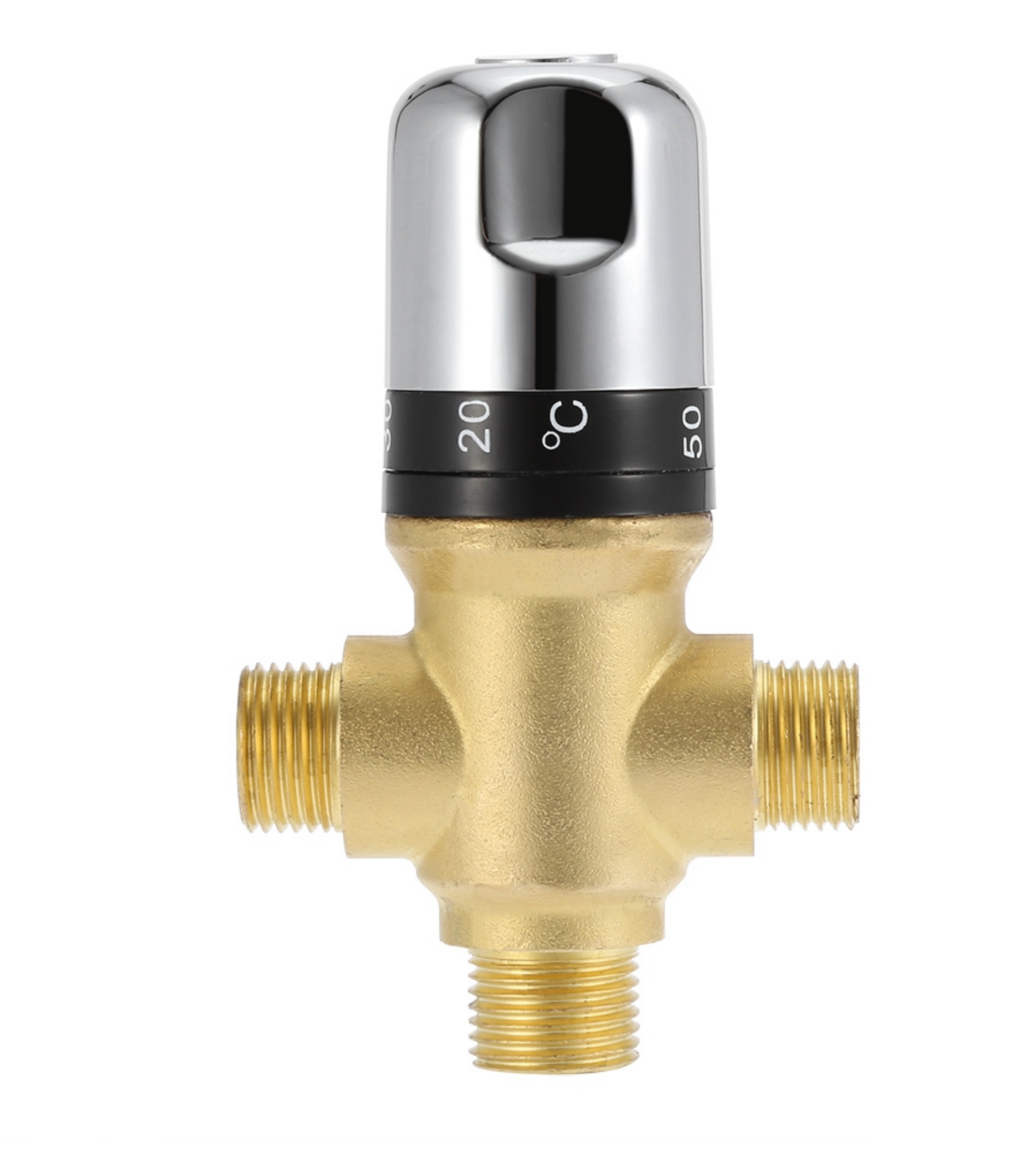

I use a thermostatic valve designed for a darkroom, but these $20USD units might also work. They go from 20C to 50C.
