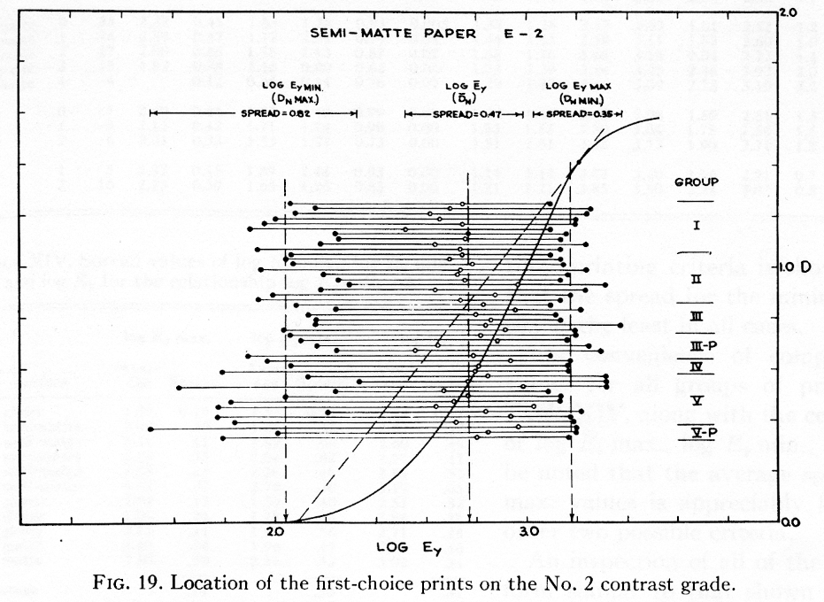

I think this example is good at illustrating the last two points. It shows the negative density ranges of prints that were judged as being of high quality laid over the characteristic curve of the paper they were printed on. While there is a certain pattern, there is no strict and precise rule.
It’s important to note, this is “the print”. White’s to the left.
I’ll make a remark: Some of the excellent prints throw out highlight detail.
