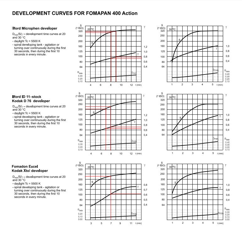

If you check the Foma data sheets for all 3 pan films, 100, 200, and 400, Foma posts times and curves for a variety of developers. . Foma 400 comes close to 400 with ILford Microphen, with Fomadon a bit slower but still close to box speed and D76?ID 11 200 to 250, Foma 200 is closes to box speed with most developers while 100 seems to exceed box speed with Mircophen and at box speed with others tested
Are you taking into account the fact that the datasheets show a range of G-bars? If you take 0.6 as an approximation of 'normal contrast', you'll find that the Foma 400 product really achieves 200-250. It's not close to 400 in any developer shown in the datasheet. It does peak out at around 320, but this is only for significantly higher contrast; i.e. essentially a push process scenario.
The 200-speed product reaches approx. 160 in 3 out of 4 developers listed, but interestingly for D76 no g-bar 0.6 rating is provided; extrapolating it would arrive at around 125.
Foma 100 reaches, at least according to the datasheet, 80-100.

According to the manufacturer's technical data sheet, it is evident that fomapan 400 ISO400 does not achieve. It's probably "best" in Microphen, where it reaches about ISO 320 with recommended processing.
I downloaded that from Foma yesterday and mixed up some ID-68 and am going to go out today and see what I get. I am also going to test Pan-F and HP5 at the same time.
