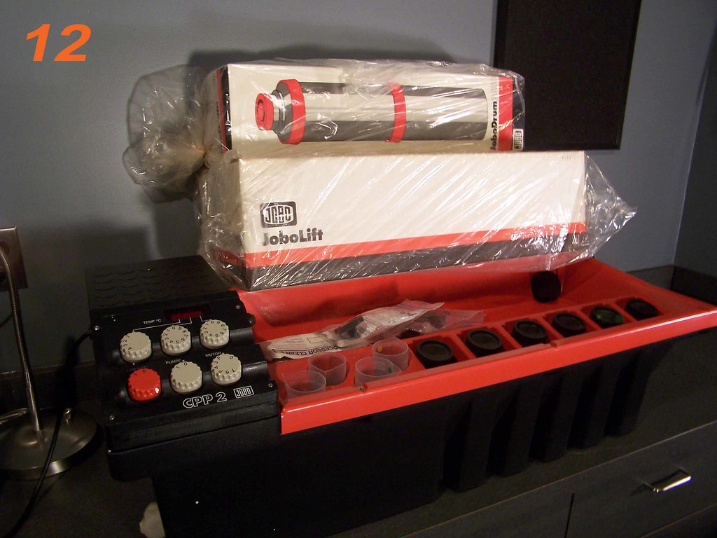

so bob,
why not just make a bigger, stronger version of a jobo CPP2 without the lift mechanism? and if you're using the cog heads in place of the magnetic bases(standard connection without lift), all you'd have to change is the connection to the motor. you could just have a motor control set to a set # of rotations, it would slow down, and reverse, all on its own. I'm thinking an electric, or why not just build it JUST like the Jobo, but with better quality parts, that are readily available off the shelf?
like this one, just double the length... and made of stainless steel

so bob,
