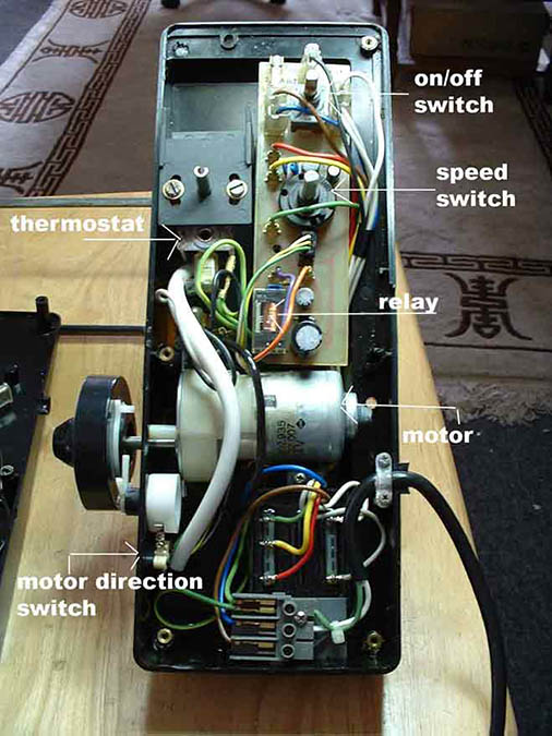

I repaired a Jobo processor a few years back but cannot remember the model.
It had quit reversing. The DC motor had the polarity to the motor reversed by a relay to change rotation direction.
After searching on line electronic retailers and not finding a replacement relay I opened the existing one, burnished the carbon build up from the contacts, and reassembled it. It worked fine.
There is nothing complicated in older Jobo processors, input goes to a step down transformer with 2 or 3 secondaries. Each secondary has a bridge rectifier, electrolytic capacitor filters, current regulator SCR or transistors for the display.
A DC motor of the same voltage and speed should not be too difficult to source. Nylon gears and cams may have to be 3D printed. Caps and resistors should be easy to source, transistors and other solid state devices might become hard to find as demand for them diminishes.

The motor in the CPE2 is a Mercedes head rest motor ( among other things ). I don't recall the model I bought one for. Found one used on Ebay, was an exact fit. I was also able to source the original. See if you can find a,
Bosch 0 390 206 692

Digging around last night I found it was a CPE-2 that I had worked on.
