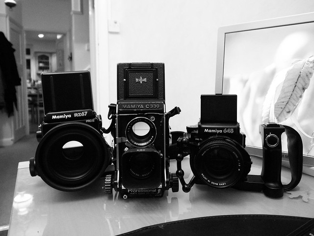

Is this the voice of experience or merely parroting what you heard. These are not that heavy, slightly more than Yashicas, but not nearly an RB67. My C-330 with 80/2.8 and metered Porro finder weighs 1.75 lbs loaded with 220 film. My OM-4 with 100-200 zoom is heavier and more unwieldy.
Experience:
R0114730 by ruby.monkey, on Flickr
It's a fine camera and the 105mm f/3.5 DS on it is a beautiful piece of glass, but it's still a hefty piece of kit.

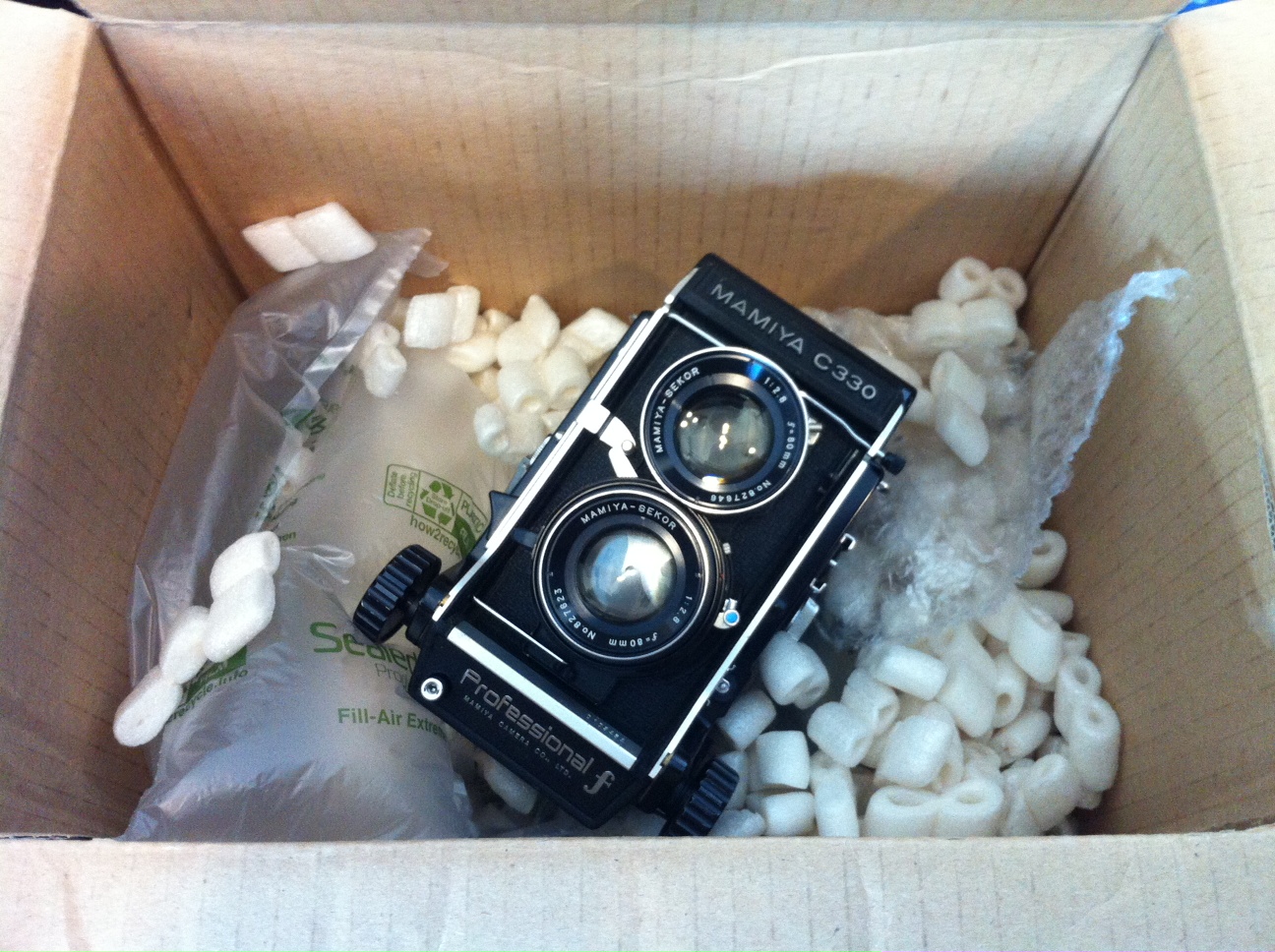

it arrived !!!
The camera arrived today.
attachment.php
First quick impression: some minor cosmetic issues (as mentioned), shutter seems okay, glass is clear. Nice to handle the camera, not too heavy. Foam beneath focus screen seems partial missing, but I'll wait till I'm home tonight before I take the camera apart.
So far I'm very pleased with the camera. Onward with reading the manual and testing the camera...
attachment.php
Snap, just the same as mine and mine looks just as good and I've had it for about thirty two years.
This is something you can replace yourself as long as you find the proper screwdrivers. And it's a MUST; you must do it to ensure proper focusing.
For the foam i used the rubber from a mouse pad, cut to the necessary dimensions. Worked perfectly.
Camera looks great, congratulations!
