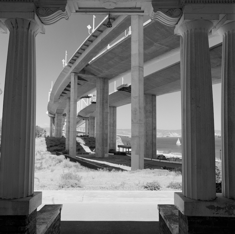

Or... I can re-shoot my old photos that could be improved by movements, like this one:

Movements -- especially swings and tilts -- accomplish something that can't be done with a fixed-geometry camera, even by cropping a wide angle image: they make the plane of sharp focus not parallel to the film plane.
If I shoot a landscape with my RB67 and include foreground, I'll have to compromise focus on either foreground or distant objects -- but if I frame the same shot (in the same aspect ratio!) with my Graphic View, I can use front tilt (or swing, in some cases) to put the plane of focus out in the world precisely where it's needed to keep the grass or reeds directly in front of the tripod and the mountain tops several miles away both in focus. And then I can use rise to include a main subject higher than my tripod position, without causing (for instance) tall trees to converge toward their tops, of if shooting down from a bridge, toward their bottoms. Combine the two, and I can control both perspective and focal plane all at once (providing there aren't objects that need to be in focus that are too far out of some plane that includes the other important objects -- then I have to just stop down more).
All of this, obviously, presupposes a lens with enough additional coverage beyond barely filling the corners of the frame -- but most normal or longer lenses don't have much problem here, and wider than normal lenses are usually subject to research to be sure they have the coverage you need (way, a 90 mm Angulon just covers 4x5, but a Super Angulon the same length has room for some movements).

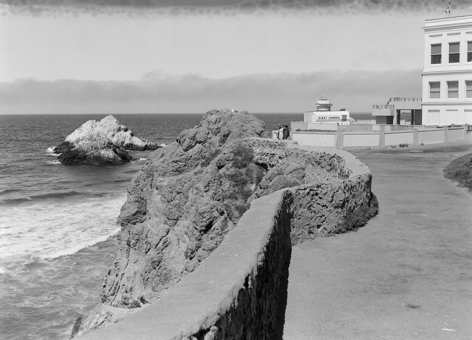

Well. I developed and scanned the negatives today. And here it is. My first 4x5 exposure:
It has everything:
  • Incomplete development at the top due to insufficient amount of developer in a JOBO tank
  • Scratches left by my repeated attempts at getting the sheet in and out of the holder
  • Black dust specks! My first. :smile: A new and exiting side of dust to be introduced to!
  • Fondest memories of inhaling my own t-shirt while trying to focus under it
  • Surprisingly, complete absence of my fingerprints!
Couldn't be happier!
The only slightly disappointing thing is that the resolution jump is quite modest vs 6x7 or 6x6. In terms of lp/mm my Hasselblad glass outperforms this Sironar-S.
In my experience the defect in the sky area is not due to insufficient amount of developer but due to the developer not reaching that area on a regular basis independent of its volume. If you look carefully the width of the band is the same size as the slot on the reel. I purchased both the 2520 and 2509n new and for about a year developed 6 sheets of 4x5 at a time by hand inversion which requires 1500mL of developer. Then I started getting the same band in the sky as in your image. I switched to rotary processing, which requires only 270mL of chemistry, and the band disappeared. I theorized that over time the PhotoFlo that I was using in the tank built-up on the slot and prevented an even flow of chemistry across the film in that area. The takeaway from that was to remove the sheets from the reel and use a small tray or waterproof index file for the PhotoFlo treatment. Rotary processing forces the chemistry through that area.

The curious part is that the band only appears on one edge of the film – the sky portion – while the opposite edge of the film, which is also in a slot, shows no such defect. If you load the film correctly with the emulsion facing inwards on the reel, the sky portion is threaded through the reel's clear plastic section and the foreground section through the black plastic section (I'm right-handed.) This implies that there is a difference between the clear and blackened plastic that accounts for the observed defect.
