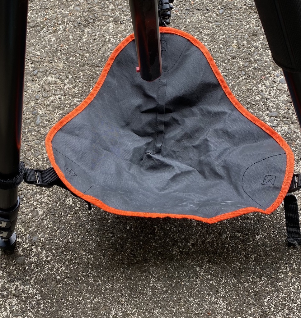

Some people will rig up some way to hang their camera bag or some other kind of bag from the tripod and add weight, even picking up stones around them to put in a bag for the purpose, to add some stability.
Like this?

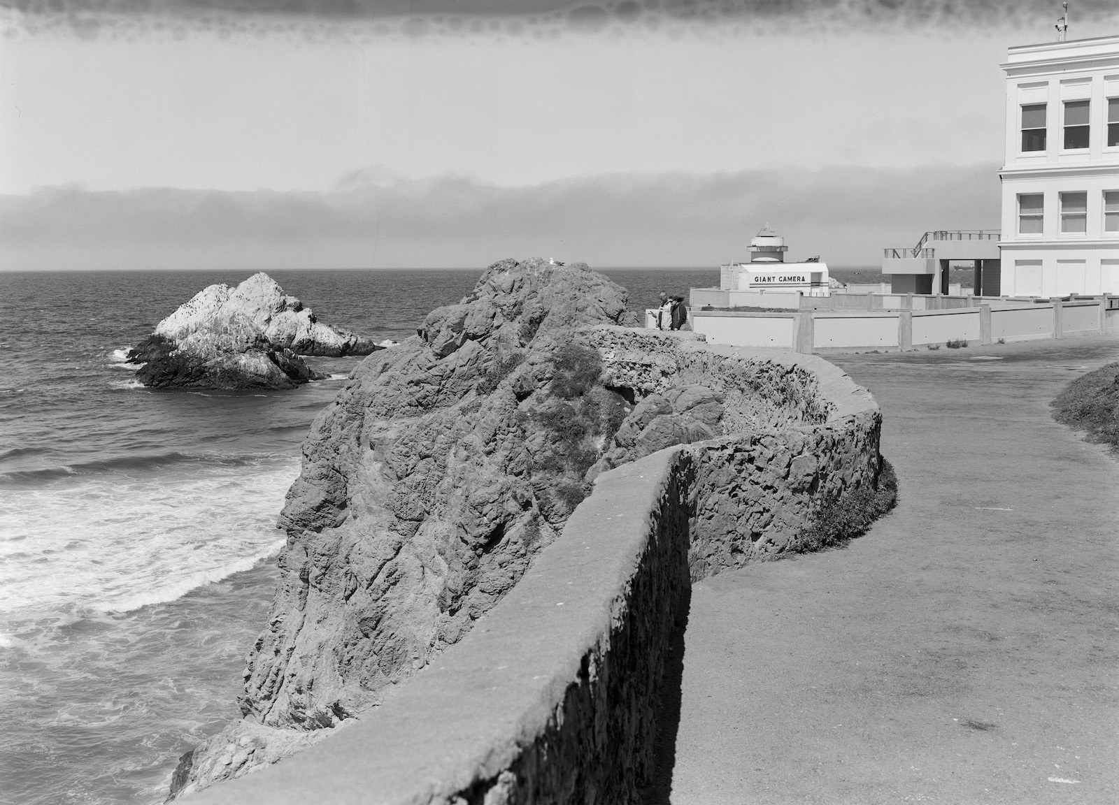

Well. I developed and scanned the negatives today. And here it is. My first 4x5 exposure:
It has everything:
  • Incomplete development at the top due to insufficient amount of developer in a JOBO tank
  • Scratches left by my repeated attempts at getting the sheet in and out of the holder
  • Black dust specks! My first. :smile: A new and exiting side of dust to be introduced to!
  • Fondest memories of inhaling my own t-shirt while trying to focus under it
  • Surprisingly, complete absence of my fingerprints!
Couldn't be happier!
The only slightly disappointing thing is that the resolution jump is quite modest vs 6x7 or 6x6. In terms of lp/mm my Hasselblad glass outperforms this Sironar-S.
It may not be the lens. The problem with resolution and sheet film, or a problem anyway, is that regular sheet film holders don't hold the film nearly as flat as the pressure plate in a roll film or 35mm camera does. There are (or were, don't know if anyone still makes one and if they do they will be $$$$ but maybe used) vacuum backs to deal with this but for the vast majority of uses they fit into the "far more trouble than they're worth" category. You get several real advantages with sheet film, along with some disadvantages: 1) much less grain from smaller enlargement factor for the same sized print, 2) the ability to process each sheet to different development times which makes precise Zone System work if so inclined, 3) some people think the tonality is improved. Others argue that's not the case. It certainly SEEMS to me to be the case, and 4) it's much easier to use camera movements and see what you're actually doing on the ground glass with the larger image to work with. There are 2x3 view cameras that can be used either with 2.25x3.25 sheet film holders or roll film backs (why anyone would bother with special order or at least hard to find small sheets is beyond me when they could use roll film, but you CAN... I guess you get that per-sheet development customization though, at least) but it just becomes "fiddly" and much harder to see the effects. I can clearly see this advantage when shooting 4x5 sheets versus just trying to compose in the area covered by my 6x7 roll film holder.
Another oft overlooked advantage of field cameras is - they're much lighter and more portable than many medium format cameras! I really like my RZ 67 Pro II and like using it where portability is not an issue, but it along with a couple of lenses much less three if I take all I own, plus a couple of film backs, makes a much larger and heavier pack than my 4x5 with three small lenses and both some sheet film holders and a roll film back. Plus I get camera movements.
What you mostly don't get, as you see, is a huge increase in resolution. It's available if you want to really work for it, meaning the finest lenses you can afford AND the flatest you can get the film. But I decided good enough is good enough - I can't print larger than 16x20 and even if I could do it 20x24 is the largest paper comes in sheets and I don't want to bother cutting up rolls. At 16x20 I have plenty enough resolution and the other gains.
The only one of your listed defects I saw right away was the uneven development. I had to look hard to find a scratch (I only found one and I was expecting it to be lateral, but if what I'm seeing is a scratch it's vertical on this image) and even harder to find black dust.
I admit I've just gone ahead and mounted, framed, and displayed prints that had small black dust specs that were in areas no one except me, or another photographer trying to be very picky and stick their nose on it looking for them, would ever notice. No one ever has. Maybe that's lazy of me, but heck, it's a hobby for me. :smile:

I like it - you used a large camera, to take a photo of a "Giant Camera" :smile:.
Hehe true. @Roger Cole the resolution is no biggie, I get enough. I blame unrealistic expectations. :smile:
Also the position of the ground glass may need re-calibrating.
I'll suggest vanquishing the dust in your film holders either with compressed air(good) or a vacuum(better) and storing them in zip lock plastic bags.
This is a common problem- someone gets a view camera and they are disappointed with sharpness/resolution. In other words the film plane and ground glass frosted surface plane are not the same, leading to not quite in focus images.
Wouldn't this affect the focus accuracy as opposed to resolution? In a 3-dimensional scene like above the misalignment of the screen simply moves the focus point around, but there must be a fragment showing what the lens is capable of.
