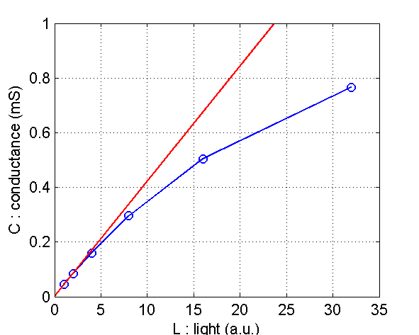

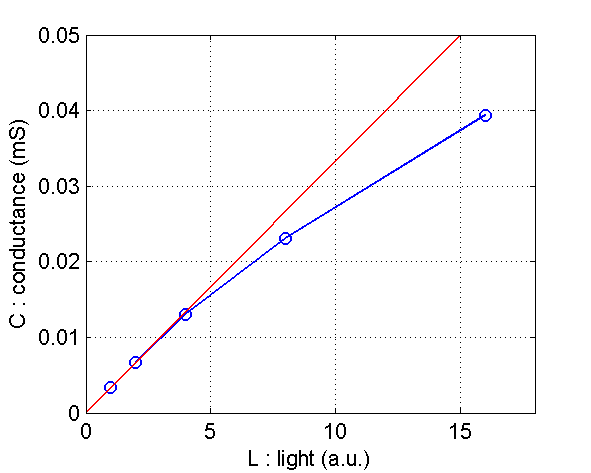

Here is some reality. Not theory, not argument. Measurements.
De-soldered temporarily the CdS cells from two enlarger light meters: a small Ilford "wand" and a larger Philips one. Put them on the baseboard, connected to an ohm-meter. EL-Nikkor 50/2.8. Stepped through the f-stop clicks, recorded resistance values. Light intensity is normalized to the smallest value (smallest aperture), so values are 1, 2, 4, 8... Compute conductance as inverse of resistance. Plot.
Below: blue line and dots: measurements. Red line: linear extrapolation from the values at low light.
Would you measure your negatives with such a sensor?
Note: I did this for the sake of accuracy of information on the forum. Now anybody can have his/her own opinion. I'm done with this topic.
Plot for the CdS cell from the Philips device.
Plot for the CdS cell from the Ilford device. I forgot to measure the last point.
Maybe you could have shared the meter readings on those meters over the same range.
From you charts, your enlarger puts out a lot more light than mine, and the CdS cell is much larger and lower impedance than mine? Also, regression lines are normally drawn to minimize errors, not maximize them. I could easy draw lines through those points that show less error from linearity. Oh, I forgot this is reality and not theory. Yes I would, I have, and will continue to use such a sensor. Also more correct to have increasing values on X-axis, not reducing values.
Looks to me like someone trying to prove a point using bad science. The second largest source of error for CdS cells is the so called memory effect. Both the very large heating effect and the large memory effect are the same or very similar at a given time, so tend to cancel out in a ratio. It is a bit of a kluge using the DMM more than the CdS cell, but with care it works well enough.
