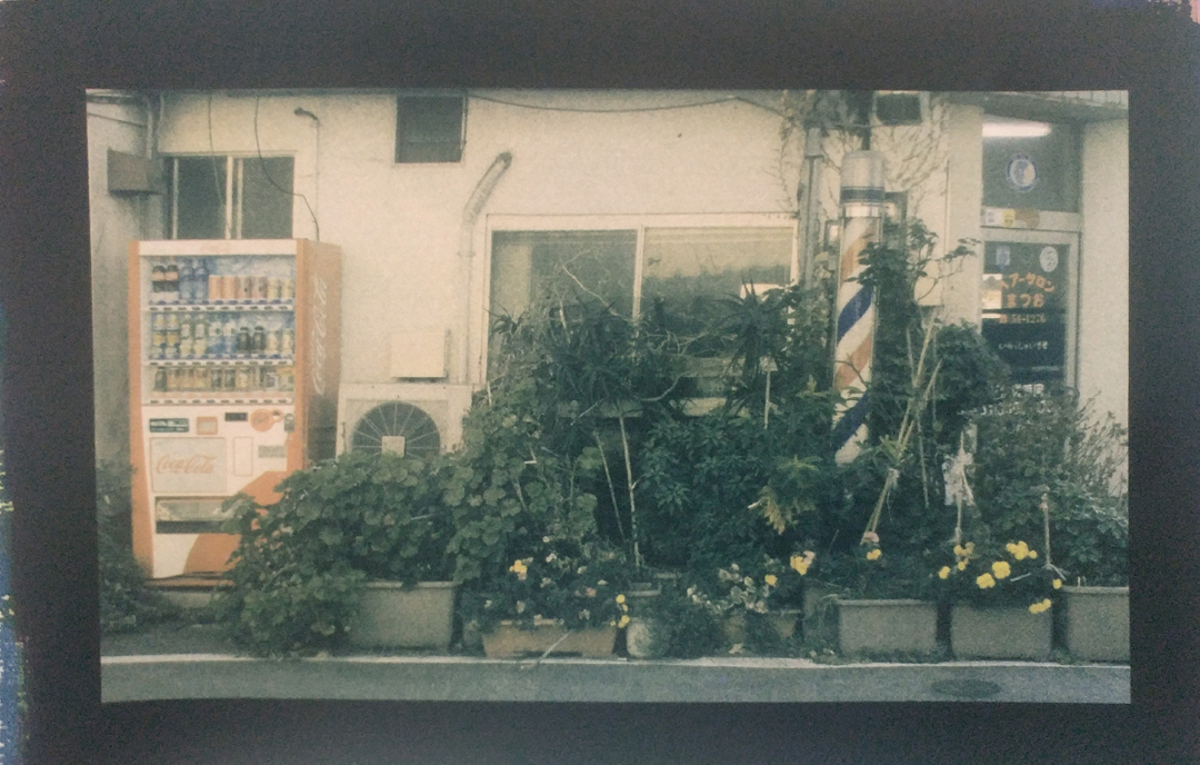

Thought I'd go back and revisit gum over cyanotype for full colour gum... It worked out quite well. What did I learn? That my 3800 SUCKS for making digitised negatives. Grainy, and I just can't get rid of the banding. Thankfully the gum process hides it. I sure miss my 4000. I think I'm going to take a look at the P400 that Sandy King talked about in his carbon group... Anyways, here is resulting print... on HPR.

Nice print Andrew well done
