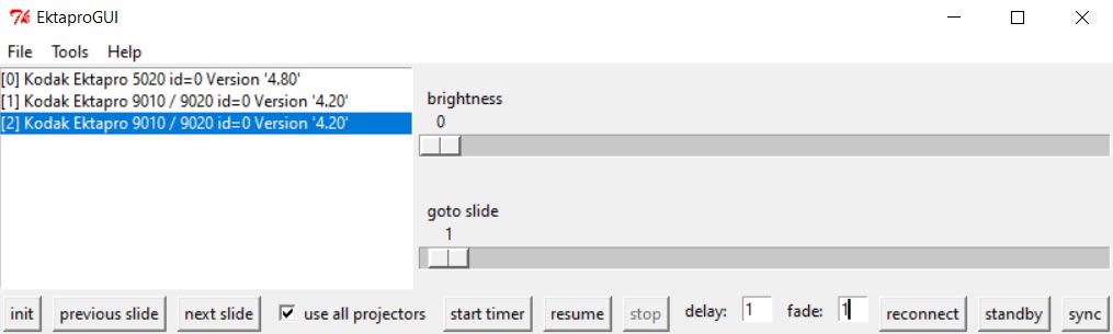

The third projector decided to play along without any intervention - just started working this afternoon:
Some of those carousels have only a few slides in them, hence the occasional skip.
Screen shot of the programme showing all three projectors recognised:
I'm going to write this all up clearly in the resources section in case anyone else follows me down this road.
