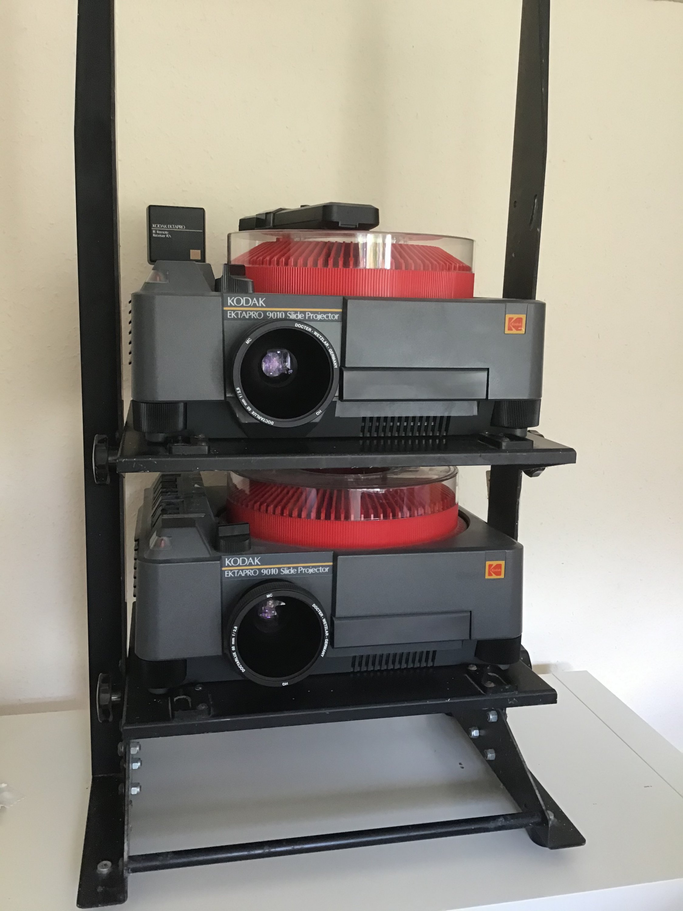

I want to see how far this forgotten craft can be resurrected in 2020. Here's my rig:
The Ektapro 9010 is a great projector and when coupled like this it can dissolve anywhere from a hard cut to ten seconds, it can support parallel projection, switching between projectors without forwarding the slides and fully automatic, continuous projection. However, it cannot support for example ten slide dissolves followed by parallel projection followed by hard cuts. For that I need a machine that can command the projectors.

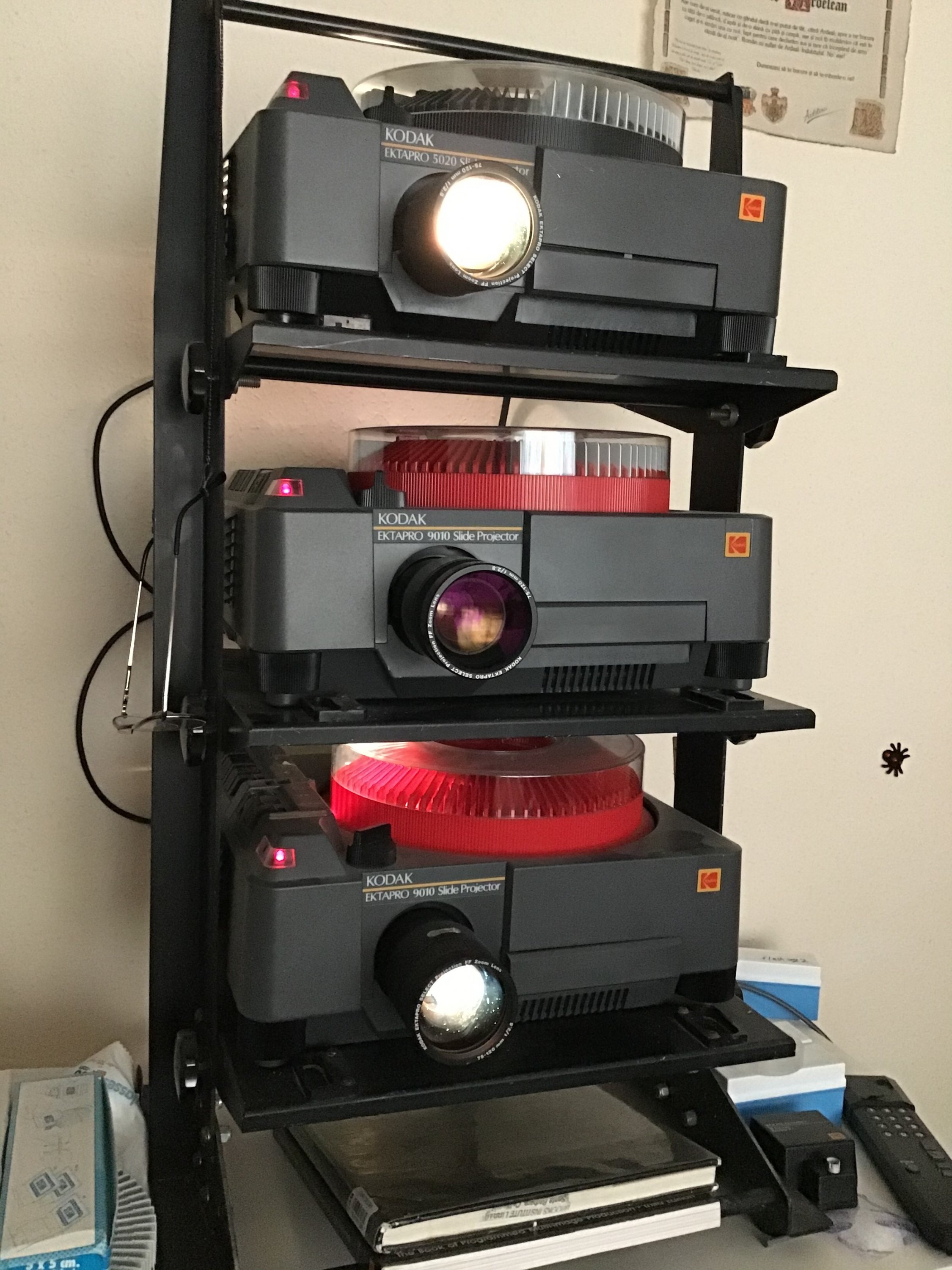

Update. I've daisy chained three Ektapros and I'm controlling them using a neat piece of software called Ektaprogiu on my laptop. Some success:
The problem (headache) I'm having now is that the middle projector won't communicate. But as you can see the other two are so the daisy chain must be working (bottom is command, other two are slaves). I've tried changing the address switch at the back to different positions but it doesn't help. I also don't know why they're projecting in parallel, I'm aiming for a three projector dissolve.
Hmm, I think my issue is the address switches. I remembered that the top projector (5020) has no P-Bus out so must be at the end of a daisy chain and because it has no address switch it is allocated '0'. Problem was the bottom projector (9010) was also set to '0'! (explains the parallel projection). I moved the bottom to '1', middle to '2' and the top is '0'. This had the effect of the laptop only communicating with the top projector! I think this confirms I need to work on the addresses to get proper communication.

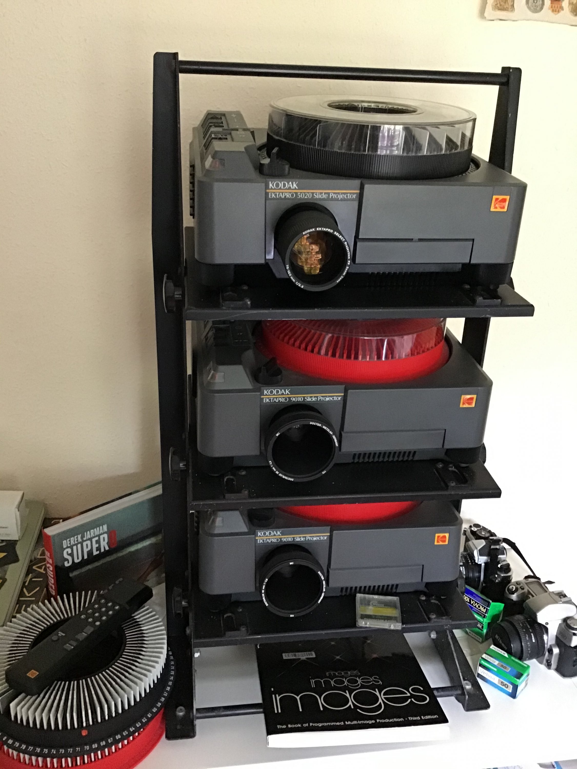

So, I fiddled a bit more with these machines:
  • All three work as stand alone projectors commanded by my laptop if the address is '0'
  • If I add a second projector addressed as '0' I get parallel projection
  • If I change the addresses the software only communicates with the '0' projector
  • Addresses go from 0-9 and A-F, I've only tried '0', '1' and '2' so far.
I opened the programme in a text editor and noticed this at the start:
"Currently, only one projector per serial port is supported"
Does this mean my daisy chaining will never work as the programme can only recognise a single projector per port? I do I then need something like this 4 port USB converter? Expensive, cable so I want to make sure before I buy.
Sounds like it -- that or a couple $10 dual serial cards (if you have enough slots and backplane spaces for them).
Edit: 'Doh! Forgot, you're on a laptop. You should be able to use a $15 4-port USB hub; each port gets its own address.
Ugh. Do they have to be MAX232? I've seen USB to D-9 or D-25 serial for $5 to $10 each.
Unsure, all I do know is that the MAX232 I've got here works and the laptop can command the projector. I'm tempted to get the more expensive cable as it's a known good, I've got a history of buying the cheaper option only to end up buying the more expensive one later!

Is there a setting in the software for which address? If not I think the software uses only address 0.
Daisy chaining should work in principle. Looks like the protocol is pretty simple, so it should be fairly straightforward to modify the software to allow addressing multiple projectors - or simply start over and make some new code.
I bought the MAX232 cables and I'm happy to report that the software now recognises two projectors and commands them as you can see in the above video. Unsure why the bottom projector is unresponsive, even when I plug that one direct into my laptop. Weird because that one was working when I connected them on a daisy chain. Going to switch round some cables and check connections tomorrow.
I can conform the software only recognises address '0'.
