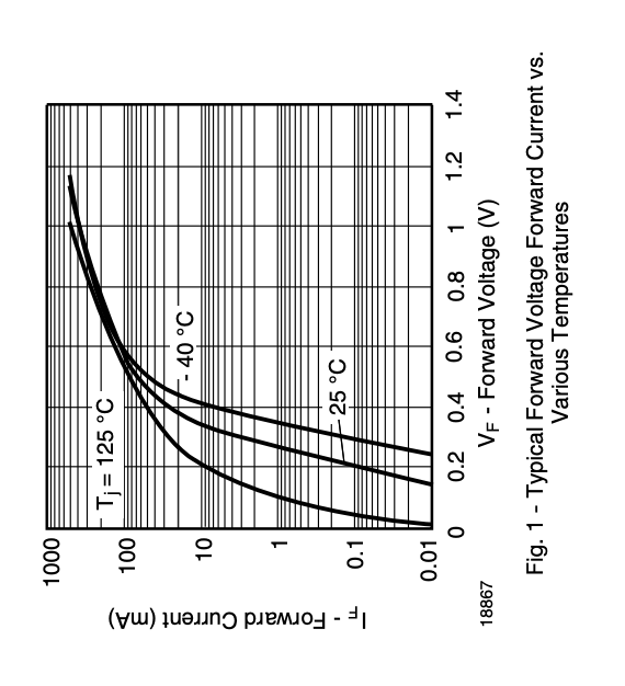

I think the type of adapter you have there simply places a small Schottky diode in series with the camera's circuitry and the battery. The voltage drop of a Schottky diode depends on a number of parameters, especially current and temperature (and of course the exact type and model diode used). As a result, the output voltage of this adapter (with battery installed) will fluctuate a bit - it may only hit exactly 1.35V under optimal conditions. To make matters worse, the output voltage will still follow the voltage of the battery used, and it is quite possible that the camera won't present a constant impedance to the adapter, meaning that the voltage will fluctuate a little bit depending what the camera is doing (e.g. how much light its meter is currently seeing).
There's a decent chance that the camera you intend to use this in will work fine nonetheless, although the accuracy of any in-built light meter may not be as good as with the original type of battery. You could try and compare the meter with a known-good external light meter and compensate for the difference.

The forward voltage of the diode is fixed according to the diode type.
Many of my cameras have been converted to 1.5 volts but I still have and use a number of MR-9 adapters. They generally work well. With some cameras, the thickness of the MS76 or equivalent will not allow the battery cover to screw in all the way. For those cameras I use a 386 silver oxide battery. It's slightly slimmer.
Schottky diodes (like most/all diodes) have a forward voltage drop that depends on the current through the diode. It usually rises weakly with current at small currents and then changes more steeply at currents that are much larger than anything an MR9 adapter would ever see. For example, here's a plot from the datasheet for a BAT54 Schottky diode, I've rotated it so forward voltage is on the Y-axis. You can see that the Vdrop is about 0.15 V at 0.01 mA and 0.25 V at 1 mA. When you hook a digital voltmeter up to it, which probably has an input resistance of hundreds of Kohms or more, you're measuring with a current draw of a few micro-amps or even nano-amps.
Probably, the designer of the MR9 picked a diode that drops about 0.2 V under a typical current draw of perhaps a few milli-amps. Understand that most older light meter circuits are pretty simple, often using a few resistors and a light-sensitive element to approximate logarithmic sensitivity, not a precision laboratory instrument. Bottom line, most users are happy with the adapter.
Thanks, I should have taken a look at some diode datasheets from the start :smile:
