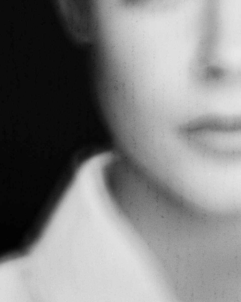

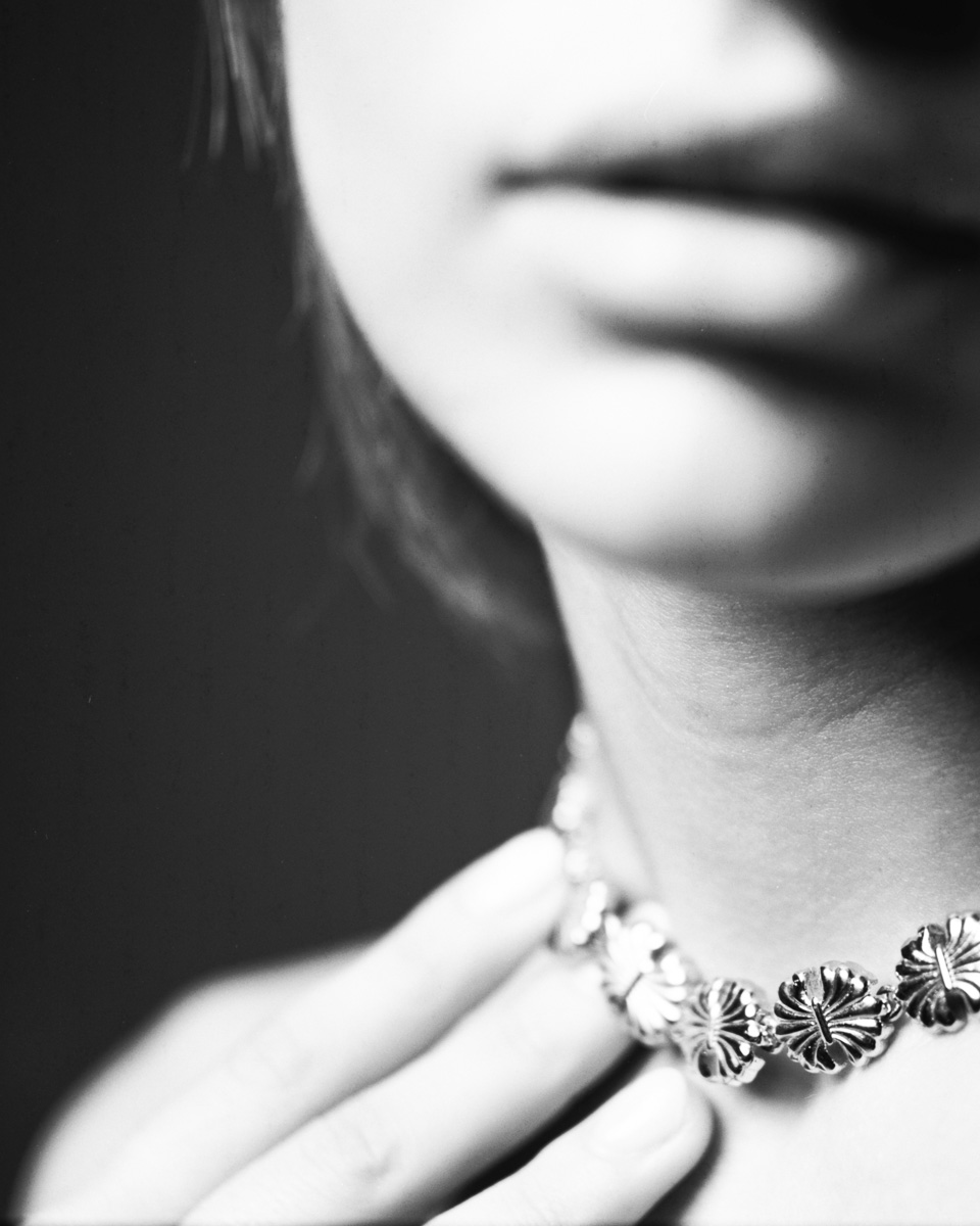

I am reviving this old thread. Five years later, it seems Rollei RPX 25 still has trouble with mottling.
I shot a number of rolls of medium format RPX 25 and this issue is still here. Tried pre-soaking, tried different developers, nothing is happening.
The first image was shot a couple of days ago. The (fresh) roll of film was out of the fridge for two weeks or so, it was developed in Microphen one hour after it was exposed, normal inversion method at 20c, and all the frames have the same mottling lines.
The second image was shot with the film being 1-2 days out of the fridge, same batch, the film was even more fresh. Developed in HC-110(B), 20c, in a rotation tank. Same mottling lines in the shadows.
I am looking at a wonderful film that is actually unusable, and it is a big shame indeed.

Were both rolls within their expiration date? I ask, because the markings look exactly like the classic "wrapper offset" marks we often see with expired (or improperly stored) 120 films.
thicktheo
Aug 30, 2008
148
Athens, Greece
They still are within expiration date, I got a brick of 10 rolls six months ago and have used half of them. They have been stored in the refrigerator from day 1, along with all my other films.
A couple of them spent some time outside the refrigerator before they were used, say 3-4 weeks, but even so they were in a cool dry place, nothing extreme.
