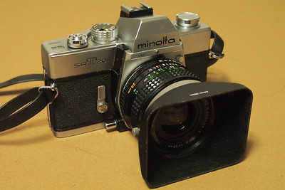

Between my father, my two brother's and my nephew we've been using the same srTsc-II since the early 1980's and it still works great. It's never been serviced and still has the plastic on the wind lever which is probably the most common problem with the srT models. The srTsc-II is basically the srT201 without the self timer and memo holder on the back. It was made for sale at Sears stores (SC). Besides the great lenses and reliability I think what I like most about them is the familiarity since I've been using them for so long.

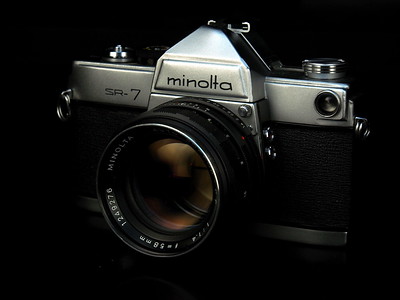

I also have two srT201's and an SR-7 that all work great. The SR-7 is a really well built camera but it was pre TTL metering. It has a meter built in but you have to take a reading from it's readout on the top of the camera and make sure your finger doesn't cover the meter eye. I think I probably changed the light seals in most of my Minoltas, that's about all I have done with them as far as repairs. I use hearing aid batteries with an O-ring which are cheap and work great.

Minolta srT201 by Bryan Chernick, on Flickr
Minolta SR-7 by Bryan Chernick, on Flickr
