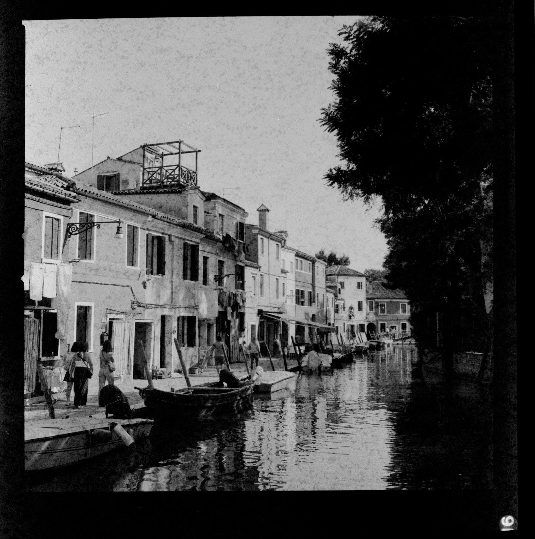

Waking up an old thread here, just reporting that I had a batch of Fomapan 400 in 120 format that had the same problem it has had in the past with an imprint of the backing paper on the film. I had 20 rolls, out of which I used 11. Batch number 011756 5. Expiration date November 2025.
- Rolls of other brands developed alongside were fine (Kentmere 400, Ilford HP5+)
- Three different developers used (D76 1+1, Paterson FX-39 1+9, PMK-Pyro) makes no difference on the outcome
- Presoak and no presoak makes no difference on the outcome
My advice would simply be to only use this film from a batch you for sure have tested, and within a short time of testing it. The problem seems to get worse the longer the film sits unused.
It has ruined dozens of rolls for me over the last years. I absolutely love how the film looks once processed and printed, but the extra step of having to test the 120 film each time is very tiring. The attached picture is one example from a contact sheet, there are those that are a little bit better, and those that are a bit worse.

Oh yeah, that's classic. You're right that the risk & impact get bigger the older the film is, with storage conditions being an important moderating variable.

Normal room temperature should be OK for b&w films, kept in their wrappers until shooting them, and processing within a few days should be good enough.
No issues with Kodak, Ilford, or Kentmere under the same conditions, even outdated film of other brands don't behave like this.

Is that caused by the backing paper, and only the backing paper?
I ask because once a friend put his film in his checked bags when flying and got a similar pattern from X Rays. This was probably 20 years ago before wrapper offset was a problem.
To my knowledge yes. On some frames one can see the imprint of the ink on the backin paper as well, like the round dots and the numbers. I usually travel by train if I go somewhere to photograph, and this film has not been flying.

I've never had these backing paper mottling issues with Foma 400 (and until last year this was my main 120 high speed film, I used hundreds of rolls per year), but I did with lightly expired Ilford, Rollei and Foma 100 (not 400) film kept at room temperature.
How do the Americans say? It's a 'crapshoot'.
The sad reality is that film, any film, in 2025, should be used strictly within its due date.
Just purchase film that you know you'll be using over the next 2-3 months and you'll be fine.

Foma in 120 format is the only film I have consistently had problems with. If I go through my records, I have had Ilford Pan-F 120 (before the plus days) that was expired, and some very expired Agfa APX25. Other than that, Fomapan 200 and 400 in 120 format have been a massive headache for me. When I wrote the shop here in Switzerland where I buy it, they acknowledged that I was not the only one, that there had been some significant problems this year. Make of it what you want.
Nowadays I always buy fresh film, this batch of Fomapan 400 was purchased towards the end of 2024, so there was a year to go before the expiration date. I was hoping that my information regarding the specific batch and expiration date could be helpful to some, to not have the same misfortune.
