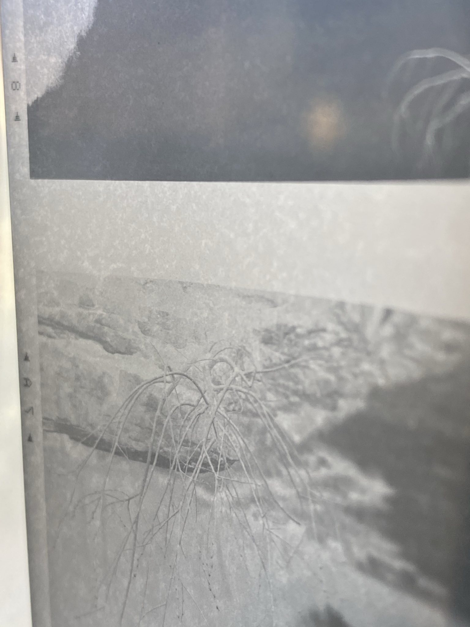

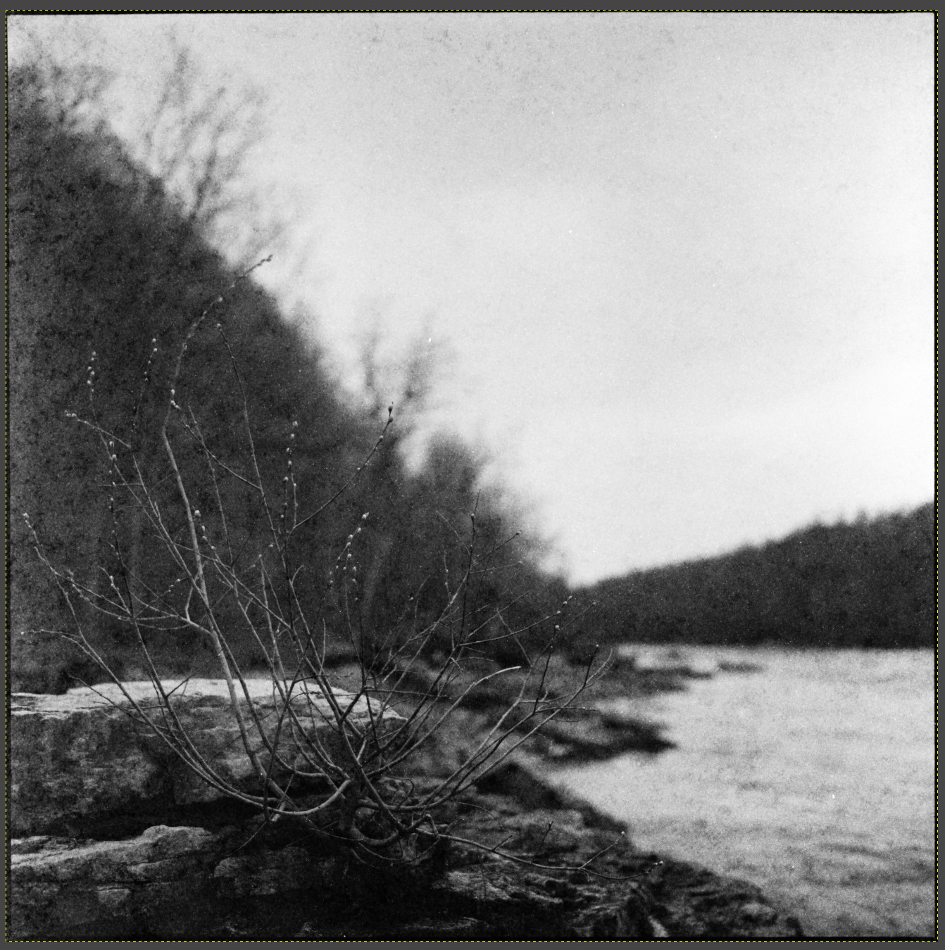

This is Arista Ultra EDU 400, fresh. I like Fomapan, but I don't think I'll be shooting it in 120 much more. Just wanted to put this out there. Exposed and developed at 400.
Separate problem:
What a tone curved picture looks like, those white specks are not dust:

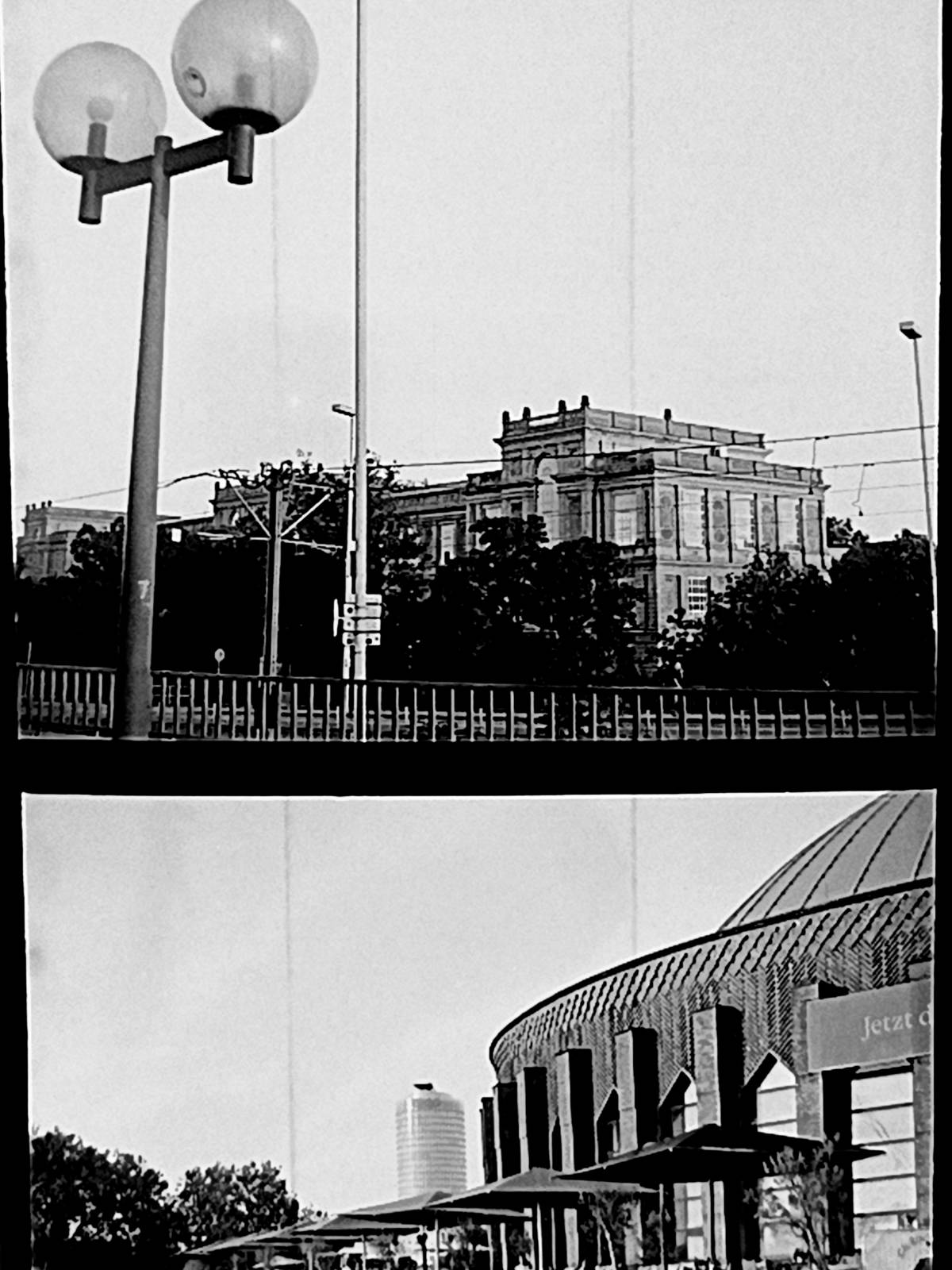

I will avoid Foma 120 film. Too many defects. I had some issues with 2 parallel lines caused probably by a tranportation roll in the production on each Fomapan 400. It was even visible on the backing paper.

The defects were lower density on the negative - just like here. Koraks` Fomapan 400 was 35mm film, showing these defects but not as intense and big as the 120 films here. 120 film is wound (much) tighter onto the spool than 35mm film, reinforcing my theory that these lower-density-defects arise from pressure on the emulsion.
And just like in the other thread, I'm going to tell you again that your theory doesn't add up. Pressure marks show up as higher density. You can easily try this with any silver gelatin material. Mar with your fingernail, then develop. If you take any roll of film, noteice how the very edge tends to be black after processing; this is where the film was cut and the pressure of the blade has rendered the silver halides along the very edge developable. It takes a fair bit of force to get silver halides to respond to pressure.
What's shown here is a backing paper imprint problem that many manufacturers run into from time to time. They're apparently chemical interactions between the ink or constituents of the paper itself, and the problem is helped along with moisture and temperature (as is often the case with chemical processes; they need a carrier for ion exchange and temperature speeds up the rate of reactions). This backing paper problem has nothing to do with the problems I discussed/showed earlier on the 35mm product, other than that probably this particular emulsion is fairly sensitive to anything. It's relatively high speed, of course, and Foma is known for having relatively soft topcoat on their films. I expect these factors play a role as a common contributing factor, although the failure mechanism is different.

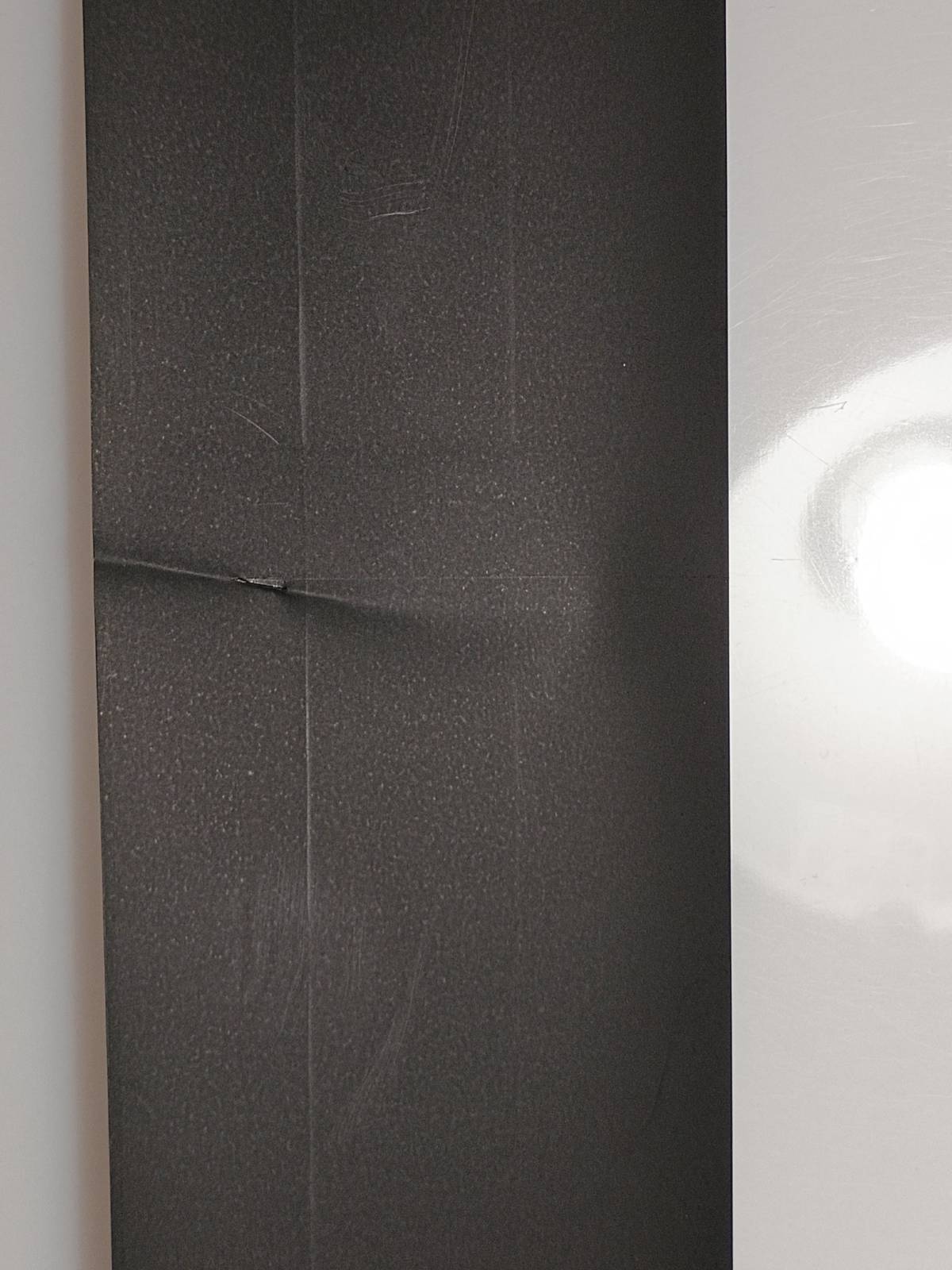

Yes, what I experienced here is definitely backing-paper-specific and not something that can be fixed with prewash. As I recall, when tilting the film around in the light and observing the sheen, it appeared to be on the non-emulsion side.
Non-emulsion side problems are quite unusual, when it comes to backing paper issues.
The backing paper apparently did damage the back on the film, but there are lower-density-defects on/in the emulsion.
