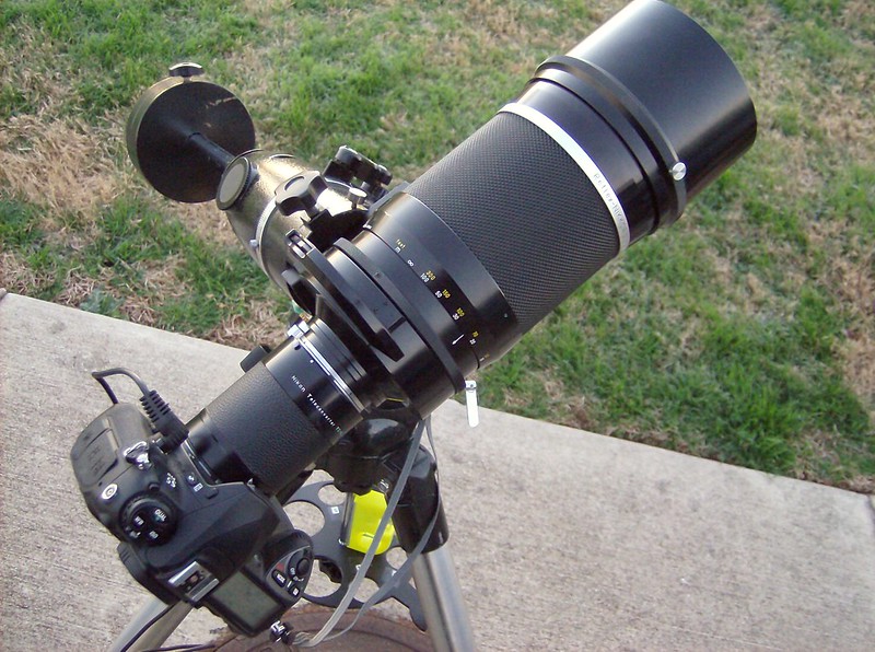

I have a 1000mm f/11 Nikkor mirror lens and an Orion 900mm f/9 APO refractor telescope that I use for lunar photography. I prefer to use the Nikkor mirror because it is so much easier to transport due to its smaller size.
Attached is an image of the lens with a Nikon TC300 2x converter.
