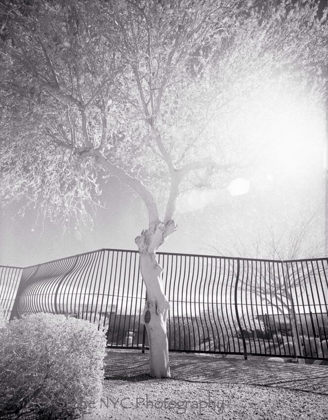

Ok here's one from January 2013 shot on IR at noon... The proof of time is part of the image.

Wow, what the heck am I doing wrong?
I can't seem to get anything like this, everything I shoot is over exposed and I'm using the proper filter B+W brand so it's not junk.
Is the Rollei just not capable of getting that because it's only in the 700's?

Dunno. What exposure are you using? How are you metering? Which exact filter do you use, i.e. what wavelength? (Mine is a generic uncoated-glass Chinese R72 clone, i.e. 720nm cutoff)
If it's always overexposed, did you, um, try exposing less?
The IR820 is definitely better (more Woods Effect) than the Rollei in side-by-side comparisons, but I've seen decent results from the Rollei on flickr too. And certainly I'm hoping the Rollei isn't toooo bad, since I bought 200' of it in 70mm to use once my little stash of 120 IR820 runs out (4 rolls left). Happily I have about 370 sheets of 4x5 too :wink:

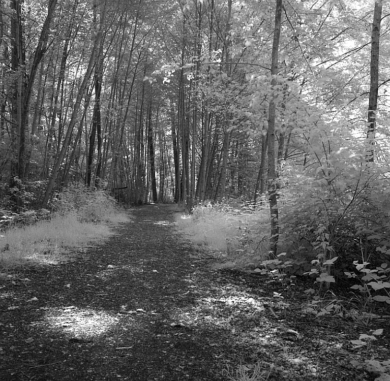

This was shot using a Hoya R72 and the Rollei: (there was a url link here which no longer exists)
See the notes and comments.
I think the trick is that you cannot of course meter for the IR, so you are essentially metering for the visible light, filtering it all out, and then guessing how much IR accompanies the visible light. So as guessing is involved, I recommend bracketing.
This shot is in keeping with the MSA theme, but shot a long time ago. There is another one from the same roll in my gallery.

Hmm I have the B+W #92, it's a 650 cutoff but says passes 50% from 650-700 and 90% from 730-2000
The next step up is a #93 but it starts at 1% at 800 so 800 is beyond the Rollei as far as I understand?
Did I get the wrong version? I know people use the R72 but I don't like the Hoya filters and thought the B+W 92 was the same filter?

I think your problem is as much with your exposure choices as it is with filter choice. Although that 50% cutoff between 650-700 lets in a lot of visible light.
Of course, you may just be unlucky in your choice of subjects :smile:.

Well the literature on B&H for Hoya is less clear.. And Hoya saying it has no transition point from full throughput to none at all as a cutoff seems unlikely ... There must be some transition, so I assumed B+W was just more accurate with it's description but had the same characteristics as the Hoya... Anyone know officially?

Yeah, you got the wrong version. You're letting in so much red light that the IR exposure is swamped by the visible exposure.

OH!
Someone said the #93 since it starts at 800 would expose BLANK, is this wrong?
It would surprise me if B+W just didn't make a filter that all the other companies make...

It looks like B+W don't make an appropriate filter. The 092 and 093 are gradual-cutoff filters like Hoya's RM series whereas what you want is a sharp-cutoff filter like the R72.
Hoya specifications, noting (from the graph) that the R72 transition band covers only ~710-740nm.

Darn.... That was an expansive filter! :sad:
Anyone want to trade? I doubt B&H would take it back now...

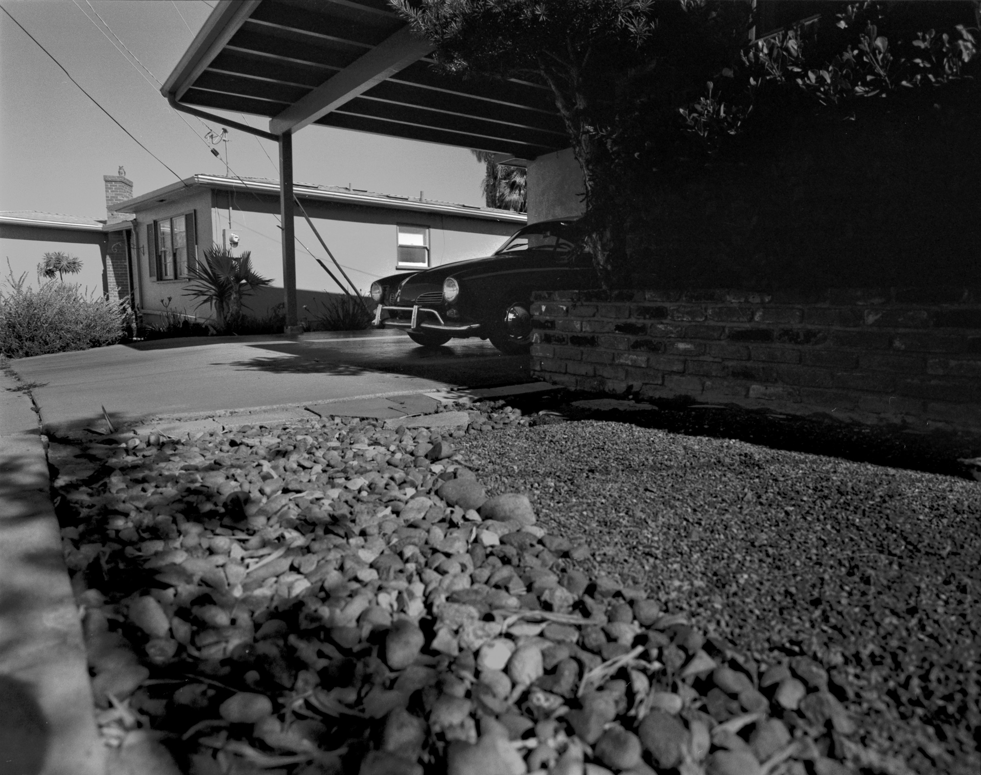

I'll sneak in a last-minute entry.
Pentax 6x7 MLU
Pentax 67 45/4.0 @ f/8.0
Kodak TXP 320 at 200, 8 mins in HC110 1:49

Nice.
A 45 mm lens at 6x7 gives a very nice angle of view.
BTW:
Is it a self portrait? :smile:
(shadow @ bottom, left corner)

Yours looks deserty too, Fixinator. A place I'd want to stay out of the sun at high noon. American southwest?
Fixcinater
Dec 11, 2008
2,500
San Diego, CA
Sly, you're right. About as far south and west as you can go in the USA: San Diego. No cloud cover that day.
Bert, yes, I admit my head made a sneak appearance. Still getting used to the crop from viewfinder on the Pentax.
