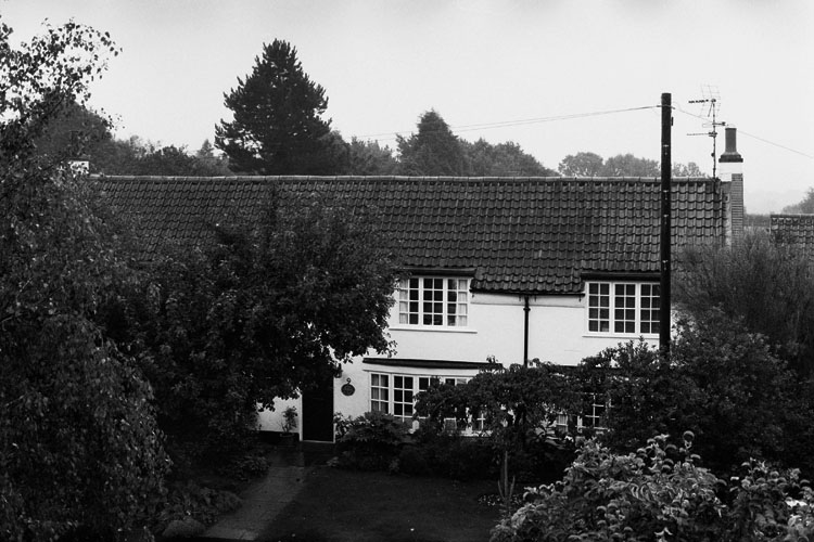

I've attached a neg scan, which is fairly close to the print I've just made, straight @ grade 2.

That looks like a reasonable result.
The "creamy" substance might be sludge, or you could be getting some dichroic fog. Soak the neg and see if it comes off with a wet sponge, in which case it would be sludge. If not, try refixing.

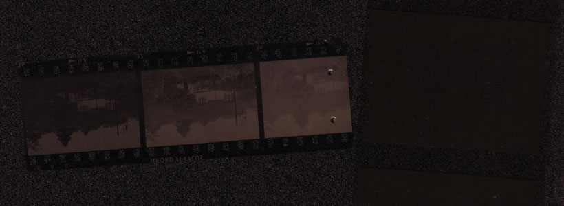

OK, I've tried wiping and refixing to no avail.
I've attached a scan of one of the strips and a 645 neg I had handy. Both are Ilford FP4+.

That might be dichroic fog. Search this thread, and you'll find a few recommendations.

Reporting some first results here.... I did my first MM1 dev last night with my co-experimentalist Diwan Bhathal, using some 35mm ilford pan f he rated at 25. The back story is that I drove from drug store to drug store in Bethesda on a Sunday night looking for NaOH, which I had failed to pack in my kit, and they weren't about to give me any. Do I really look like a meth maker? Well maybe I shouldn't have mentioned the phenidone. After I concluded that I'd better call it 'lye' and say I want to make soap, I quickly located some in the drain-clog-removal section of a hardware store and the test was done with success.
So... <drumroll> ...here are the results.... and yes, we deliberately chose a very contrasty scene....
MM1 neg, full frame
D23 neg, full frame
MM1 neg, zoom
D23 neg, zoom
A few comments.... N.b. I had added extra lye to boost contrast, don't ask me why, it seemed like a good idea at the time, but clearly the effect wasn't helpful: the tonal detail is there but would likely be harder to get out of the neg in print, the d23 neg has kinder CI.
Sharpness/acutance clearly goes to d23, but... hey for contact printing the sharpness of the mm1 would be totally fine. More than acceptable.
Dev details: I gave the film 7 mins in the mm1. After that it was washed in water, that's it.
All in all, a very satisfying first attempt at monobath.
