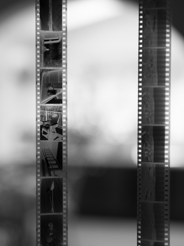

I have tried twice to develop a film with no agitation at all, as New55 recommend. I still get surge marks simply from pouring in the solution (they are on one side, at the edge that was at the bottom of the tank). I went back to the Rondinax and processed a roll of Acros 100 with continuous rotation. Here they are hanging up to dry - on the right is Tri-X with surge marks, and on the left the Acros with none:
Easy to see which is which!
Try agitating a little at the start of development to even out the initial 'surge' and then letting it rest. A pre-soak may also help to even out the initial development.
The surge marks aren't from pouring in the solution, so much as uneven development from "bromide drag," which happens over the course of development as the developer moves even in a still tank. It's definitely something you don't want.
It's hard to judge contrast from a scan, and it seems like the two rolls were exposed under different lighting conditions, but you've got way more contrast in the film that had more agitation. I'd guess it's too much, but you have to judge that from how they print using whatever method you use.
With FX6a, I agitate 5 sec for each minute--enough to avoid bromide drag without increasing the contrast too much.
