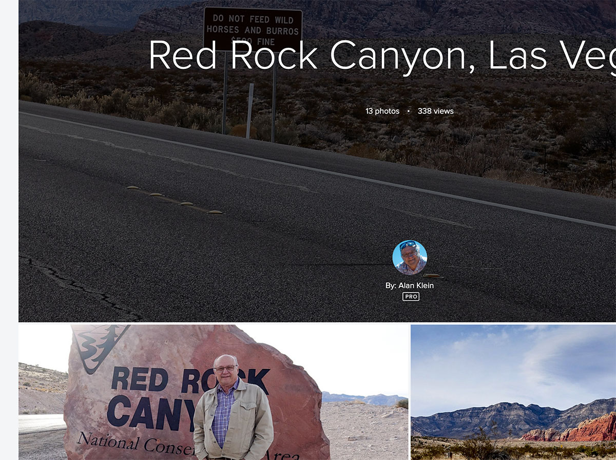

I'm not seeing what you're seeing regarding the darker ones on top with the text. You should be able to click on the first picture in each group. It will open full size. Then click repetitively on the arrow on the right to go through the rest of the shots in full size. Try that. Do the pictures look better? (Note I don;t see flare in the second shot. I do see clouds on the left side of the sky however in a semicircular look.)
The fact they look good generally is important to me. At least I'm on the right track.
I do know how to navigate Flickr, but maybe I don't use it enough to understand it's visual language. What is the "first picture in each group"? The very top photo, the big one, with your white Red Rock title text on it? Or the next one after that (you in front of the rock)? At first, I thought your title shot was part of the group of photos - and if I clicked on it, it might, clear up, or launch the filmstrip, or whatever Flickr calls it. Something about the darkened photo made me think it was clickable, but I see now, it is more of a banner or a graphic for your title and the photo was meant to stay dark in the background. The straight shot of that scene is actually the last image in the group.
I was hesitant to use the word "flair" but I don't know what else to call it. Look in the upper left-hand corner of the rock you are standing in front of. Look at the park logo on the rock - the black logo is not black. The face of the rock looks a bit washed out - like there is lot of dusty atmosphere between you and the rock. Was it very dusty / foggy? If not, I think the low contrast is due to the bright backlight causing some minor reflections inside your lens.
The first picture is the one with me standing in front of the rock. The Flickr darkened photo at the top with the name of the folder is the banner. It uses one of the actual shots. So apparently we were discussing the wrong pictures. You're right that there's reflection off the rock and my head and also washing out the black lettering. Nothing I would bother trying to correct when I edited. The sun appears very bright coming from the left accounting for that "glare". I handed my camera to a stranger nearby and asked her to shoot me. But the girl was young and cute and I don't want to comment on her photographic skills.
