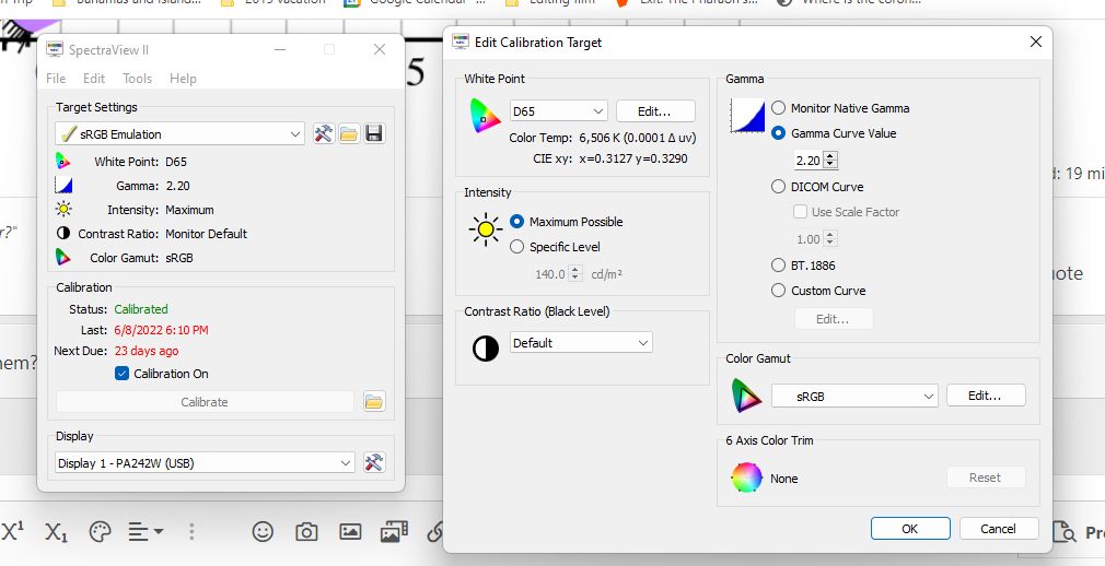

OK I set the calibration for Spectraview II to sRGB and then hit calibrate. Of course, the puck was connected already and mounted on the NEC PA242W monitor display. It then spends ten minutes going through all these color changes. Done. I guess I'm setting the monitor for the sRGB color gamut. AM I?
After its done, I have these setting results:
Yes. I am unfamiliar with the Spectraview, but assume it will save the profile to windows profile settings. As long as it does that, you are in sRGB.

Yes thanks for that. It appears I always use the same selection as you can see in the photo in my above post.
It concerns me that you have selected "Maximum posssible" for the Intensity setting. If your work space is very brightly lit, that may be appropriate, but I think many people have their monitors set too bright. I believe it is common for the calibration software to make the user choose a brightness level, tho some have a mechanisim to measure the room ambient light level and pick an appropriate value.

My setting for luminance is 217Cd/m2. I didn't set the highest selection. I just left everything at default when I calibrated the monitor. Why does it matter? How does the brightness level of the monitor affect the final image that goes out as a file to the web? It doesn't change it. I use the histogram to set levels to avoid clipping. So luminance should not affect that. Of course contrast, and some of the other sliders would be affected. I guess looking at the results would be the best way to tell if I'm getting good results. So maybe you can help me there.
