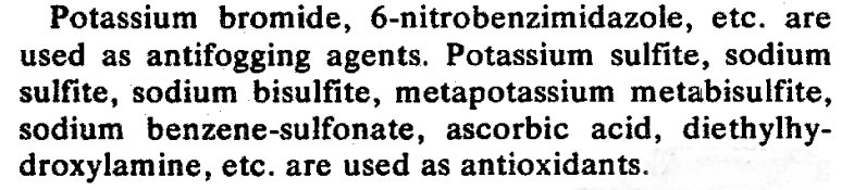

You need to read things :D, but I could have given all the Patent No's :smile: use the search feature in Adobe Acrobat: Try another US 3765892 this is the one I cut & pasted from. I'm skipping between Patents rather fast looking at it's uses, and the Fuji Patents are interlinked through citations etc.
attachment.php
2nd line states . . . . . . sodium benzenene-sulfonate, ascorbic acid, diethylhydroxylamine, etc are used as antioxidants. Page 3 of the Patent bottom of Column 3.
The fact that Fuji refer to it in at least 4 Patents, and that many other companies/patents refer to it as an antioxidant is rather conclusive that it can be used as such.
Sulfonic acids, as a class, are often used as detergents/wetting agents. Benzene sulfonic acid is probably not used for that much as it's rather reactive, I thought. But longer chained sulfonic acids are, as you can have an alkane or aromatic on an alkane chain and the sulfonic acid group on the other end, and that's good for detergents.
Sodium Benzenesulfonate may well fall somewhere between what Mason (& Levenson) cal anti-oxidants and wetting agents - which include sodium alkyl sulphonates.
I was more interested in finding a link to it's use by Agfa, I've save some of the other Patents for later reading but didn't think they were of that much interest.
Ian

You need to read things :D, : Try another [...]
US 3765892
this is the one I cut & pasted from. I'm skipping between Patents rather fast... Ian
Well Ian yes you need to read things. :D
I don't understand why you are not more sensitive regarding your release of misinformation /misdirection but well, OK. whatever. You did finally get it right on your third try! :tongue:
I thought that text looked famaliar... I still have notes notes from Dr. Iwano's lectures - He is a very cheerful person. The last time I spoke to him was when the director of IPI was here, some months ago. (Photographer Eiko Hosoe was there as well - if you are one of those who like his work/ideas)
Anyway I was quite happy to be reminded of Dr. Iwano.
I think I gave him a really hard time! :D

I tried a search of USP 3765892 and find no reference to benzene sulfonates. The "find" utility in the PDF file does not find it, but it is found in the search of the text version. It becomes clear though that there are errors such as the claim of an antioxidant called potassium fulfite! :D
Errors do happen. The point is that we do not know for sure in spite of that patent.
Aplogies I actually thought I'd given the right Fuji Patent No, when you speed read 20/30 in a row saving the relevant for later reading it's easy to grab the wrong number :smile:
I might add, in support of my comments, that diethy hydroxyl amine, which is claimed as an antioxidant, would be a very poor one for B&W developing agents, especially at that pH.
PE
The Text part is OCRed which is why Text usually not there for old poor quality photocopied Patents.
Patents are waffle full of irrelevances hiding facts, ascorbic acid won't work at that high pH (examples) as an antioxidant either.
