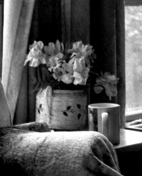

Here are .jpg files, overall and detail. These are from direct scans of the negative. I think you are right. Even at much reduced file size they look better.

Kirk Keyes
Jun 17, 2004
3,234
Portland, OR
I think that looks better - no artifacts from the pdf. You posted a photo in the Part I that the pdf had mangled so much it looked like it had been transmitted via a 1950s facsimile machine!
