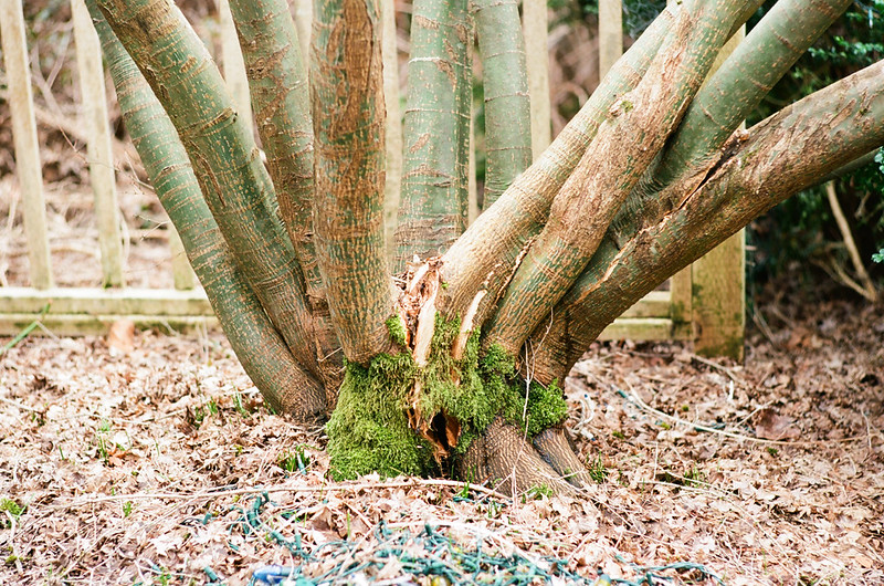

For a portrait lens, the 85/1.8 K-type pre-AI Nikkor with an AI ring is a good choice. Admittedly, not a human portrait, but a shot of a broken maple tree trunk. Nikon F2AS, 85/1.8 K, same film as used above.
