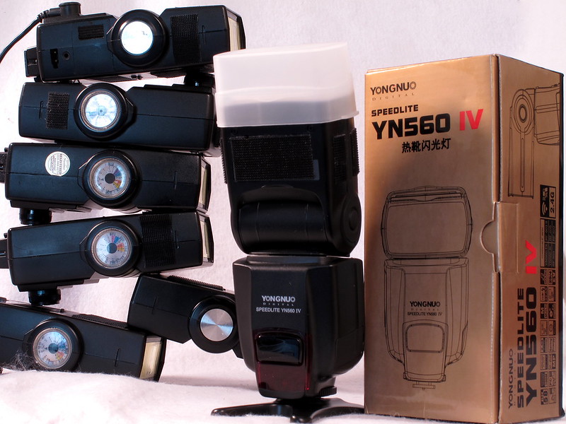

For decades, the Vivitar 283 has been my workhorse electronic flash for shooting portraits, action, interior architecture, weddings, still lifes, macro, and candids. I used them mounted on the camera and off the camera. I triggered them remotely with optical slaves, radio slaves, and long synch cords. I used them mounted on light stands with umbrellas, soft boxes, and large diffusion panels.
Over the years, I owned and used eight of them. As they aged and stopped working, I repaired or replaced them. Now that I am down to only three working units, I decided it was time to replace them with something newer.
Since I shoot with a variety of cameras (e.g. small format, medium format, large format, film, digital, Canon, Nikon, Fuji, Pentax, Olympus, and a few others), I prefer to not replace them with a dedicated flash unit. The Yongnuo YN 560 IV, like the Vivitar 283, is a flash that is not dedicated to a specific camera brand. One major advantage the Yongnuo has over the Vivitar is that the optical slave, the radio slave, the zooming flash head, the variable angle flash head, and the variable power output are built into the Yongnuo. They were separate and expensive add-ons for the Vivitar.
Yonguo YN 560 IV by Narsuitus, on Flickr

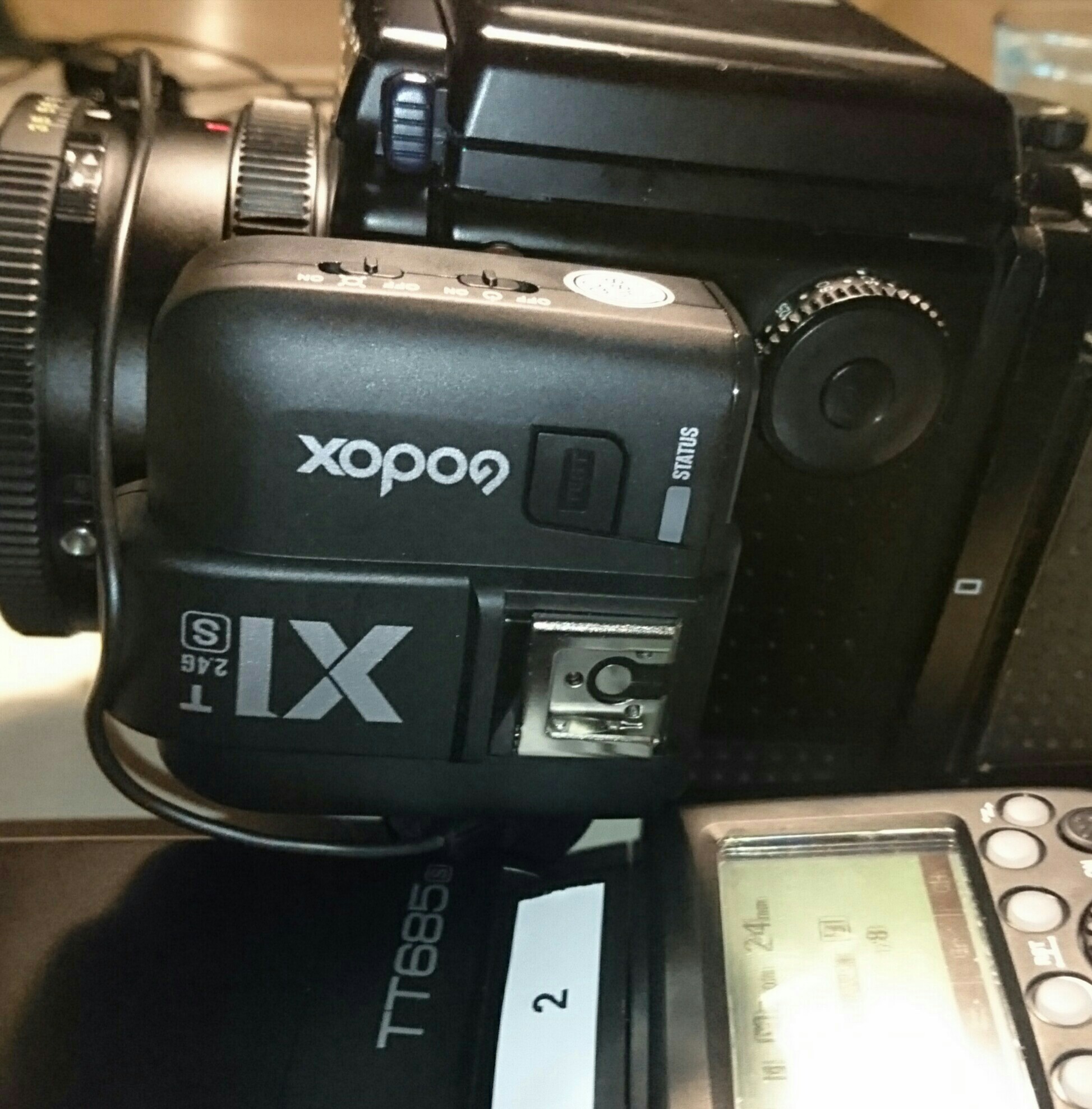

https://www.amazon.com/YONGNUO-RF-6...1_9?ie=UTF8&psc=1&refRID=VFWYPQ3ACACKE761NBZ2
Do these type of modern, wireless pose any problem.?
Do you have to worry about the pins not lining up, or maybe shorting with our older cameras/flashes.?
Thanks
I use the older version (602), and have had no problem using them with any hotshoe flash (except Minolta/Sony's because of the shoe shape). I will say this though, of 2 TX's, and 5 RX's, only 1 TX and 2 (or 3) RX's are still working after only 3 years.
