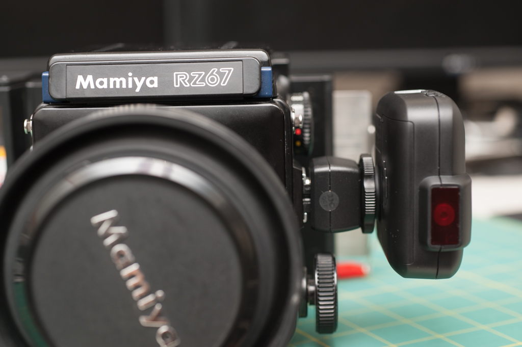

Yep. Why the adapter? For distance/working space?
I like the fact that with this system I have full control, TTL and HSS etc with the dedicated system AND I can control power settings from camera with any other system. The PC port is nice when shooting older cameras or LF :D
Nikon TTL pins on hot feet cause problems mounting on non TTL hot shoes so this little adapter has little ramps that help push the pins up. The adapter is otherwise a dummy center pin pass through.

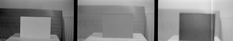

I think there can be a problem with ttl flash + ambient light if the subject is very light or very dark as some ttl systems assume it to be mid-grey and will underexpose or overexpose the background.
Attached an illustration of the effect of subject lightness (white, grey, black card) on background lightness with E-TTL Canon 580 EX on Canon Rebel Ti (=EOS 300V)

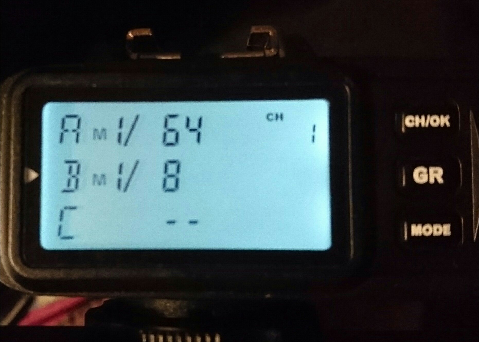

No. Using the Godox system on a non dedicated camera you set the flash output manually from 1/1 to 1/128 on the trigger. You can control up to 5 groups (pic show in 3 group mode), the number of units/group Im not sure about. You do all your measurements using your flashmeter but you set the needed power without having to move anything, not yourself, not a flash positioned up high or far away and not having to strugle with softboxes etc.

I just re-read my post, and I was pitifully unclear. I'm referring to the ability to control flash levels from the command unit. As pictured above, Flash A is at 1/64 power, and Flash B at 1/8. Are these flashes the same brand as the camera, or are they Godox flash units, or...?
I believe, for features like that, the commander and flashes would have to be part of a proprietary system. But, I'm no expert on everything that's available, so maybe not.
My current flash system is Yongnuo, consisting of four 560 III's and the command unit, which mounts on the camera hot shoe. I can enable/disable, set the zoom, and power in 1/3 step increments, to each flash individually, all from the CU. However, the only communication between the CU and camera, afaik, is "fire the flash". But again, I have to set all that up from the CU and flashes - the camera has no idea what's going on and isn't really controlling anything.
