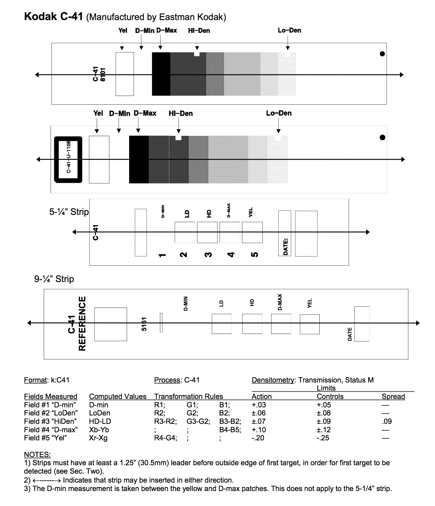

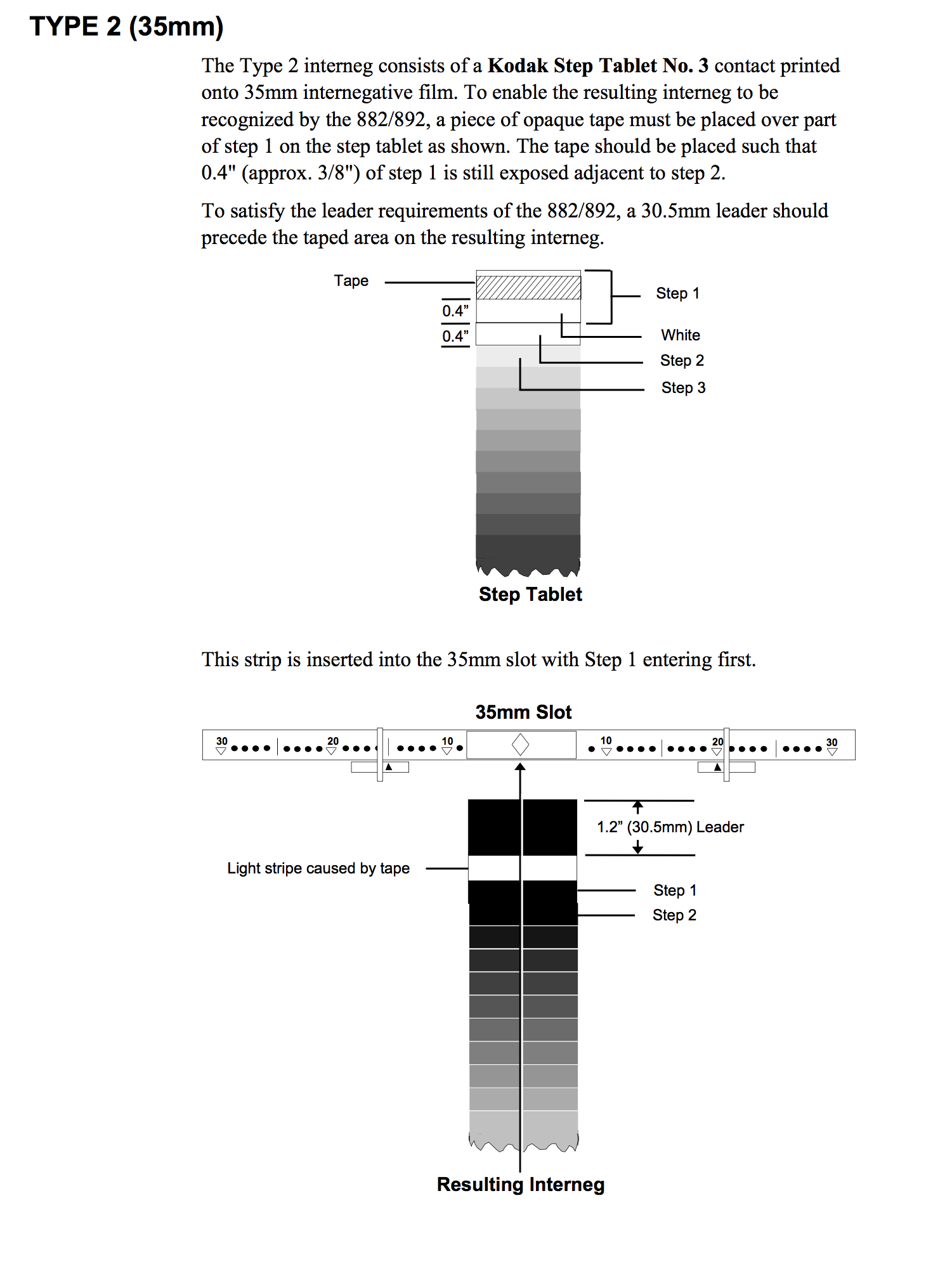

The main issue I have with my X-Ritge 880 is that it is very difficult for any of my 3 sensitometers to make the strips it needs. It is designed for commercial produced test strips.
It is not impossible, however. Do you have the manual?
This first example is the what is required if you want to try to create a commercially produced test strip:

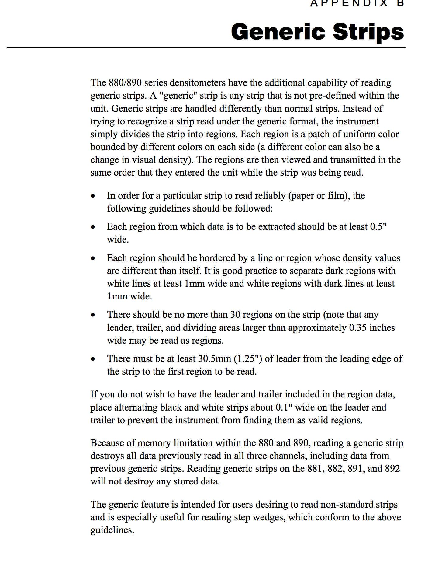

If you look in the back of the manual, it shows how to make your own test strip that the machine will read. Realize they are showing this to test INTERNEGATIVE film, as they assume all other negative material will be tested with the commercially available test strips. Of course that is not the case, so you would use this method to test ANY film, not just INTERNEGATIVE film. This is not clear from the manual, so I'm pointing it out.
Otherwise one could read the manual and think the unit is useless without the commercially produced strips.

Some more information on reading "Generic" test strips:
