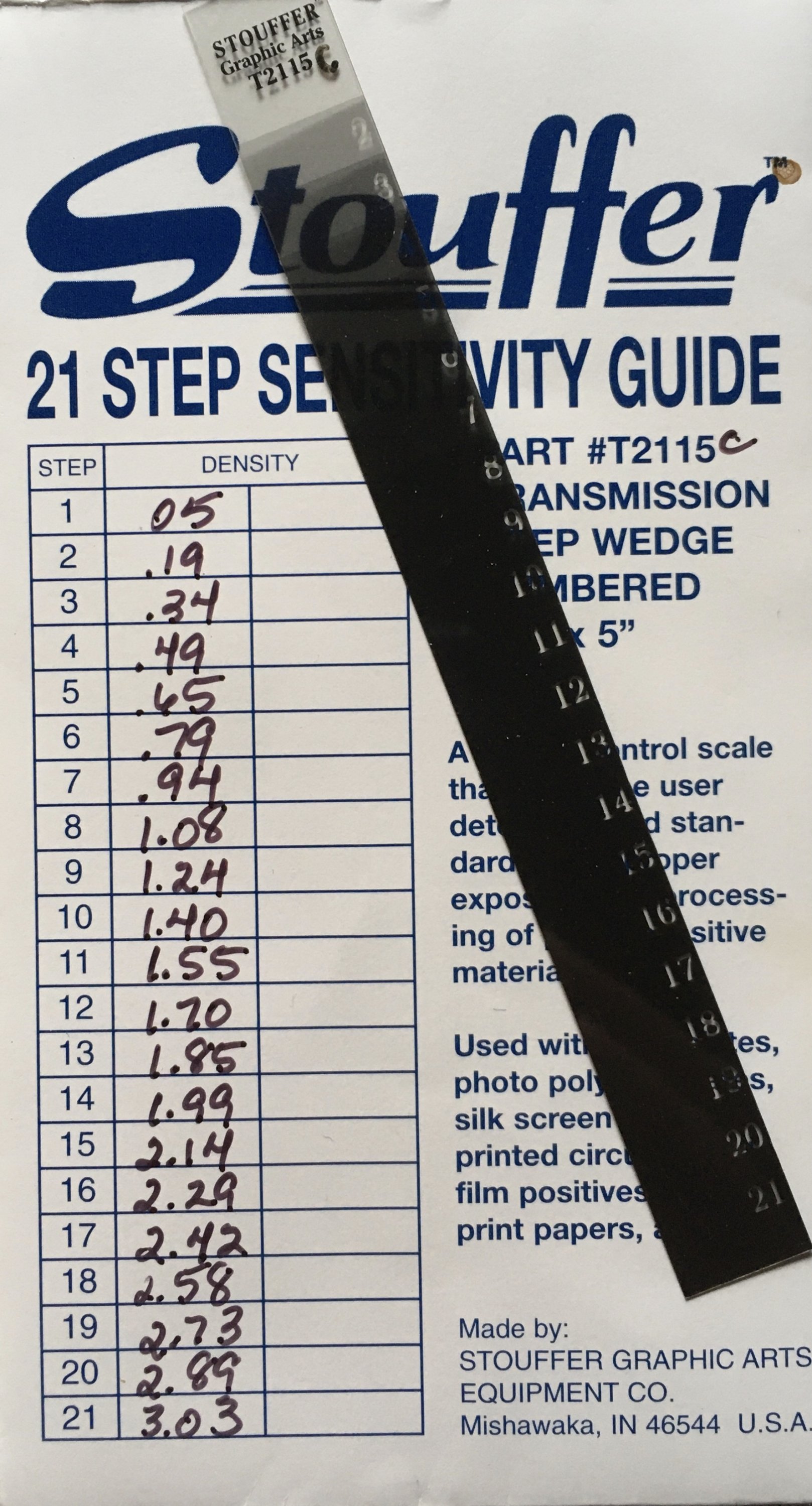

Here’s what Stouffer gives you. No RGB.
You could “always” send your current scale to “anyone” with a calibrated densitometer and they can write down some “new” numbers for you (or confirm the current values are still the same).

The Stouffer calibrated scale as is won’t have RGB readings that dkonigs wants.
They aren’t color patches, just different readings a properly-calibrated densitometer should give using the respective color channels. Anyone with a traceable-to-NIST calibrated densitometer can read the test strip, and write values on the envelope.
Stouffer maintains such a densitometer for the purpose. If you call and ask them they may give you a custom step wedge with the readings you are looking for. I called them once and got a custom strip they had “on hand” that I wanted for my EG&G, plus I bought several other strips and scales to give to my friends...
