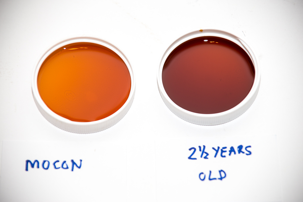

Although I relapsed to Xtol I kept my old samples from the Xtol Concentrate thread , stored in 1/3 full containers.
The Mocon has gone orange after ~18 months and the original sample that I tested for longevity in that thread has gone reddish brown after about 30 months.
Pics of them in white plastic containers, depth of developer concentrate about 2mm are attached.
Mark suggests that the coloration and emission of bubbles on shaking are not due to what I originally thought, oxidation of ascorbate.
This should baffle even the good chemists.

Following up on Alan's observations below: My bottles stored at room-temperature were about 85% full, and I doubt that such a small amount of air could cause all that liquid to turn red. I also had a few bottles with more air in them. The rate of yellowing/reddening remains appears to be constant regardless of the amount of air in the bottle, or whether the bottle has been opened a few times. These facts make me suspect that oxygen in the concentrate itself is the culprit. Sodium metaborate 8 mol contains a goodly amount of water, making me wonder if its oxygen atoms are moving elsewhere in a very slow reaction.
Question: Do PC-TEA and similar developers yellow with age? They contain no metaborate.
Two observations and a possible test:
  1. The color shown in Alan's posting strongly resembles the various stages of oxidation in Phenidone/Dimezone-S.
  2. I have had a bottle with 5% Phenidone in PG alone (i.e. no Ascorbate, no Metaborate) for quite a while and see no such discoloration. Either the color shown here doesn't come from the Dimezone-S, or some extra ingredient is needed (the Metaborate?)
  3. Does the light orange color go away if the concentrate is dissolved in water? The Ascorbate may not be able to reduce Dimezone-S in PG, but it may restore it in aqueous solution. Note that further oxidation stages of Dimezone-S may not be restored by Ascorbic, so a test with dark red concentrate may not reveal much. If that test shows that the light orange color disappears, we know that Dimezone-S gives that color and Ascorbate is able to restore it. If the light orange color won't go away, it may come from the Ascorbic acid.
If the orange Mocon is diluted to ~ 10% in water the color is virtually the same orange.
If ascorbic acid is added the color is lightened but still orange. It can be restored to the original by adding sodium carbonate.

I have had the orange color in an old glass bottle of 5x concentrate of Ryuji Suzuki's DS-12 which is metol (not phenidone)/ascorbate based so I think the orange color probably comes from the ascorbate.
The orange color doesn't show up in old Xtol because sulfite probably stops that reaction IMO.
I don't know what the orange compound is, but by all accounts it seems to be formed without air or with very little.
