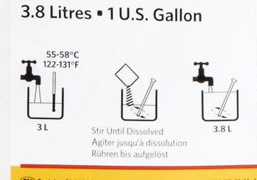

Hello
I am getting ready to try some D76, I know the first 3 liters need to be at approx. 125 degrees but does the last .8 liter need to be same temp or is room temp ok.

This thread is about mixing not developing and my package of D76 says mix 3 liters at 122 F. to 131 F. and then add .8 liter to make a gallon

I follow Kodak directions which are the same as Photographers Formulary directions for their version of D76, mix first 3 liters in warm water, 125 degrees F, once completely dissolved bring up to 4 liters by adding cold tap water.
Yes, just use tap water at room temperature. I always do this outside, it's a good idea w/ any powder chemicals. And let the D76 sit a day or so before using it, it will be a little too active initially.
If you use a filter funnel and pour between one large container to another, the bits that don’t dissolve easily in the first place, will dissolve easily in the last bit of water that you add.

at the start, the warmer temp helps to dissolve all dry chemicals better.at the end, room temp is OK because, the whole volume needs to cool down to room temp any way; D76 is used as stock, often !+1 and up to 1+3. see the MDC for starting dev times for your film.
D76 also supposedly is a bit more aggressive after being initially mixed (although I've never noticed it), so it's advisable to wait a day before using it. It really doesn't matter what temperature the last .8 litres of water is.
