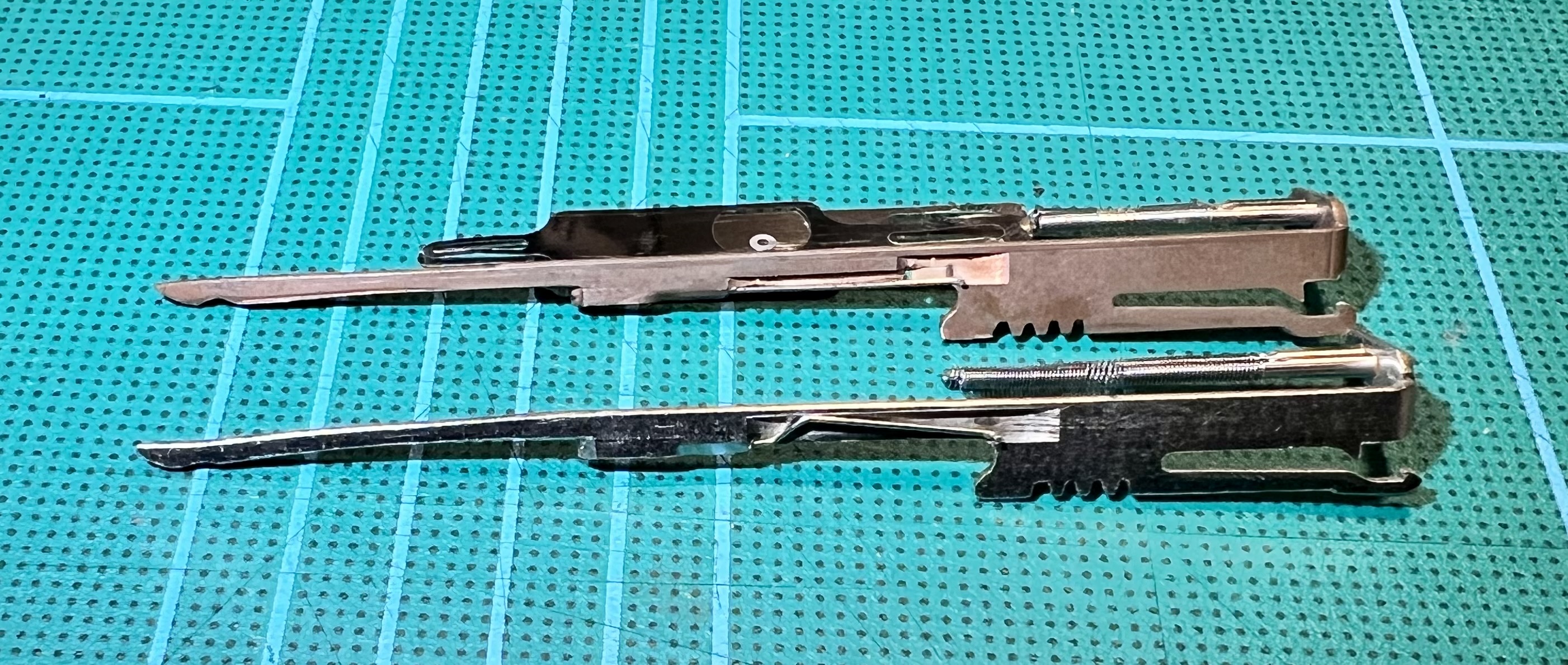

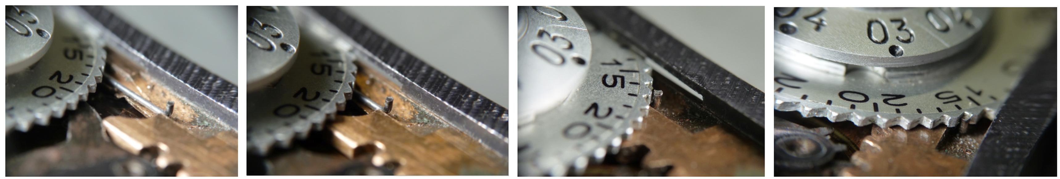

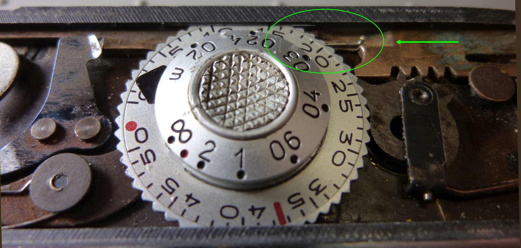

Repairing the frame counter was relatively easy. However, I had to open the camera again and pull out the tensioning rod and blades again to get to the spring.
When assembled, the tensioning rod moves to the left when the camera is pushed together. Shortly before the end, the hook of the spring engages in a tooth gap and thereby rotates the toothed disc by exactly one division. The spring slides upwards through elastic deformation in order to be able to follow the tooth gap.
In order to restore engagement with the toothed washer, I had to bend the spring slightly upwards.
View attachment 358617 View attachment 358618
Thanks! These are excellent illustrations! I was afraid of having to remove the toothed disc and focus knob and then deal with having to get all that reassembled without disturbing focus adjustment. This is much easier.
In fact, you don't even have to remove the cover. I took the pictures of an old Minox B that was completely open anyway.

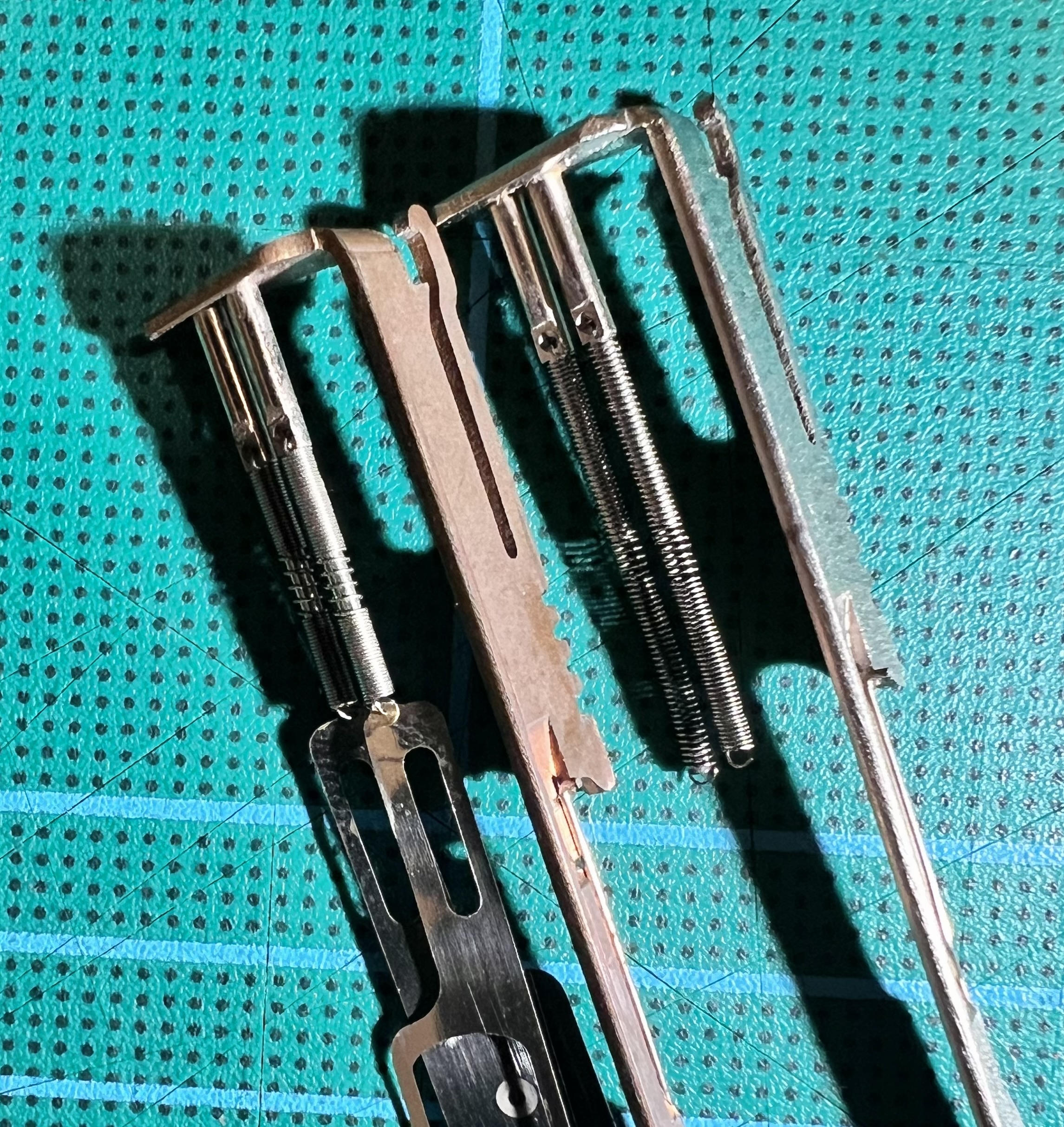

So I've just swapped the tensioning rod, springs, and shutter blades from a B into my IIIs with ruined springs. It mostly works, but I suspect there are small differences in the shape of the tensioning rod between the two models - when the camera is open, the shutter opening isn't perfectly centered in the case cutout. It's not enough to vignette, but it's visible, and with a little pressure it slips to half-closed, which it didn't with the original parts. (or i screwed something up reassembling, also possible)

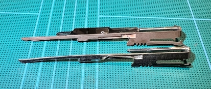

Sorry, I should have thought to take a picture before I put both tensioning rods back in the cameras they came from. But here is a picture of both tensioning rods side by side. The top is from the B, the bottom is from the IIIs. You can see they're shaped a bit differently, either by design or from wear. When I swapped them back, the IIIs shell opening aligns more exactly with the shutter opening again.
