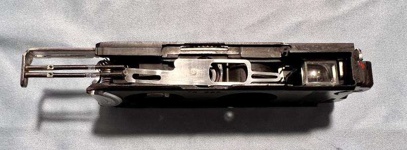

Does anyone have experience repairing a Minox shutter? I am in the process of changing the blades of a Minox A because they are blocked.
I opened the housing so that the guide of the blades is accessible. I was able to pull out the top blade, but the other one is stuck.
Does anyone have an idea how to get the blade out?

Yes, of course 😊
As you can see in the second picture, I have already pulled out one blade using the tension spring. I can't do the second one. Even if I pull the spring harder, nothing moves.

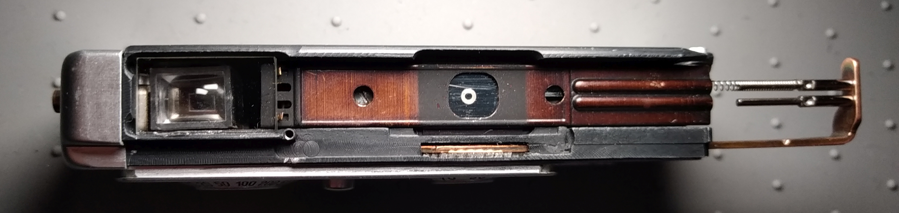

The blade with the engraved circle is the lower one, i.e. the one that points towards the lens.
Regarding your second question, do you mean this area?

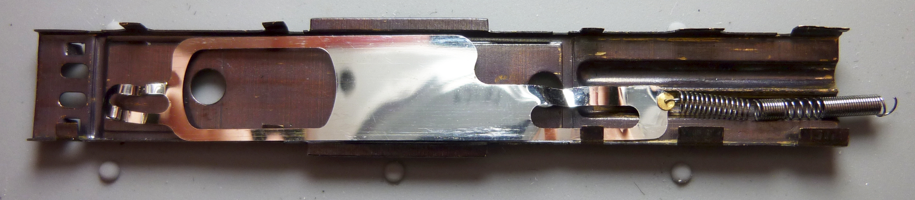

the connection between spring and blade never leaves the channel. In the following pictures you can see the blades in the position when the shutter is cocked. After triggering, the blades slide to the left.
Lower blade, cocked position:
Bothe blades, cocked position:

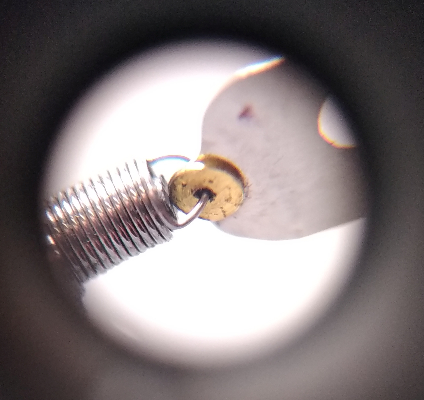

As far as the connection between blade and spring is concerned, I took another picture through the magnifying glass. It's all tiny.
Spring - blade connection:

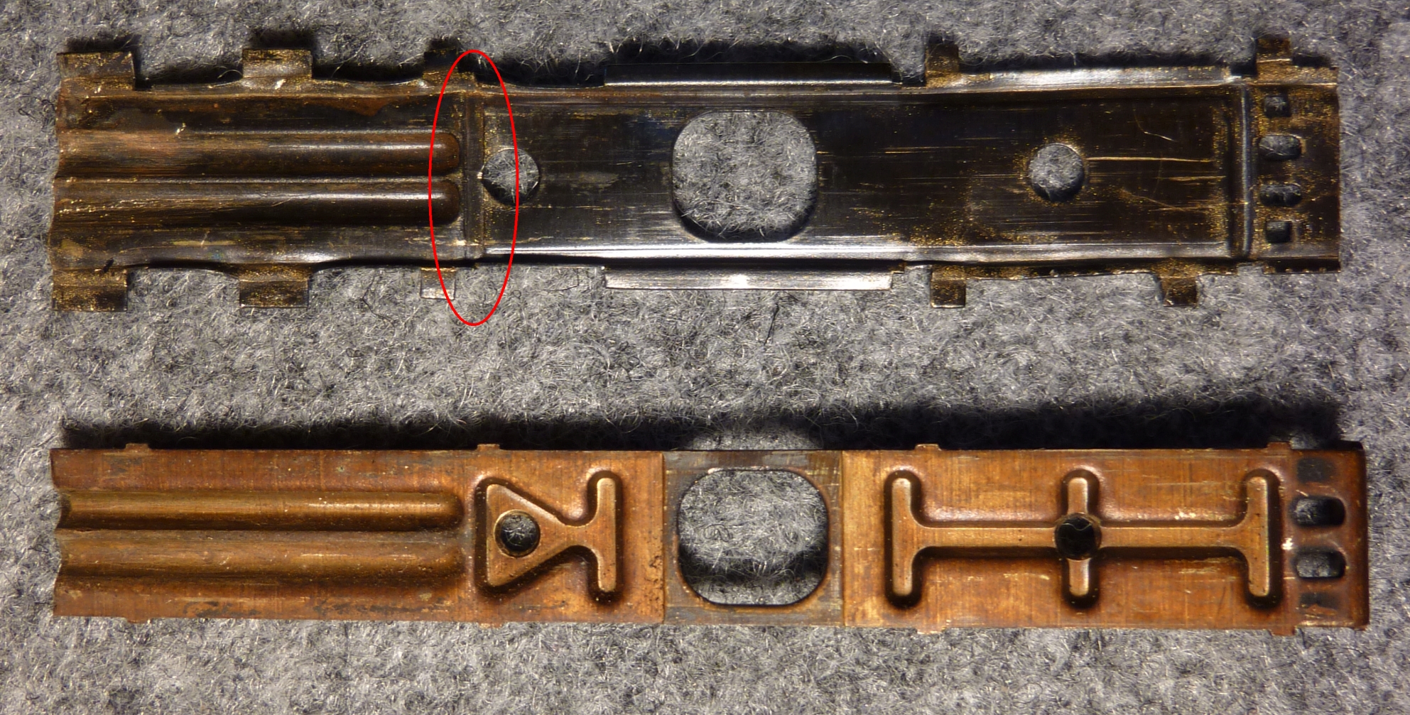

You have to get the screws out behind the two holes then take apart the channel they ride in.
Poke a hole in the blade to access the screws. When you take apart the channel be very careful with the tabs that are bent over which hold it together. Only bend them enough to get the blade out.

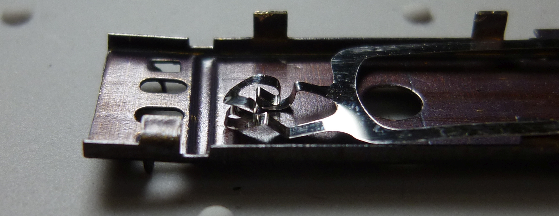

Patrick, thanks for the tip. I did it like this and now the damage looks like this (the damage to the right side only occurred when the screw was loosened):
I have no idea how that could have happened. My first thought was that the eyelet hit the retaining pin. But I checked that. When pushed together, the pin only goes up when the eyelet is pushed over it correctly. I simulated that. This is the position when the pin comes straight up:

Yes, both springs were intakt and and hooked onto the tensioning rod and the blades. The bumpers were in the springs. But I will use blades, springs, bumpers, guide plate and even the tensioning rod from the spare parts camera (a Minox B) so that the whole unit stays together.
Before the damage happened, I had fired the shutter several times. Everything went perfectly. Then suddenly the camera could no longer be pushed all the way together. After that one blade was blocked.
Maybe the end of the blade was bent ever slightly and got stuck in the groove:
But I'm not entirely convinced...

That looks as if maybe the shutter was cocked somehow without the blades moving all the way into position to be trapped by the actuating pins, and then it was opened and pushed closed a second time, forcing the ends of the blades into the extended actuating pins. I have no idea how that would happen, though - I guess it shouldn't be possible.
When repairing mine, assuming the donor's shutter is working, I'm inclined to replace the entire cocking slide, springs, and blades as a unit (and maybe even the channel assembly), because I don't feel great about hooking and unhooking the ends of the tiny springs without damaging them or bending the blades, or getting oils or grease on them.
I've tried it many times now. The actuating pins only come up when the blade eyelets are in the correct position. After installing it, I will try it out more often without the front panel. Then I can close slowly and carefully and see if the pins are working properly.
