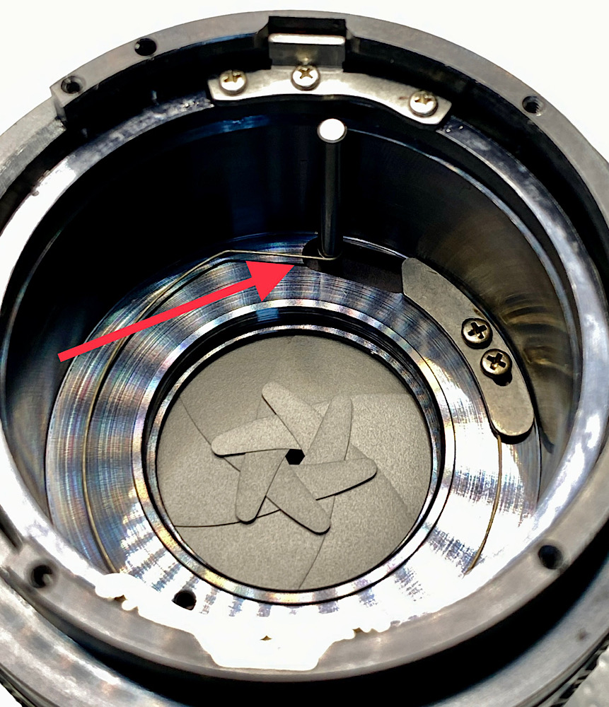

So that the aperture blades are not held under tension, I unhook the relevant spring.
Then I fix the aperture lever with adhesive tape.
So when working on the lens through the aperture opening, the aperture blades are protected from a snapping "aperture trap" that could bend them.

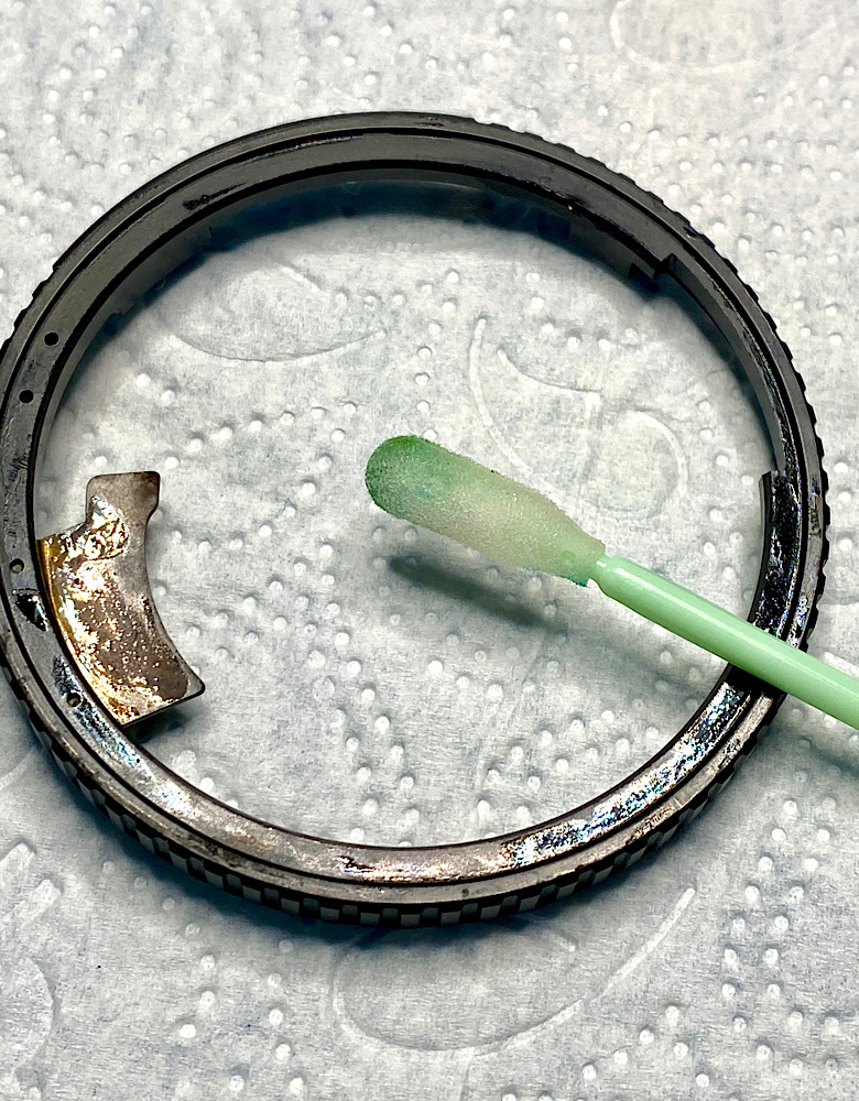

At the same time, cleaning work on the tube with foam swabs in isopropyl alcohol.
I don't know whether this is greenish old grease or glue, but it has no apparent function here.
So get rid of it.

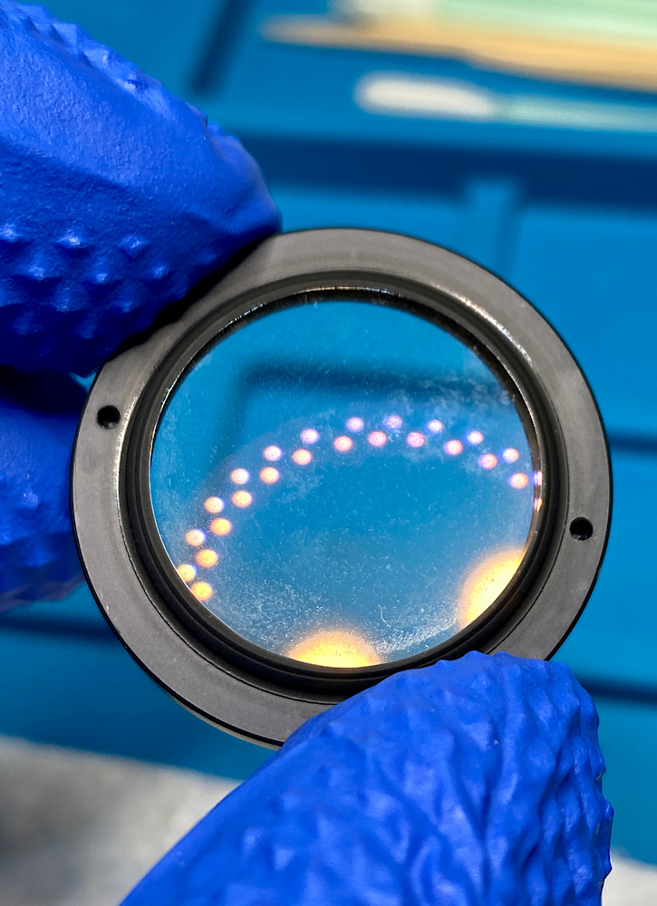

  • Cleaning with surgical spirit is not that easy. On the one hand, it removes greasy things very well, but occasional fine streaks can remain. Reworking with a cotton swab moistened in little surgical spirit helps.
  • When checking with the LED lamp, even the finest cleaning marks (streaks) can be seen, but these are not visible in bright, diffuse light. There was also some dust. I might have been able to remove these fine streaks with the lens cleaning cloth, but I want to work as little as possible on the inner lenses because their coating may not be as robust as that of the outer lenses. Instead of continuing to clean here, I accept the fact that I'm not working in the clean room. In any case, I have to look very closely in the LED light to find these irregularities. In some cases the dust reflects the light more strongly. Completely unimportant in practice and only gets attention here because it is an issue.

Of course I opened the lens again to remove the last mini streaks.
It worked quite well with isopropyl alcohol, so I first applied it generously with a cotton swab, blew it off a little and then wiped it off with a dry swab.
This worked for the lens in the tube that I worked through the aperture.
Unfortunately not for the first one from the beginning as the cotton swab made scratches on the underside.
So far, all the lenses that I have cleaned in lenses have been robust, and no scratches occurred during cleaning. This one was soft on the bottom.
Since then, every lens in an objective that I clean, I carefully check it with the pointed probe to see if it is scratch-resistant.
