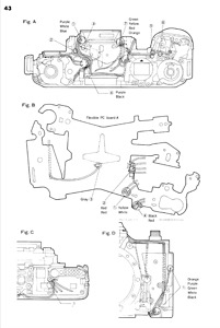

Overview of the soldering work (p. 114)
The instructions in the service manual refer to this page

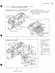

Mirror box assembly installing (p. 124)
Detailed step-by-step instructions with illustrations
Not all steps are listed here, they are given in the disassembly section, so refer there.

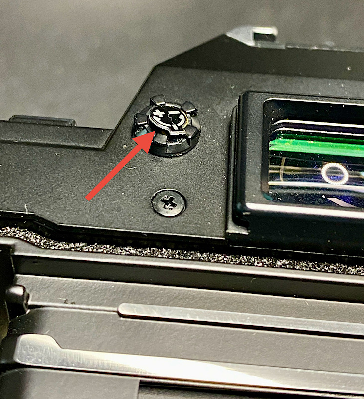

The screw underneath fixes an electronic contact between the top cover and the circuit board and must not be lost.

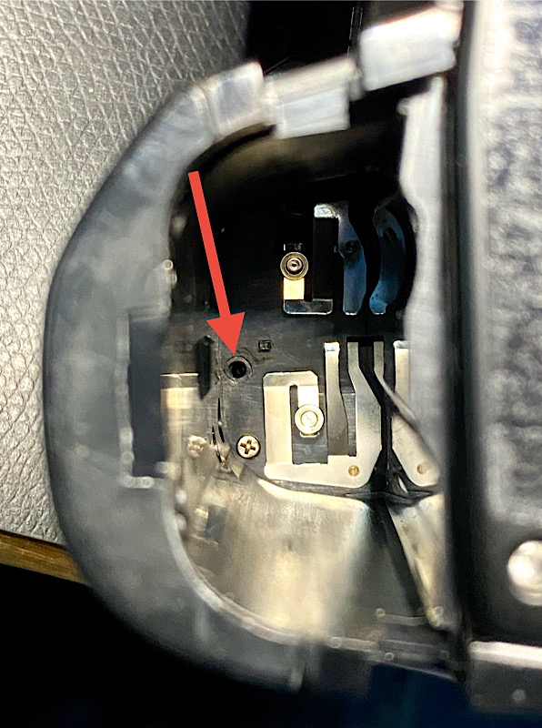

One of the retaining screws for the top cover is located in the battery compartment.

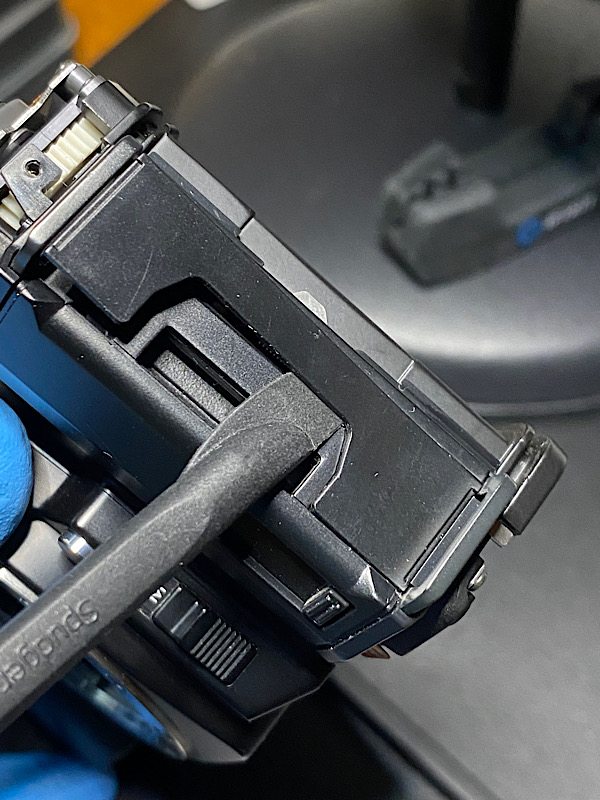

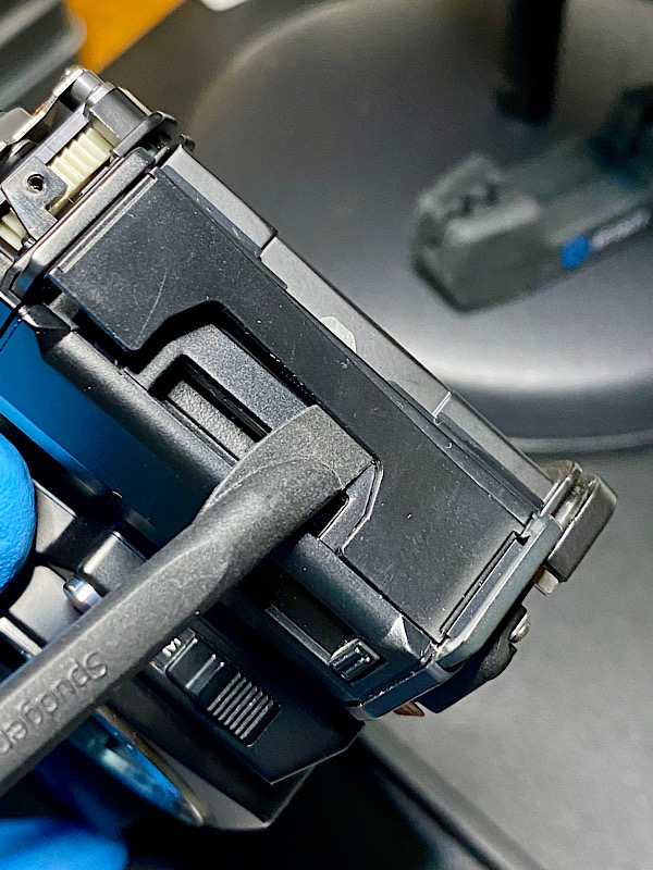

The side covers are glued on and can be carefully pried off.

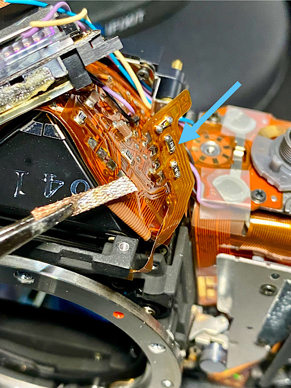

Such solder joints can be easily separated using desoldering braid. Flux and brief, strong heat from a wide soldering tip help with this.

Document all cable positions for later assembly.
Among others this light grey cable is mentioned in the desoldering instructions. It runs under the upper circuit board and is difficult to find.

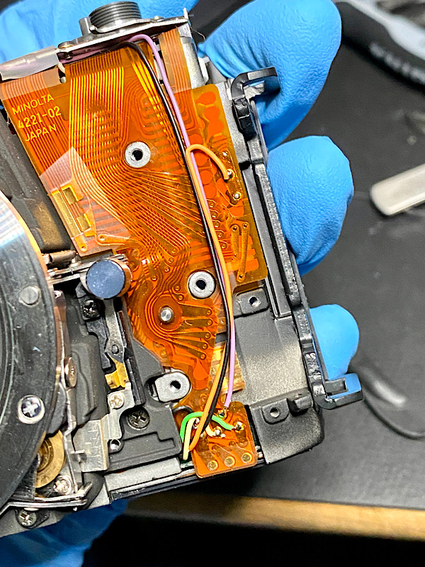

Another circuit board connection needs to be desoldered at the bottom of the camera. It is fixed with three soldering points; it helps to desolder the surrounding cables first.
I also saw a second version of this board with different cable positions.

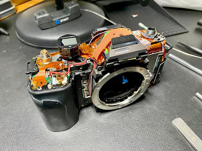

Before and when lifting the mirror box out of the housing, make sure that no cable has been overlooked when desoldering and that the circuit board connections on the bottom and both sides of the housing are free.
Also pay attention to the charge lever if it is still installed.
If everything fits, the mirror box can be lifted out without any effort.

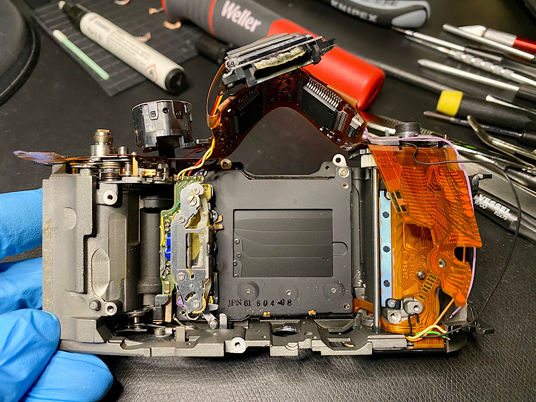

Overview mirror box …
… and housing.
Now various repairs and service can be carried out.
For example, removing the sticky damper from the shutter unit or replacing it, cleaning/replacing the aperture magnet, removing blockages in the mechanics and more.

When reassembling, the mechanics of the mirror box and shutter must be tensioned, see the service manual.
Reassembly is then carried out in reverse order.
There are instructions for this in the service manual, but they are incomplete. Therefore, consult the disassembly instructions.
