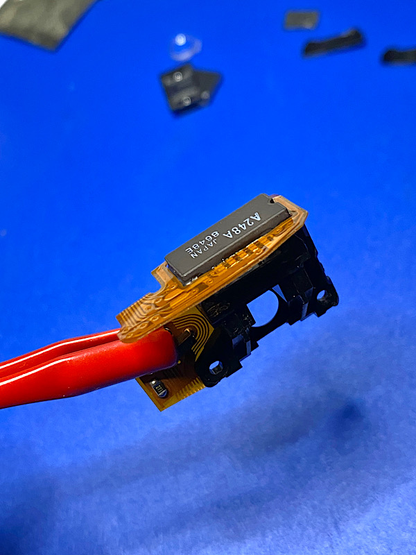

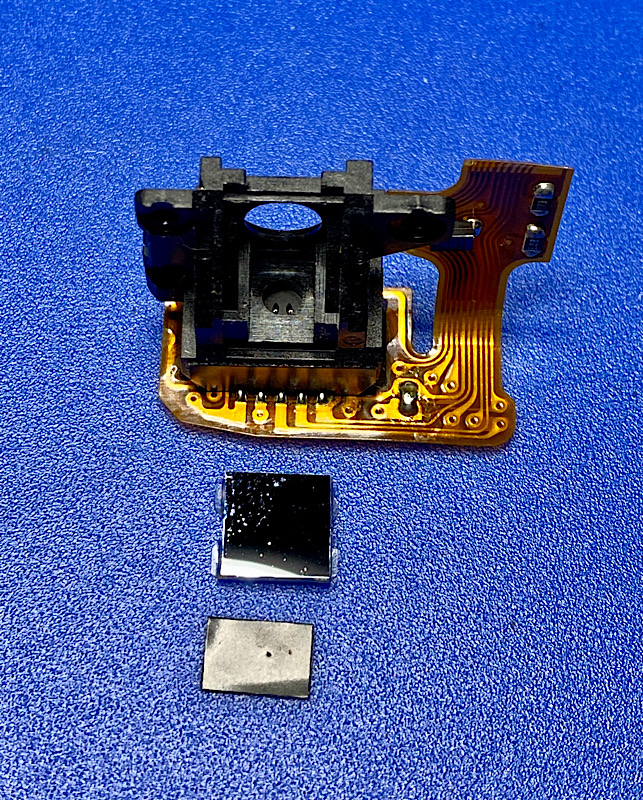

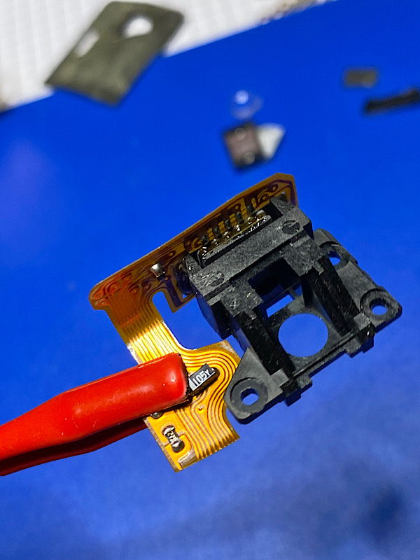

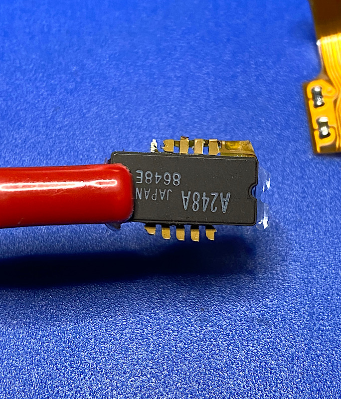

Dissection: Excursion to the CCD sensor

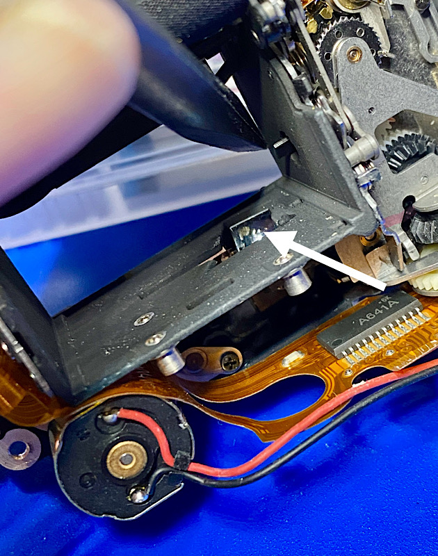

I took a look at the structure of the CCD unit on a spare part 7000.
Separated mirror box, the arrow points to the CCD unit on the bottom.
The CCD unit is attached via springs with three adjustment screws.
On the left the AF motor.
Green arrow: opening to the CCD sensor.
White arrow: part of the prism of the flash receptor.
The auxiliary mirror, which is movably mounted under the mirror.
Opening in the main mirror.
Rubber cover plate removed from the bottom of the mirror box.
Screws, springs and washers of the CCD unit.
The CCD unit is now only connected to the flexible circuit board.
Separated with cut circuit board (as a dissection for our study purpose).
Further disassembly, the condenser is exposed.
Deflecting mirror that directs the light from the auxiliary mirror above to the two mini lenses in front of the sensor.
Deflecting mirror removed.

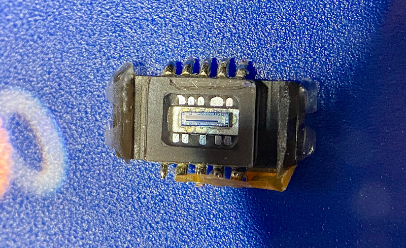

Overview

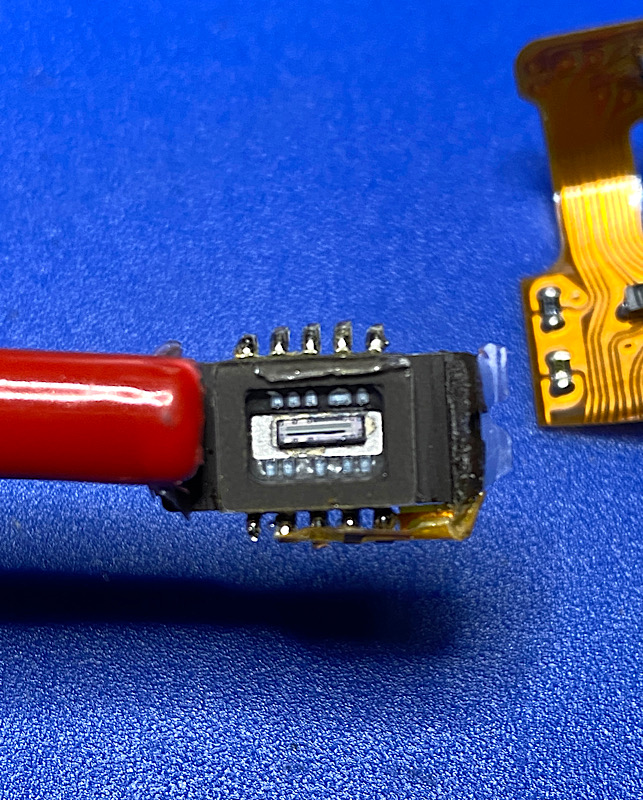

The sensor (in the middle) is exposed and separated from the board.
The mini lenses in the middle of the housing which project two images onto the CCD sensor.
The sensor is part of an IC (IC7).
Close up of the sensor.

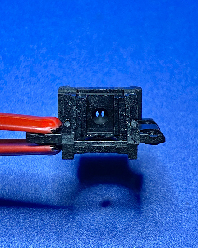

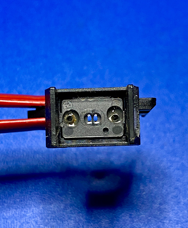

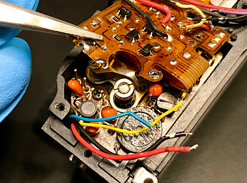

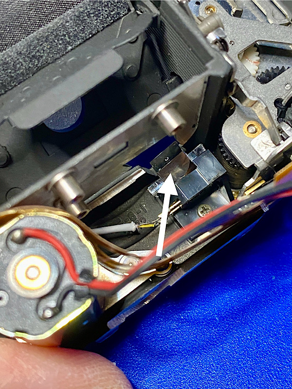

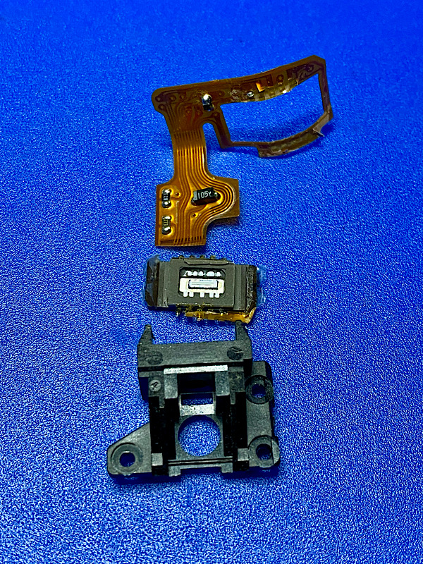

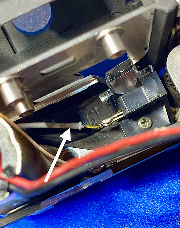

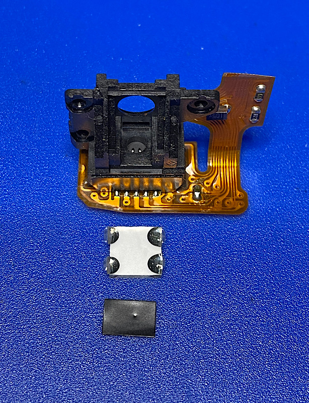

Flash receptor
With this sensor, the camera measures the light reflected from the film and switches off the flash when the amount of light is sufficient (TTL flash control).
The flash receptor in the bottom of the mirror box is connected with a double-core cable to …
… the circuit board above the prism.

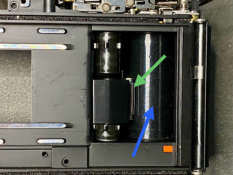

A secret revealed: Film-detecting switch SWSLS
The Minolta 7000 AF has several internal switches that connect the mechanics and electronics.
One of these is the SWSLS switch, which allows the 7000 to recognize when film is loaded and when it is rewound by the inbuilt motor.
This is not a switch with a button for human activation, but rather the combination of the film pressure roller (green arrow) and transport roller (blue arrow) made of conductive rubber forms the switch.
If no film is fed in, the switch closes. The film pressure roller and transport roller are in contact.
The resistance between the rollers can be measured with an ohmmeter. It is around 8 to 15 kiloohms. Current can flow here.
When film is drawn in, it lies between the film pressure roller and the transport roller. The film strip acts as an insulator and separates the contact.
The switch is open and the connection is high-resistance. No current can flow.
If the film is rewound after exposure and the last piece slides out between the rollers, the contact is closed again. The motor switches off.
This system allows the 7000 to recognize the different states and control them.
Overview
Flash receptor
The measuring cell for the TTL flash exposure control in the bottom of the mirror box. The prism is attached.
