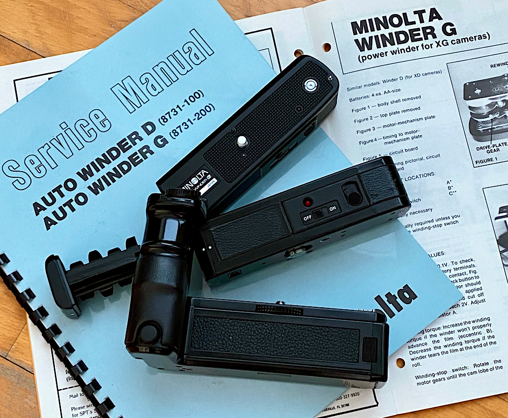

My next main project will be service and repair for the Minolta Autowinder D and G as well as the Minolta Motor Drive MD-1.
The topic follows on from my previous work and articles on Minolta X here.
The D Version is for Minolta XD, the G version for Minolta X/XG and the MD-1 for Minolta X/XG-M.
Well-used and sometimes faulty
The winders are often offered in well-used condition and either show complete failures, malfunctions or resinous gearboxes.
Of course, corrosion damage caused by leaking battery acid is also a common issue. The fate of many devices that are no longer used and whose batteries have been forgotten over the decades.
Strong but also vulnerable partners for Minolta XD and X/XG/XG-M: Minolta winders G and D and Minolta Motor Drive MD-1

Here we go!
Several Minolta winders and motor drives are waiting to be checked, serviced and repaired.
Here I will be sticking closely to the Minolta repair manual, as it shows details about the mechanics and electronic circuitry of the winders that are - still - understandable.
In contrast to the associated X-cameras, whose electronics are already highly integrated and therefore remain largely unknown.
With the winders, I suspect primarily electrical contact problems and of course damage caused by leaking battery acid.
In any case, a nice project that will be thematically rich 🙂

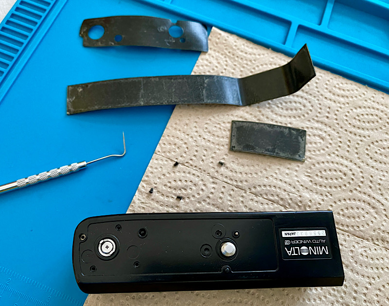

Removal of the self-adhesive leatherette.
Now the screws underneath can be loosened.
The upper cover plate is additionally fixed with two clamps.

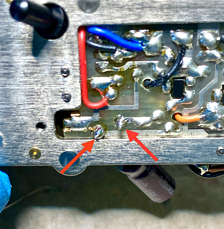

The cover plate can now be removed. The underside of the circuit board is exposed.

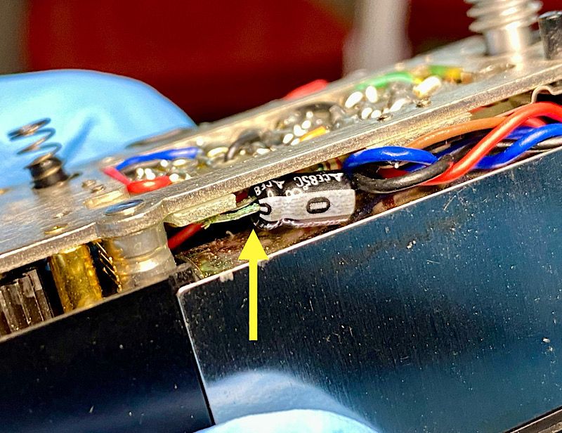

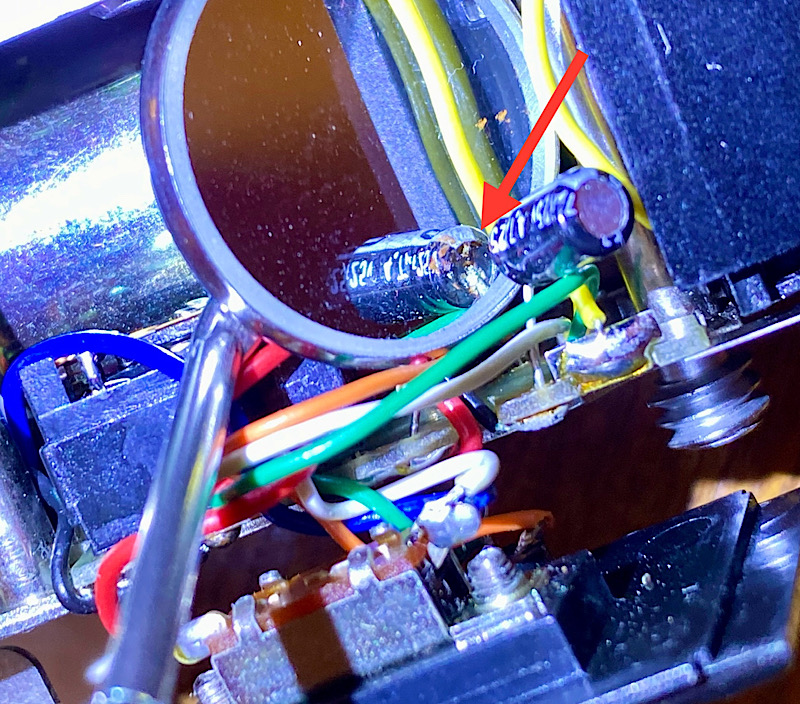

This electrolytic capacitor is leaking. Leaked electrolyte is visible at its terminals. It must be replaced.
The two common soldering points of the electrolytic capacitor, together with a resistor.

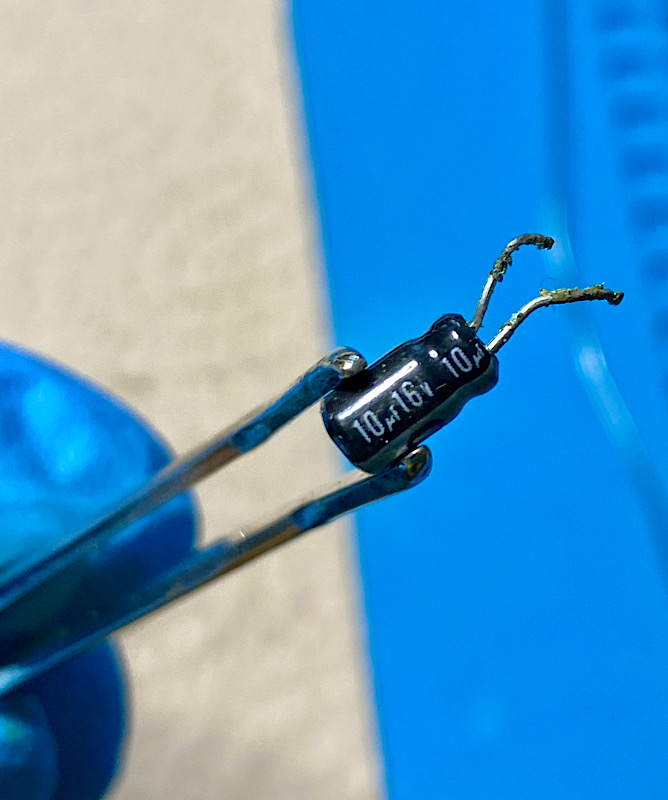

All set to desolder the leaky electrolytic capacitor.
Here it is.
I'm sure I can find a replacement in my stock.
In the foreground the battery contact plate.
I have a 10uF/35V electrolytic capacitor in my stock instead of the original 10uF/16V. This will work.
However, the replacement is larger. I hope the new capacitor fits in the housing.
Fitting …
… soldering the contacts into the circuit board …
… bending in position - done.
The new electrolytic capacitor fits. The polarity is also correct.

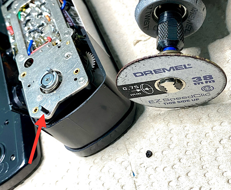

I replace the missing pin with a screw. I cut off the screw head with the Dremel.
I use the Nejisaurus pliers to adjust the height of the screw that makes contact with the camera.

During further tests, the winder stopped and the red LED lit up. At first only sporadically and now continuously.
So I started troubleshooting again and found that the second electrolytic capacitor had also leaked.
One of its terminals on the circuit board is completely corroded and I was able to pull it off with tweezers.
This probably also explains why the winder did not run continuously during the short circuit test at idle, but only in steps. I also attribute the occasional interruptions I have already noticed to this.
Obviously it wasn't switch S 21 that was causing problems after all.
Finding a replacement for the electrolytic capacitor will be exciting; its nominal value is 4.7 uF/25 V. I'll see who offers it.

The problem with the leaking electrolytic capacitors in Minolta's X-System
I have a second Minolta Autowinder G here, which - after a very long period of inactivity - worked and then also ran non-stop.
And years ago, two of my Winder Gs stopped working for no apparent reason.
If this second Autowinder G also has leaking electrolytic capacitors, then the cause for the failure should be clear.
I'll take a look at it today and wait for the replacement capacitors that I ordered.
This means that the winders are part of Minolta's electrolytic capacitor problem, which is known from the contemporaneous and related Minolta X cameras. But the solution by replacing is relatively simple.
Based on previous experience, I would only replace the electrolytic capacitors in the Autowinder G if malfunctions occur. The leaked electrolyte can be removed from the board without causing further damage.
