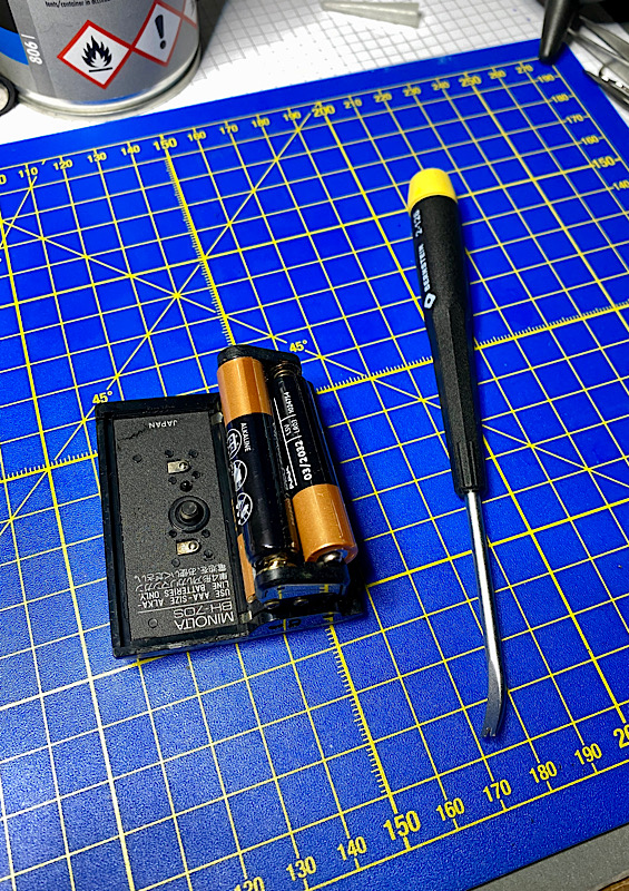

Test with batteries: 4 x AA and 4 x AAA
Both battery holder types each deliver identical output voltages, which are plausible.
Remove the batteries from the battery holders without damaging your fingernails.

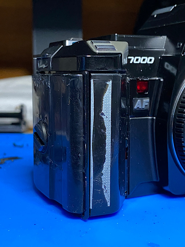

Removing the decomposing plastic coating on the battery compartment BH-70S and handle
The plastic coating on the battery compartment for 4 x AAA batteries as well as on the handle of the 7000 can crack and break off.
Reconstructing the gaps with Sugru only partially solves the problem, as it does not fix the remaining plastic.
As with the Minolta 9000 AF, the plastic coating can be easily removed. This should not affect the functionality of either camera.
I removed the plastic from one of my 7000s with a BH-70S battery compartment.

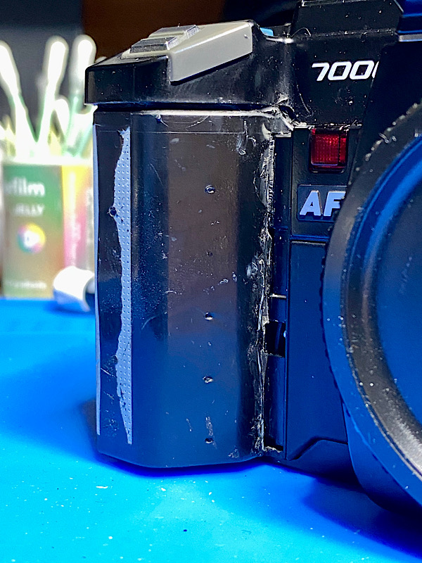

The three spudgers from iFixit are ideal for this job. They are made of plastic and allow for gentle removal.
The plastic parts can mostly be removed quickly and without effort.

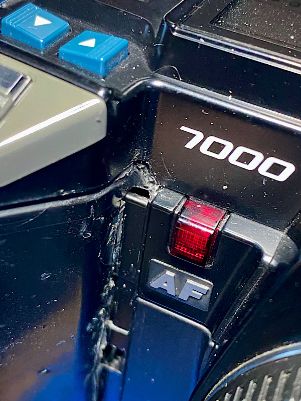

The handle of the 7000 without plastic cover.
Direct view of the circuit board. I will cover this hole with Sugru.
There is also plastic inside the battery compartment that can come loose. Here you can also see the circuit board, but this has no further effect as the battery holder is located here.
Here, too, there is a gap that can be closed with Sugru.
What remains is - depending on your point of view - a cosmetic problem.
I'm leaving my 7000 in its original condition and will not make a new cover.
Plenty of plastic waste.
Another small optical improvement.
I recommend wearing safety glasses when working, as the plastic parts are brittle and have sharp edges and can fly off when lifted off.
