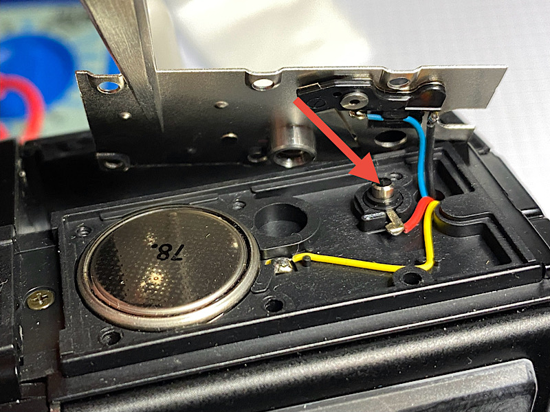

The battery plate in the handle of the 7000 after I removed the battery holder (screws are already loosened).
6 x JIS 000 cross-head screws
The two cables with the contacts to the main batteries are soldered to the plate.
1 x CR2016L
The battery has an overvoltage of 3.25 volts, as if it had just been installed, new and unused.
That's unbelievable, because it is constantly under load when the main batteries are not inserted.
And I don't think that this 7000 was stored with batteries inserted.
Remains of crystallized battery electrolyte in the battery holder suggest that there hasn't been any voltage here for a long time.
I also don't believe that the memory battery has been replaced.

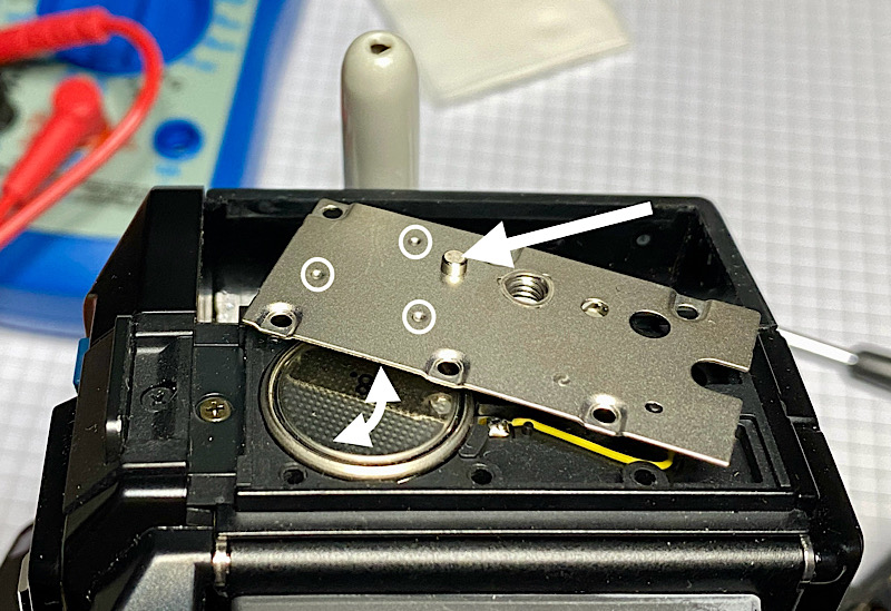

Insert backup battery with correct polarity
After inserting the backup and main batteries, all LCD displays flashed for a few seconds. I turned the camera on but it didn't respond to any inputs.
I cleaned the contacts on the battery plate, inserted the backup battery with the polarity reversed, again no response.
It worked the third time, probably a contact error.
Since the backup battery fell out when I removed the battery plate, I couldn't determine the correct polarity, and there is no marking.
But the polarity, i.e. how the battery has to be inserted, is determined by the contacts on the battery plate and on the main batteries holder:
The straight arrow points to the negative connection of the main batteries holder, whose potential is identical to the potential of the battery plate (ground).
The three white circles mark the contact points for the backup battery and are also grounded. This means that the backup battery must be inserted with the positive pole (engraving) facing downwards.
The double arrow symbolizes the connection between the negative pole and ground.
Here you can see the bottom of the battery plate. The red arrow points to the positive connection for the main batteries holder.

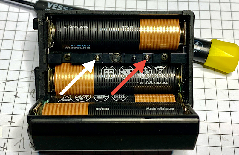

The connections on the main batteries holder confirm these considerations.
  • white arrow: negative connection,
  • red arrow: positive connection,
  • polarity determined with the multimeter.
I removed the backup battery again and reinserted it. This time it worked perfectly. Again, all the displays on the LCD flashed for a few seconds.
The open circuit voltage is now 2.42 volts (-0,83 volts) probably the measurements put a significant strain on the battery (rather unlikely) or I short-circuited the battery with the tweezers or its capacity is fragile. Whatever.
In any case, the backup battery maintained the previously set ISO value after removing the main batteries. Whether it continues to do so is irrelevant, as I will anyway be replacing it.

Main batteries
There are two battery cases for the main batteries:
  1. BH-70S for 4 x AAA and
  2. BH-70L for 4 x AA, which also offers an enlarged handle.
Here you can see the battery cases that came with my 7000.
All of them show corrosion on the contacts due to battery electrolyte.
The big advantage of both battery cases is that leaking batteries do not come into direct contact with the battery contacts on the camera.
This protects the camera electronics behind the contacts from damage that can only be repaired by dismantling the camera.
I remove the corrosion in the battery compartments with a bath in Durgol descaling solution.

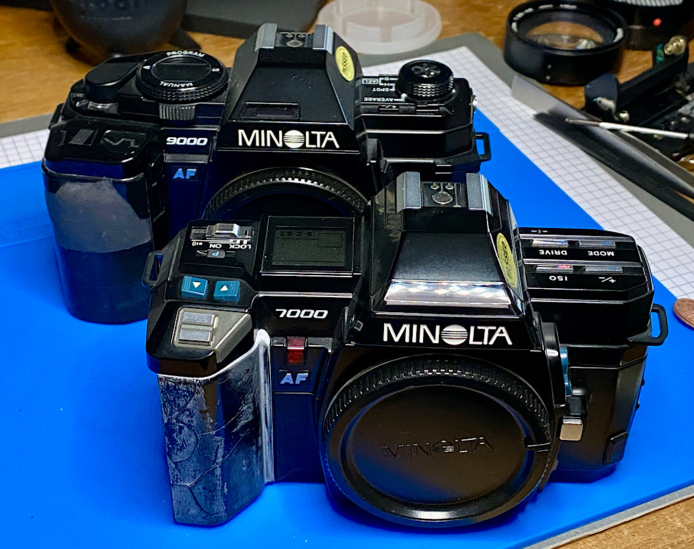

Minolta 7000 AF or Minolta 9000 AF?
Apart from the capabilities of both cameras, I would choose a 7000 when it comes to being ready to take photos.
Apart from a defective aperture control and external LEDs that occassionally are running out („bleeding“), I am not aware of any other typical weak points with the 7000.
The 9000 suffers over time or occasionally from a sticky shutter, a defective aperture control, misalignment of the mirror, a blocked shutter and virtually all external LCDs are affected by bleeding.
Repairs, except the misaligned mirror and external LCD, are only possible by removing the mirror box, see current threads.
Both Minolta sisters suffer from disintegrating plastic parts on the housing (grip surfaces).

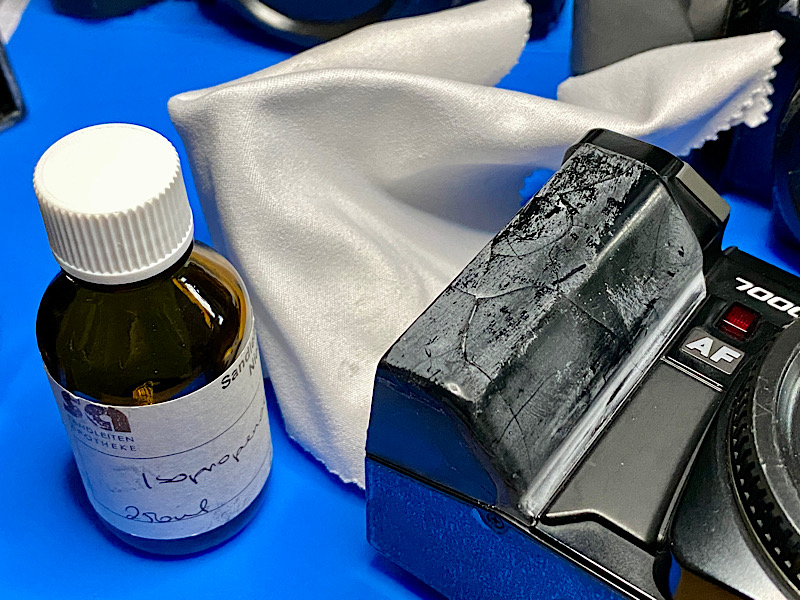

Coating on the handle, sticky and disintegrating plastic
The whitish coating can be wiped off best possible with isopropyl alcohol, which also reduces the stickiness.
Plastic parts that break off on the handle can be glued with Pliobond.
Missing parts can be recreated with Sugru:
