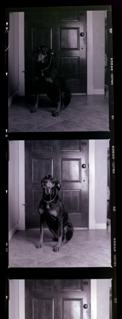

Here is the example as mentioned above.
Top one is 1/500s
Sec one is 1/60s
Third one is 1/60s (cut off)
Digital capture of film on light table. I set the white and black points on the 2nd image.
Top one is 1/500s
Sec one is 1/60s
Nice dog.
Soft box high and camera right?
So first look at the shadow between the dog and the corner, that would be a very tough spot for the flash to fill given your setup (running the soft box horizontal instead of vertical would fill that spot better and allow the light to go up closer to the ceiling). Second look at how the soft box reflection on the door remains constant relative to the rest of the door. Both get (roughly) equally brighter.
These types of indicators are normal for fill flash because you aren't relying on the flash as the main light, ambient has to help get the whole exposure up to normal.
That isn't a flaw, that's the point of fill flash. Allowing ambient light to carry a good share of the load can make for a more natural looking shot. The fill is just there to help.

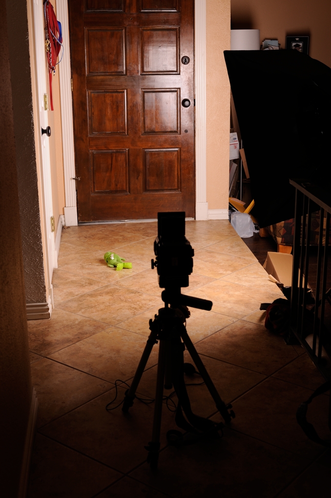

D700
50mm 1.8G
ISO 200
1/60s f/6.3 (what the light meter read)
As you can the softbox has a lot of spill, so the entire corner is lit. The camera and tripod are in the dark. The camera and tripod are actually closer to the ambient light than the door, so you can see there is no ambient light that made it's way into the shot.

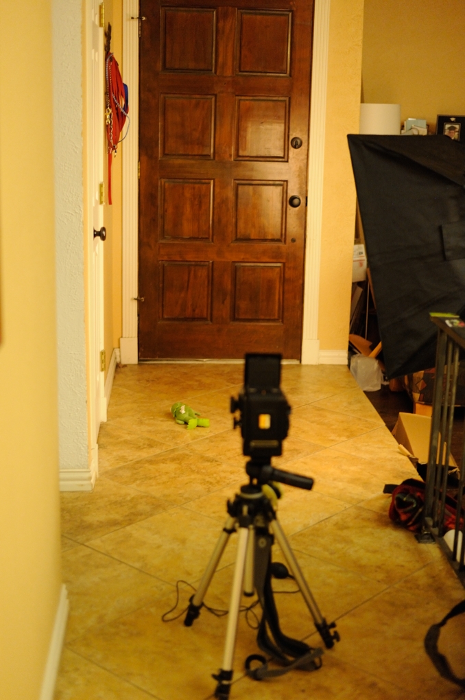

I've attached a 2nd photo that's 100% ambient.
ISO 3200
1/60s F/1.8
It's pretty dark in here (as far as photography is concerned).

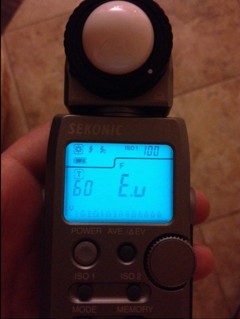

So, at 7pm, I turned on the light like it was on that night and took a meter reading. @ 1/60s, I got "E.u" (see attached photo)
It would require a 6s shutter @ f/6.3 to get proper exposure with this ambient light.
