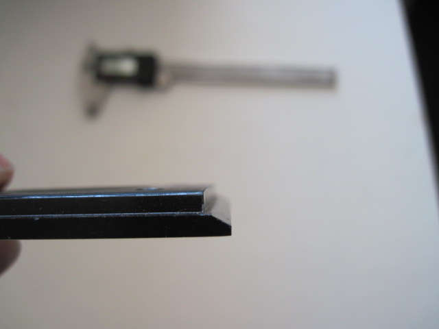

I have a Mini body from 1941 and it has a Bakelite lens board. I received a lens/shutter/lens board from ebay in non operational condition yesterday, it too is for a Miniature Speed and the board is made of Bakelite.

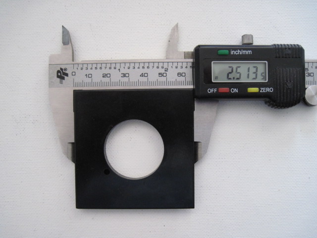

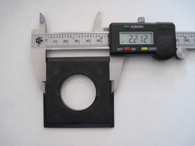

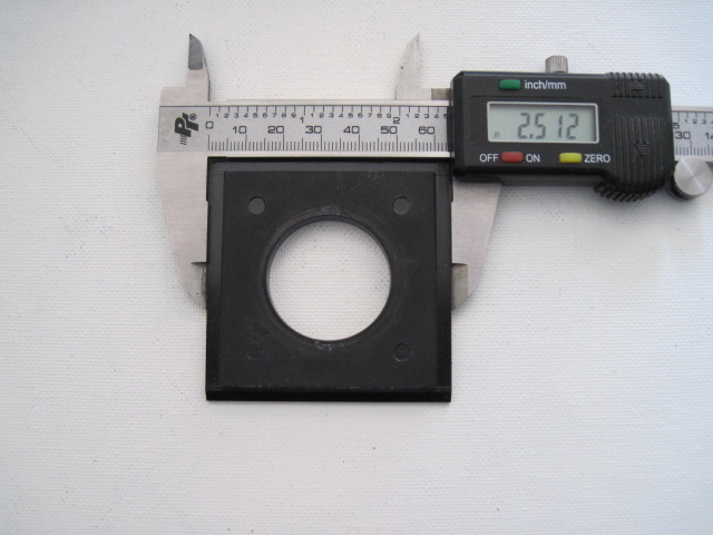

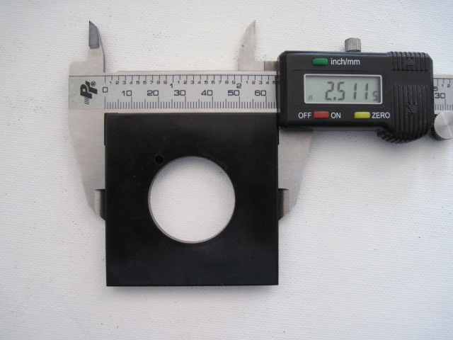

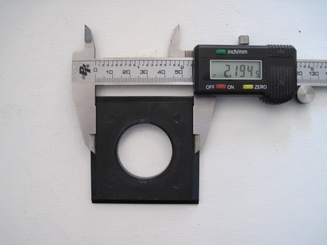

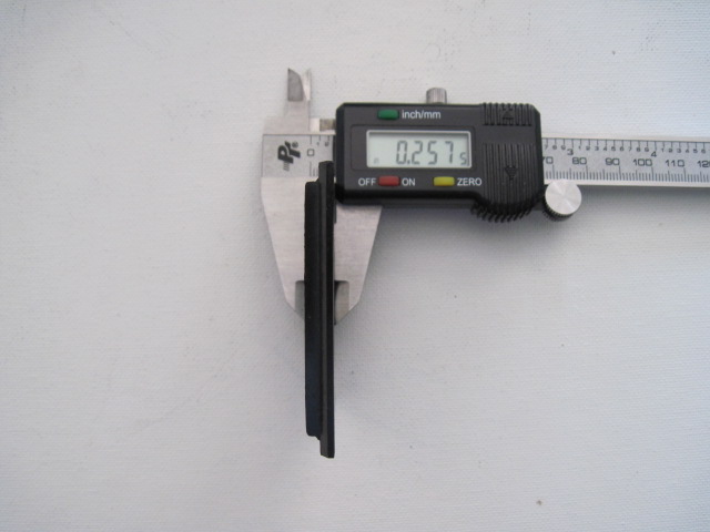

Graflex used engineers rule to lay out their cameras so all measurements are in inch, tenths, hundredths, thousandths.
IMG_0148[1].JPG IMG_0149[1].JPG IMG_0150[1].JPG IMG_0151[1].JPG IMG_0152[1].JPG IMG_0153[1].JPG IMG_0154[1].JPG
The pictures are: front left right measurement, top bottom measurement, rear left right reference, rear left right inner measurement, rear top bottom inner measurement, total thickness, bottom edge bevel. The top, left, and right, lip edges are .16 inch, the bottom is .162 inch. ($20 digital caliper)

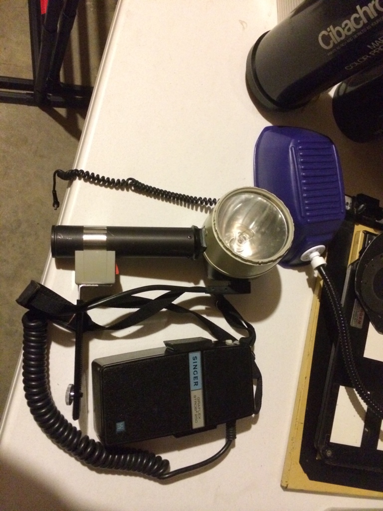

I will have to read up on sink times again, I know there was like I, and an M, and an X (which became the standard) but I've forgotten which is which, I don't really want to have to deal with flashbulbs, I know I know, honestly it's just a big pain in the ass, and I don't want to have to deal with it, I do have a GRAFLEX flash that takes a massive battery that you probably can't get anymore, I wish they made some kind of adapter for C batteries or something...
It's a strob 250
I also actually have a flash strobe thing that takes flashbulbs I believe somewhere, and I have a few flashbulbs lying around in various sizes, but I'm really not interested in even using them but maybe once for a fun model Photoshoot sometime, and I don't even know what goes with what.

Thanks shutterfinger, I'll have to see if I can find the actual flash head.
Now what about studio strobes? If I hook the sync cable to the Profoto strobe? Those seem to "burn" longer..?

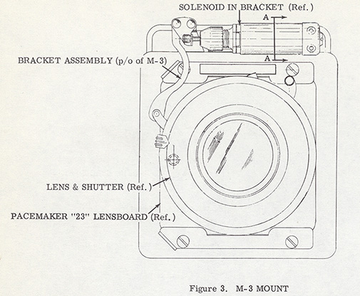

This is the solenoid mount for a 2x3 Pacemaker. The solenoid mounts on the top of the board. When energized the lever is pulled back pushing the rod down tripping the shutter.
Such is needed to use the leaf shutter on your camera with flash bulbs. If the shutter had flash sync terminals then electronic flash could be used but you would still need a 2 or 3 cell synchronizer to trip the solenoid.
