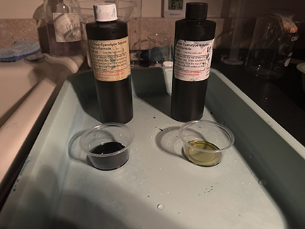

After speaking with B&S, I learned that citric acid had been added to the bulk premixed solution. This destabilizes Ware’s NC and shortens shelf life — citric acid should only be added just before coating.
I ordered a fresh bottle after accidentally leaving my original solution uncapped for several days. Unfortunately, the new shipment leaked in transit. With the new solution, things got much worse:

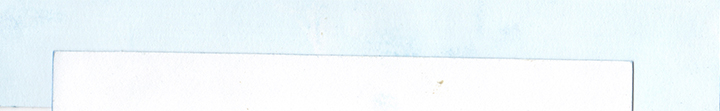

  • Even an unexposed, developed strip turned light blue

I then poured samples of both the old and new solutions into cups to compare color. The difference was obvious — the new solution was significantly darker. The fogging was clearly coming from the solution itself (see photo).

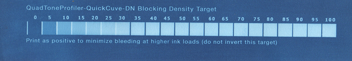

  2. QTR Blocking Density Target — fogged, no whites (new solution)
  3. Unexposed strip, developed — light blue (new solution)
  4. Side-by-side solution color comparison

I notice the one on the left is an actual Stouffer while the other step chart is an inkjet chart. Which printer & inks are you using? Are you sure you have enough UV blocking power for this process? The process likes negatives of 2.2logD or so.

I use an Epson printer myself, but a much older one. However, I don't doubt that the pigment inks in the P700 should achieve the required density as they also do on my old 3880. No worries there; just checking. Still, for testing the process I'd recommend sticking with the Stouffer since we can safely assume it just works.
I can't use the Stouffer to do QTR. I use the Stouffer Step wedge to determine proper base exposure times.
QTR requires you to start with the QTR Blocking target create a correction curve, and edit to get full tonal scale- (hopefully.)
Use the Stouffer to nail down the process without fogging etc. Before that point it's no use to even think about QTR and linearization. First process control, then calibration. You'll drive yourself up the wall if you deviate from that order.
