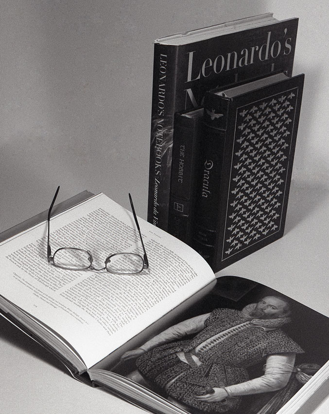

Thanks for the good information. Here is a shot I did last weekend to test 125PX in Microdol 1:3. I would also be curious of what you think of this shot apart from the Microdol question.

stradibarrius, it's difficult to tell how fine the grain is in your image, how about an enlarged section, at the moment there's grain or noise from the scan.

In the background what you are seeing is grain.

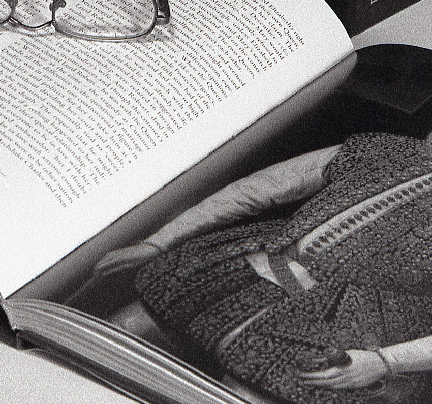

Here is a 100% crop that covers several of the tonal areas.
There appears to be more grain than should be expected with a 125 ISO film and Microdol-X/Perceptol or even ID-11/D76. But it's difficult to say why without seeing the negatives etc. Grain can be caused by a number of things like underexposure, micro reticulation - when temperatures of the various stages aren't closely controlled, this causes grain clumping.
But it might be from your scanning it's impossible to tell. But if the image (Post #6) was 35mm and full frame then there definitely excessive grain for a 100/125 ISO film.
Ian
That shot was actually taken with a Yashica124G 6x6 not 35mm. I have use 125PX many times but have only processed it in Microdol this one time. Every other time it was in D76 1:1 and I have been very pleased with the results.

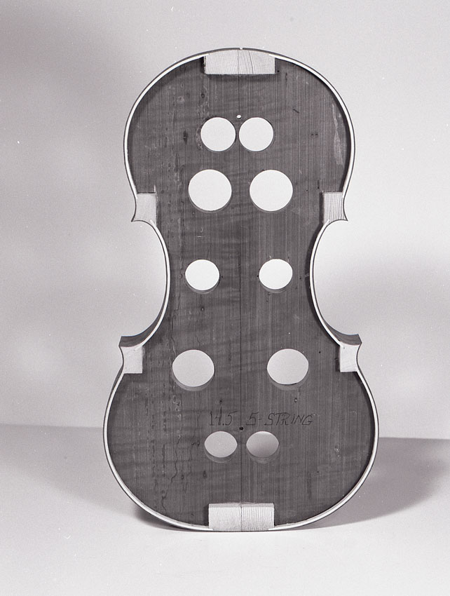

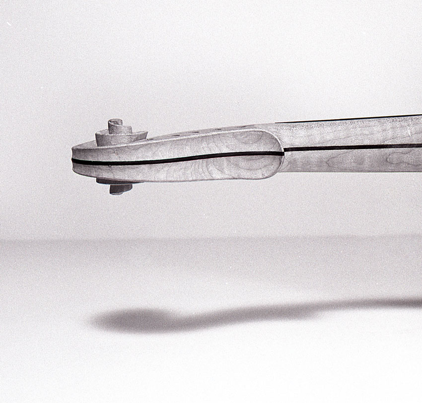

As an example these two shots were taken using the same lighting conditions with the same camera. It is Acros 100 in D76 1:1.
For what it is worth...when I use my digital camera in this same lighting set up I set the white balance to 2850 deg. K to get the correct white balance.

I suspect that the PX Microdol-X combination of film speed and dev time wasn't optimal for the images. It should be far better, but may need some further trials.
If Acros & D76 are giving much better results then there may also be issues of reciprocity or just colour sensitivity. Some films used to have 2 speeds FP4 used to be 125 ASA in Daylight, 80 ASA in Tungsten.
Any film in Microdol-X needs about a stop more exposure than in D76, then perhaps PX needs half a stop more for tungsten, that could cause issues.
