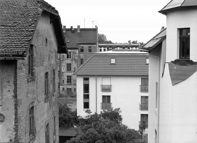

To show something practical from my past testing: Here are four scanned crops from 8x10 inch enlargements from Tmax 400 (unfortunately the old version) negatives that I had processed with different developers. I name them in the second picture with the crops. Three were at stock solution and T-MAX dev was at 1+4.
T-MAX 1+4 dev is actually somewhat closer in grain to Microphen and Negafin than it is to be seen, because I accidentally developed the T-MAX 1+4 negative to a lower contrast than the others which should have made the grain in the T-MAX 1+4 developed negative smaller.
With the new Tmax 400 film the grain would be less but I estimate that the relations between the developers would not change much. The enlarging scanning of prints surely brings sharpness and other problems with it, but I think a tendency can be seen. And for nothing more it is.
