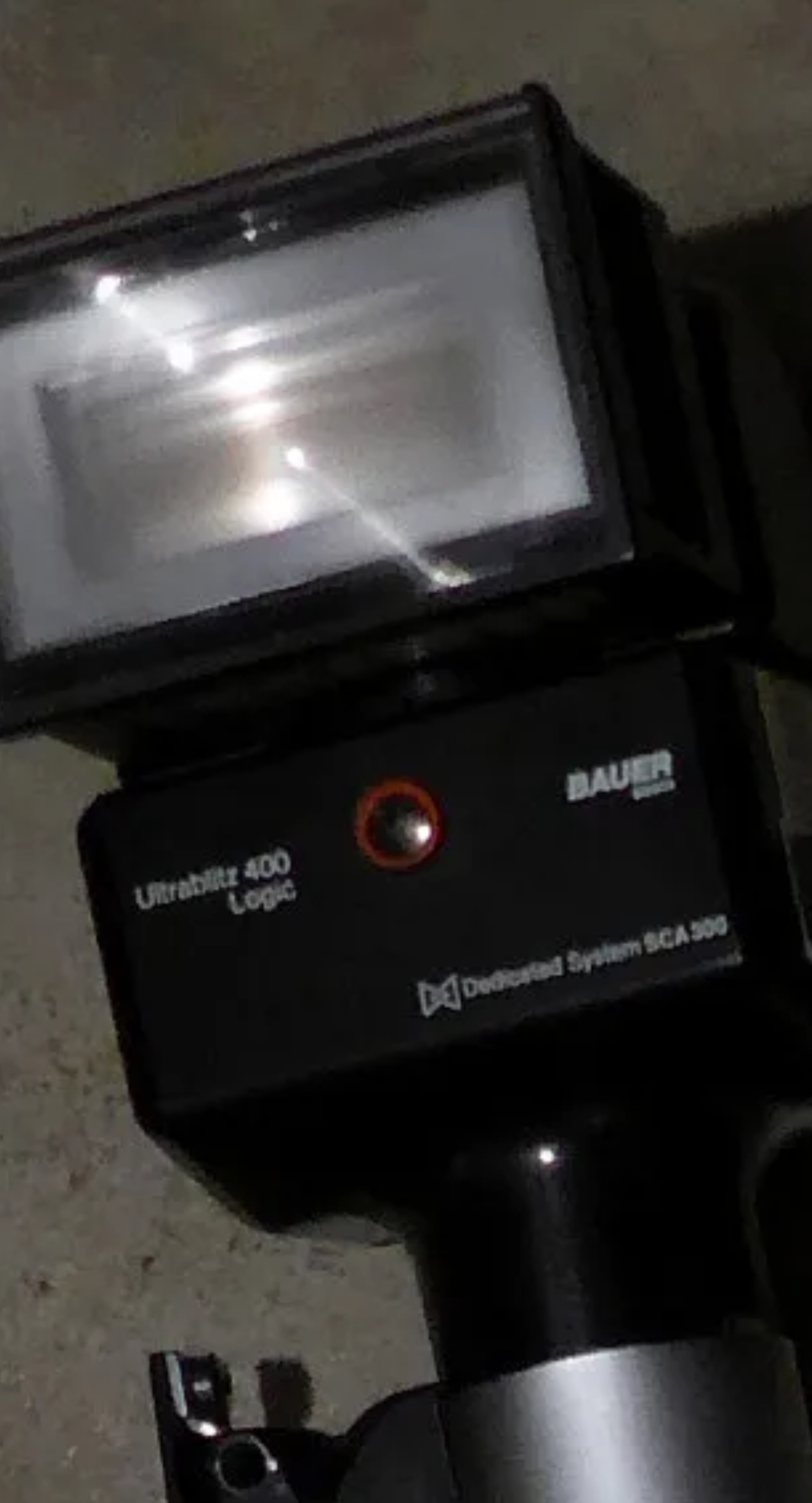

Basically you are right (except that Bauer did not even join that consortium).
They did make SCA flashes though.
This is a Braun flash. The department was sold in 1986 to Robert Bosch Group which also acquired Eugen Bauer AG (in 1936) which existed in the group under the name Robert Bosch Photokino GmbH and the products first were labelled Bosch then Bauer.
