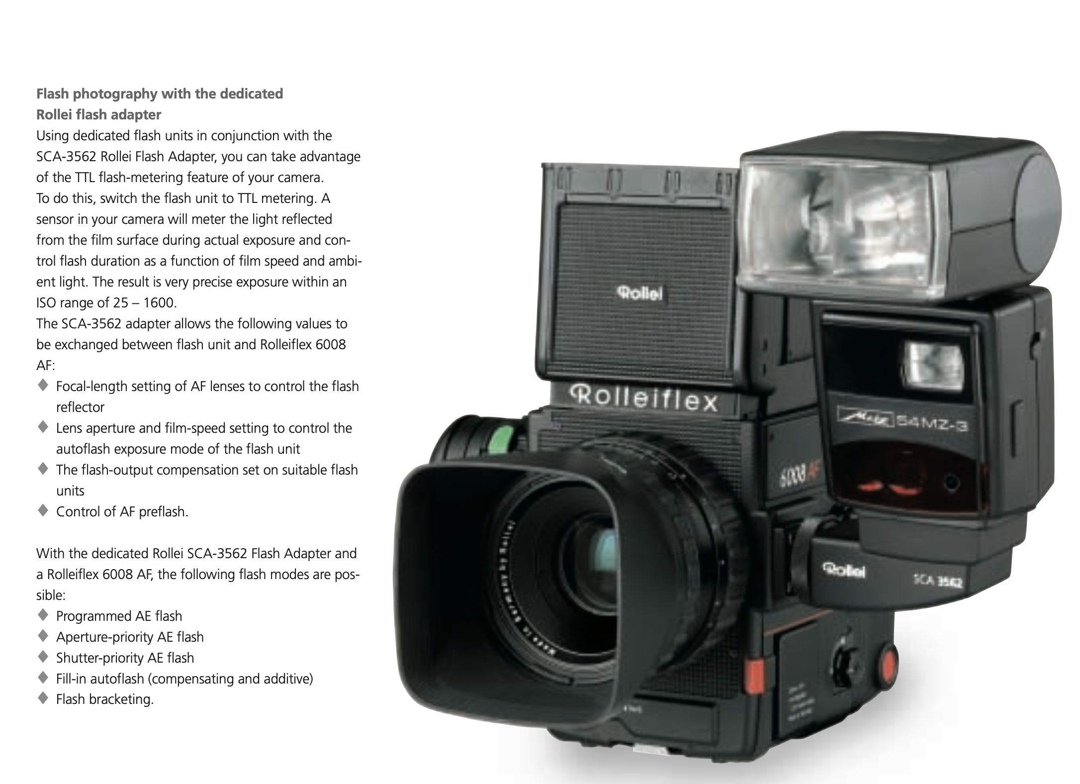

Rollei stopped making their own professional flashes back in the early 1980s and built their TTL camera systems around Metz and SCA adapters.
A few years ago I was able to get a couple nice Metz 54MZ-4 units for my TTL Rolleiflex cameras.
